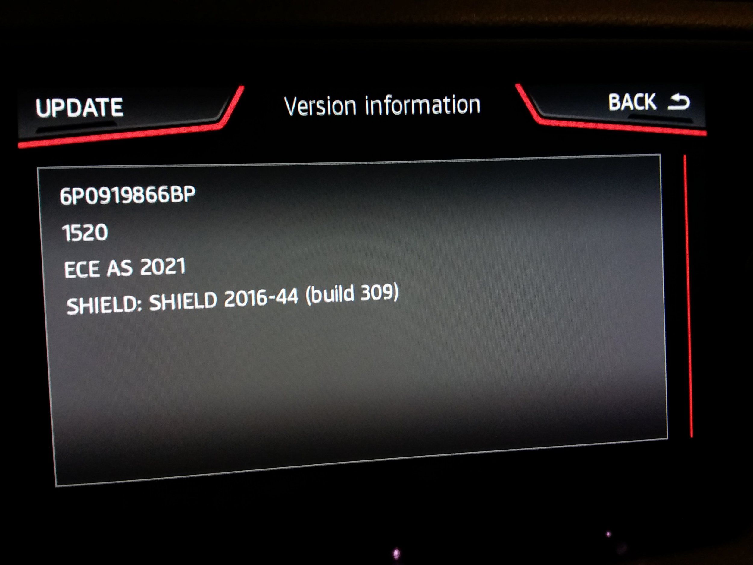

Linked resource gives details on MAC issues etc and how to do it, saves going over it again. Note FEC issues and Mapcare.
Normal success picture:

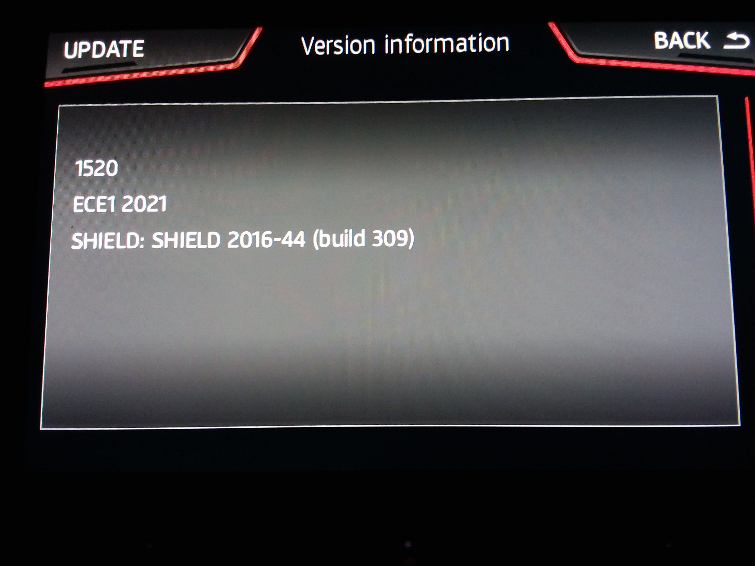

The workaround is in the resources section to the thread to use with Seat units. Note Mac issues as per normal.
DON'T DELETE THE CONTENTS OF THE SD CARD WITHOUT FOLLOWING THE WORKAROUND.

I've had a play with 1520 on my MIB2 Std and all looks ok. Still gets on my tits when I have to recreate half of my Favorites each time I update!

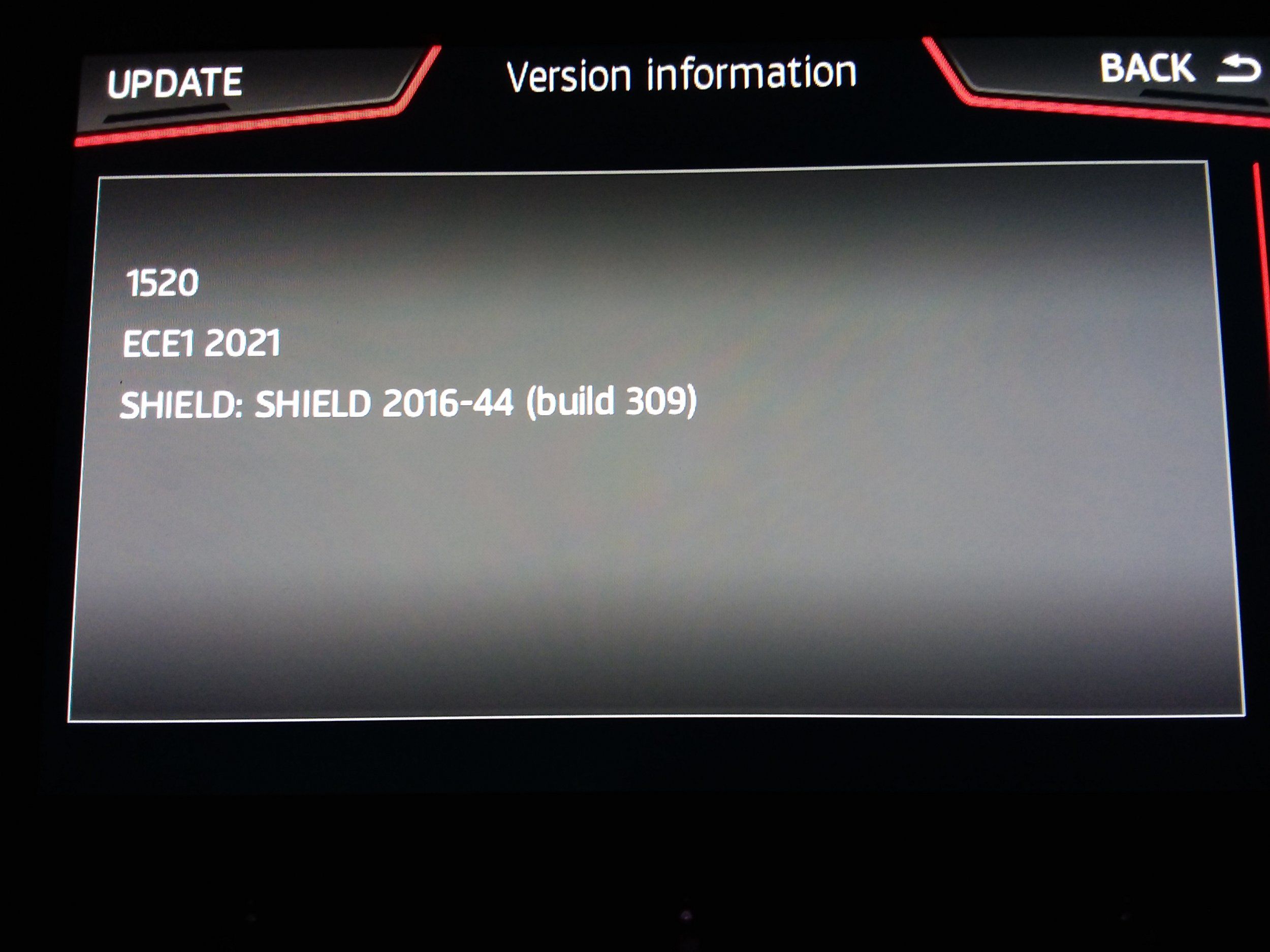

Went out for a drive with it on Friday. Was fine didn't do any motorway driving where all of the standard ones don't tell you 70's the limit. High does. Haven't checked that again. Hoping it reflects the toll bridges changing to free - yet to check. High does since they skipped 6 months.
Favourites, think you might have mentioned before. Destinations and recent are un-effected. Just speed camera databases and other POIs need to be re-ticked to show other than that, the rest is smooth. (Mib2 high it remembers your user POIs that you want to show.)
If yours does something different, may be a variation in the firmware perhaps.

OK the Mib2 Standard November 2020 release for all of Europe has now appeared on Seat servers thanks to the eagle eyes of the Skoda German Community board. Bit of a first for Seat given they always lag behind on. Not wrapped up in a webpage but it's this:
I see it now reflects the toll bridges being free.
Same instructions as before don't delete the contents of the SD card, you need a copy and how to do the workaround is in the resource section:
