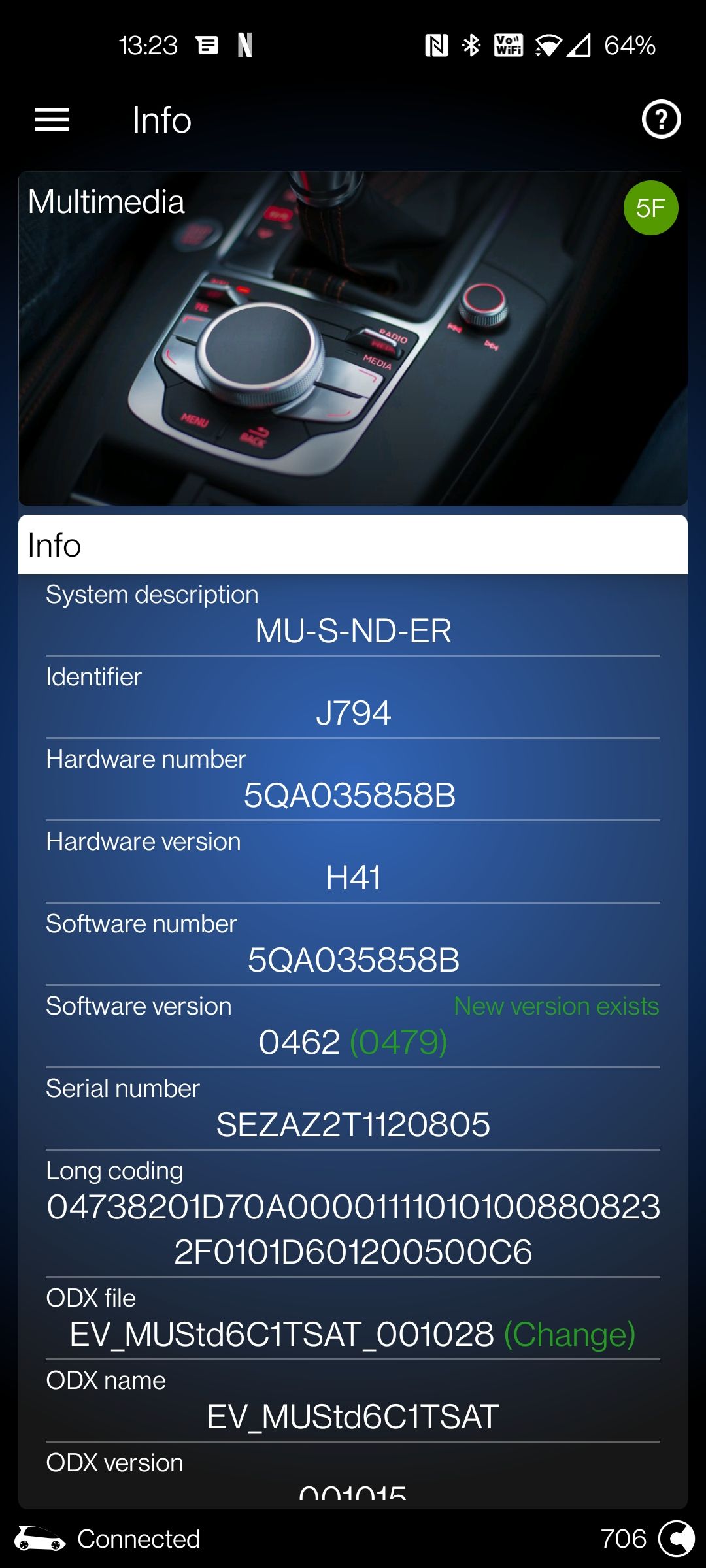

I've been looking at this forum for months but never been able to find a definitive answer about updating the software on my 2017 Leon. My car has hardware version H41 and software version 0462.
OBD11 says there's an update available, 0479 and I see in the Mega link above version 0479 so my question is can I just install that or do I need to install the 2 other updates that are between 0462 and 0479 in order?
Hope that makes sense and someone can help me with this, don't want to go ahead and do it and bork my car!

You can update it, the latest version is 515.
You for Technisat/Preh solution, Firmware, Seat and look what you need 475,479,514,515. There is also the patch solution if you want to unlock your unit.
Sent from my SM-G980F using Tapatalk
Didn't realise I could go from 04xx to 05xx, thought 0479 was as high as I could go on my unit.
What's the patch solution, I don't know anything about that?
