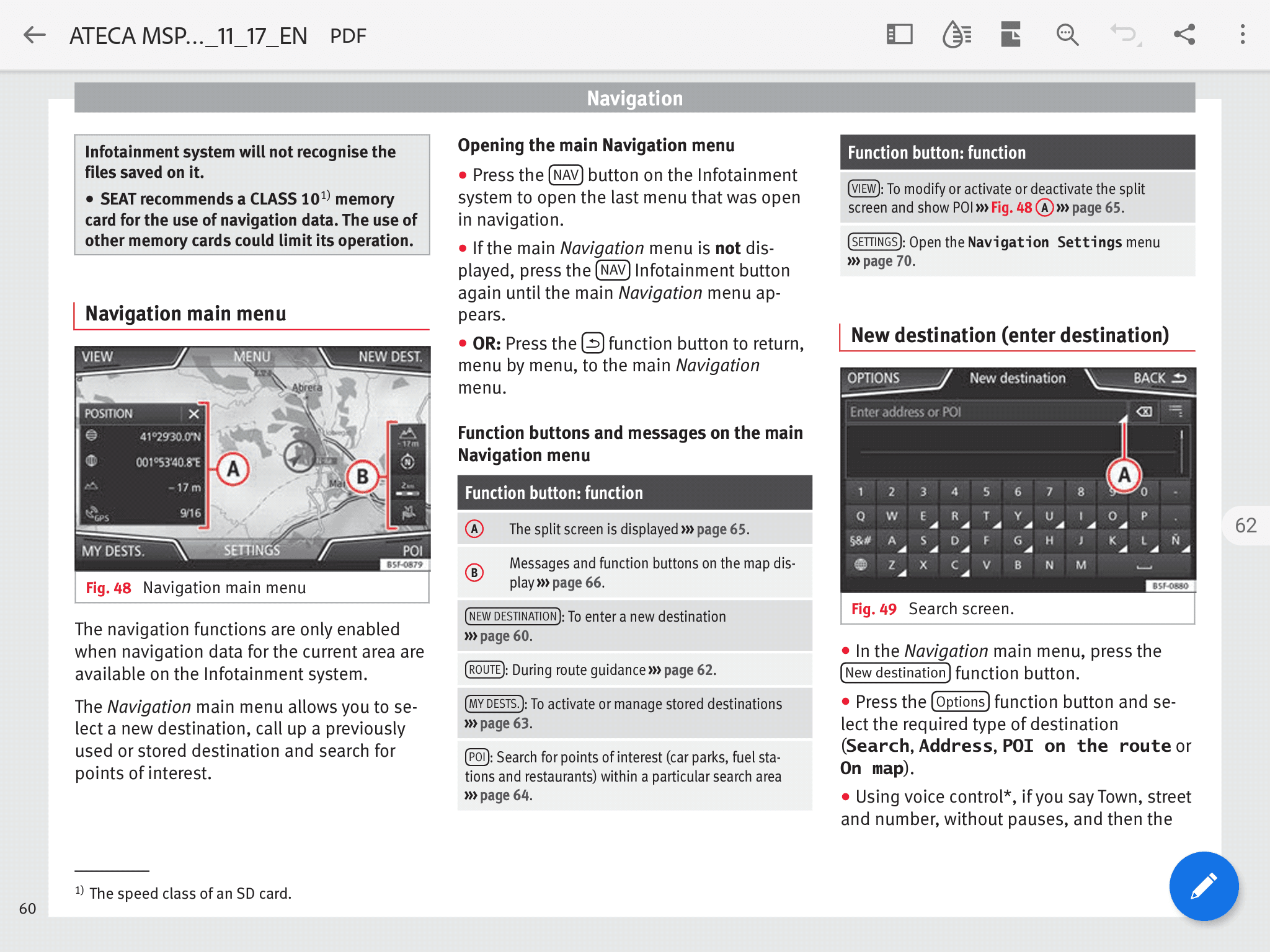

Attached VW document that covers export to SD but obviously doesn't cover Mapcare since they ditched it some years ago.
  • Discover_Pro_June_2020_EN.pdf

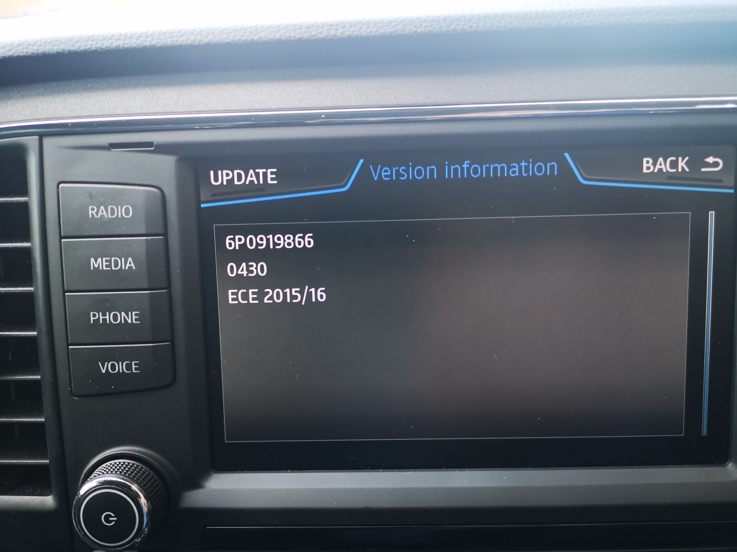

Have tried to do the update on MIB2 unit today but doesn't appear to have actually updated.
Downloaded the update file. Followed the workaround.
Replaced with the original overall file and it gives the following screen when I check version info.
It's probably me being a noob but... Any clues please?
Do I need to have an FeC value update, or have i read correctly that is just for the high units?

It should have done it. It picks up the 6P and the year off the new data on the SD card not off the overall.nds file so I reckon you got the old SD image on the card, not the new one. Could be a noob error ?.
The latest is the November 2020 release for all Europe
1520... you have a choice of links but 1520 is the latest. 7zip if a PC to unzip. Copy out to SD card over right the overall.nds file as per the work around. Reboot the infotainment etc. The long press. Mac follow the Mac instructions.
Reactions: Walone and Red_Fins

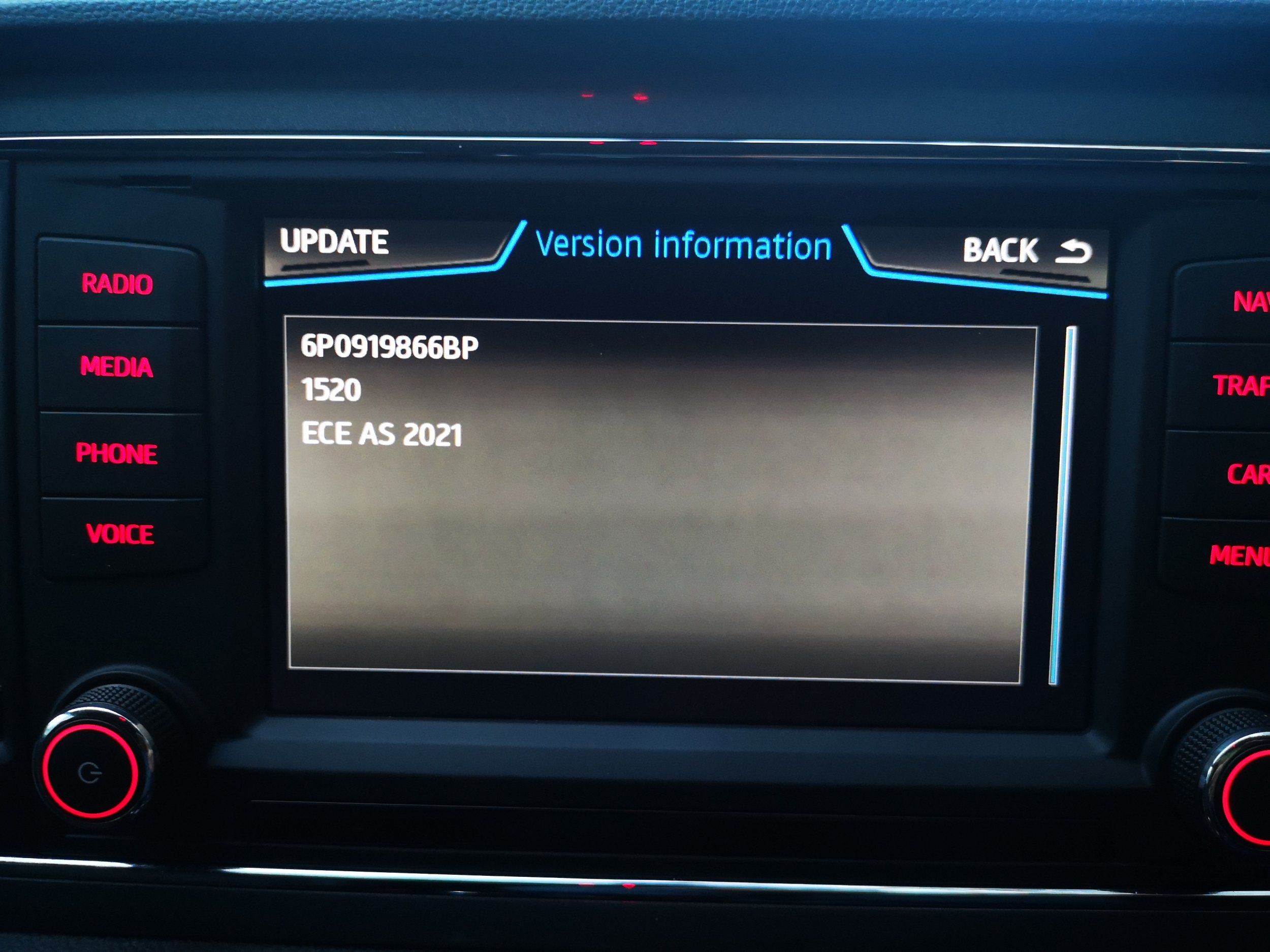

Cheers Tell, appreciate the speedy reply.
Think you may be right. will give it another try and check. Was convinced I'd done it all by the book and might have been soooo keen that I jsut copied the wrong file onto the card - IDIOT!
Have to say though its a great "how to guide" and loads of interesting stuff to read up.
Will provide an update fingers crossed!
Woo Hoo........Its only gone and worked!
Many thanks Tell, I can only think that I downloaded a map update from in the discussion rather than the latest one in the resources and although I followed the process correctly, it was with the wrong update so I ended up working with identical files (the udpate and my original) without realising it - DOH!
However I am one extremely happy bunny!:D

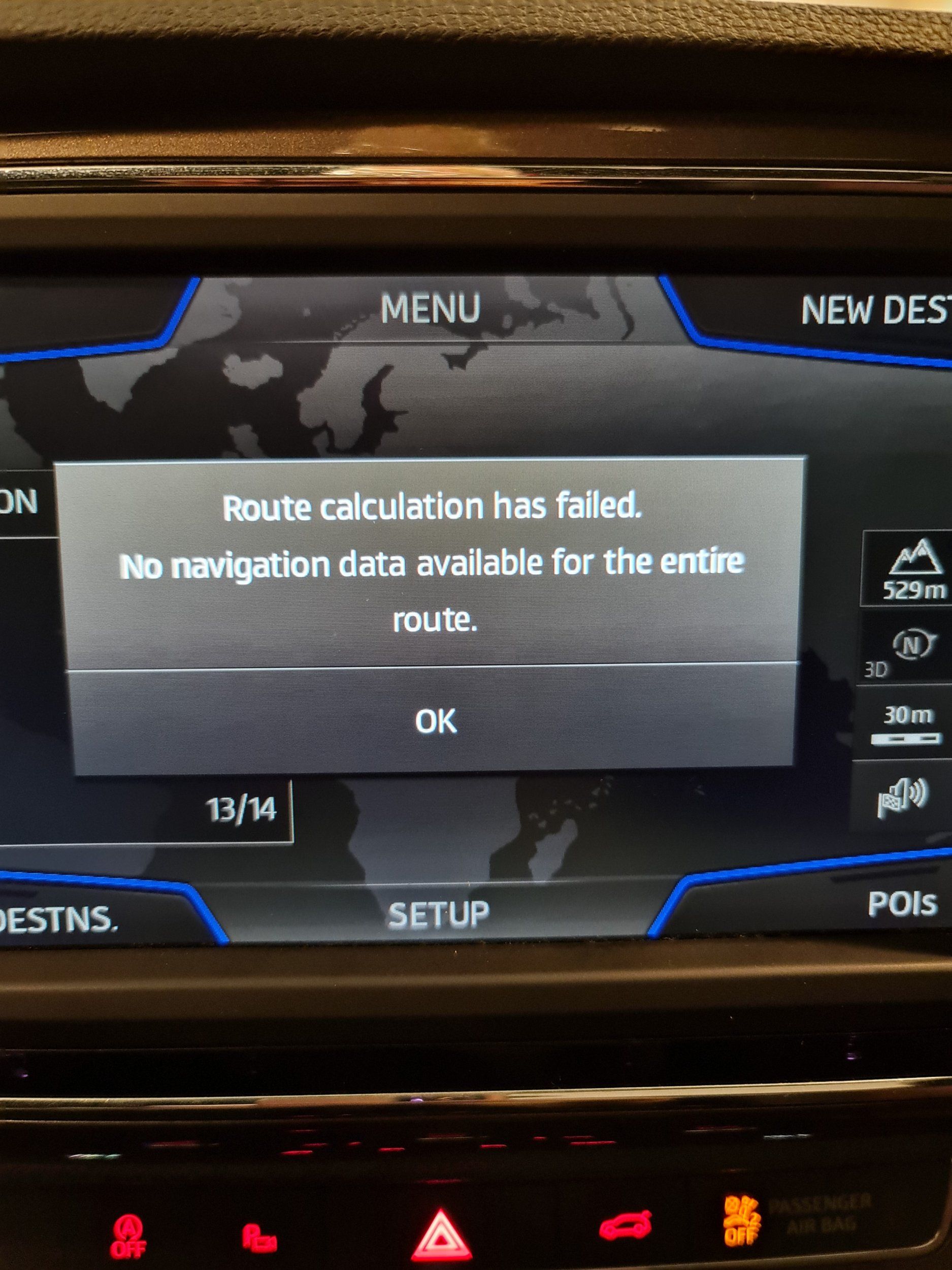

Dear friends
Thanks for this post, i followed the instructions and updated the maps from Europe to Palestine using your trike, however, the navigation worked and i see the roads and POIs, but the most important thing is missing which is starting a route, choosing a destination and starting it is not working at all.
A message appears says:
" Route calculation has failed.
No navigation data available for the entire route."
I attached a picture for the message appears.
This shows whatever destination chosen.
Any help please?

I suspect that the map only covers formal Israel. You could try setting up the starting point and finishing points in Israel using the navigation test mode
A simulated drive can be taken by using the advanced menu of the infotainment unit. Put the unit into demo mode. Enter the cars location by street address, then navigate a route. 《《
I did do this test with roads in Morrocco. It may be that the destination. routing part of the system is only implemented on the U.N. recognised borders. You may be seeing roads that aren't strictly in the destination system. "Israel" is marked up as partial on the map release - see atrached.
There are people that use this download out there since I helped one guy from Israel to get it up on their system on a Cupra Ateca (map cards aren't supplied by Vag they imported a European card and uploaded to that, no mod since it had never been paired with a card). The Palestinian person who did the same as you with a European used import already paired for European maps, not sure where they live, but did the more extensive mod to get it working (they developed it further from the T6 Transporter site changing many more NDS files which is required for newer infotainment units, Arona 2019 works fine with the original T6 method and the Seat NDS workaround). Both methods are shown in the resource. That method was also required for VW US cars imported into Europe.
You could also test with the AmiGo online system which uses TomTom sourced maps the same as the VAG system as I understand. You might get similar results.
Ps presume it is locking on to the satellites. There is a menu which tells you the number, Toggle to show. 10 is good. 35 or so on the newer infotainment systems which use US, Chinease and Russian satellites. Been on roads in Jordan close to the Syrian border where jamming technology was used, had turn round and come back before getting lost. Syrians to confuse.

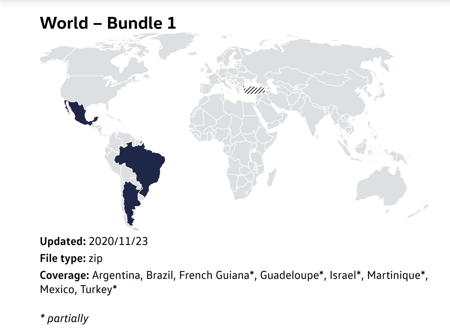

Was this a brand new car shipped to the Middle East ?. Its where the car has been matched to the European map that you follow the resource link. If the car has never been matched to a card you can just put in the card with the Middle East Israel map on it and it takes it. T6 Forum method is used where you are using the car out of region where it has already been registered to the original card. Israeli guy had a car with no map card, never registered and just used the European card with the Israel map on it.
Either way you are seeing a map which means you aren't blocked out of navigation feels like it isn't matching the location to find a route which means you are right off piste. It can happen. Once close enough to a digitised route you would think you would be fine unless as said the sat nav signal is being jammed. It does happen in the Middle East as I said. You can toggle the start up menu to show number of satellites locked on to. I'd do that as a check and also test the navigation demo mode. That runs the navigation from a pre defined point to a destination you enter - instructions as above.
The number of satellites locked on is shown on panel A attached. As I said 10 or above is a good number.
