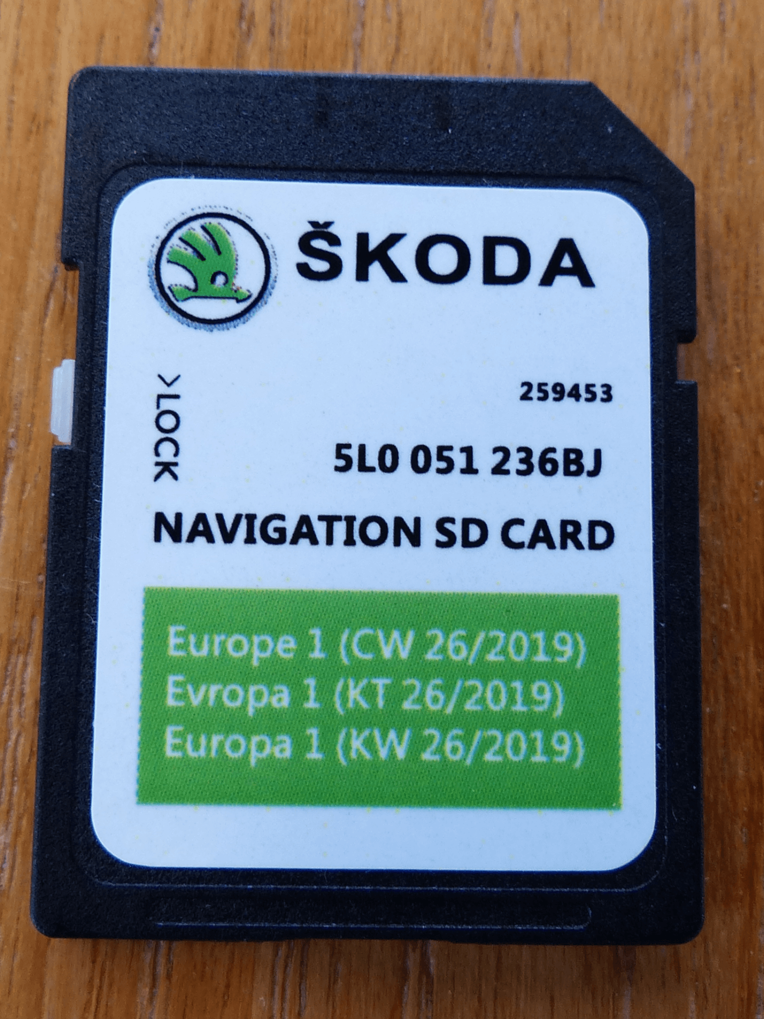

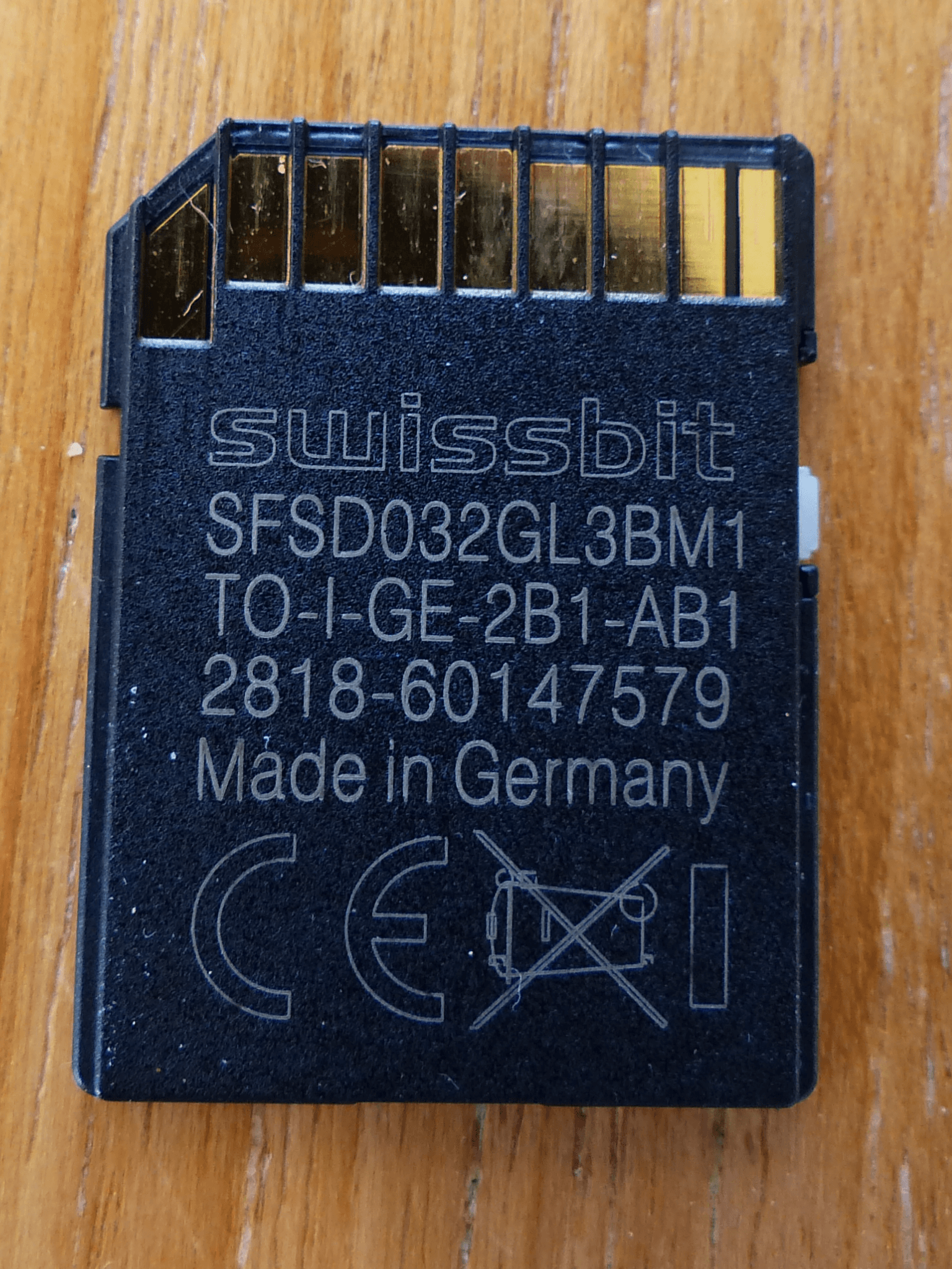

If it's a genuine Skoda 32GB it will. Mine was made in Germany but I did import it before Brexit and the caper that would exist now on imports.
Was sold as 32GB Version 2020 Skoda Gen 2 MIB2 (Amundsen 2) Card Sat Nav SD Navigation Map UK. £39 at the time, postage free February 2020. It had an item number 143469631943. It's the part number 5L0 051 236BG. That specifies it. I see there are a couple on Amazon.
Reckon BR is six months on from BG.
Reading around I see people were flogging cloned cards, the Evo one. I did a post at the start of last year on making your own. In the thread. It's what Stefan the author of the work around did but didn't provide the details too well of how. Much easier to buy a Skoda one. The Samsung Evo card I had to import in as well. Only a specific manufacturing run allowed you to do that. Need Linux and the SD writer plugged directly into the motherboard.
Here's the genuine thing.

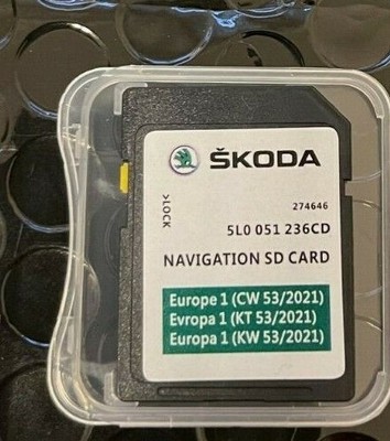

I don’t think the cards from these Uk sellers are genuine, the fact they can make a 32gb for me on demand implies they are clones.
This is the one of the items I’ve heard back from the seller and he states he can make a working 32gb card no problem, just buy the card in the link and then send him a message and he sends you 32gb card.

I did wonder whether Skoda cards were like the Evo cards. Pass on that. It's the memory where the CID is stored has to be rewritable. I did Google the Swissbit on the back of the card once....
The genuine cards are 5L0 051 236BG which is what mine is Europe 1 CW 26 2019 (later is what is on it, BG denotes the card size). 5L0 051 236BR CW45 2020.
The Swissbit manufactured cards were the ones that the German Skoda forum were getting last year, commenting on they were good, Made in Germany, BG release.
The other way if driving across Europe is to buy two 16gb cards and just swap yourself when crossing into the other area. Put the latest release for the boundary of interest. Destinations and user POIs are held in the unit, not the card.

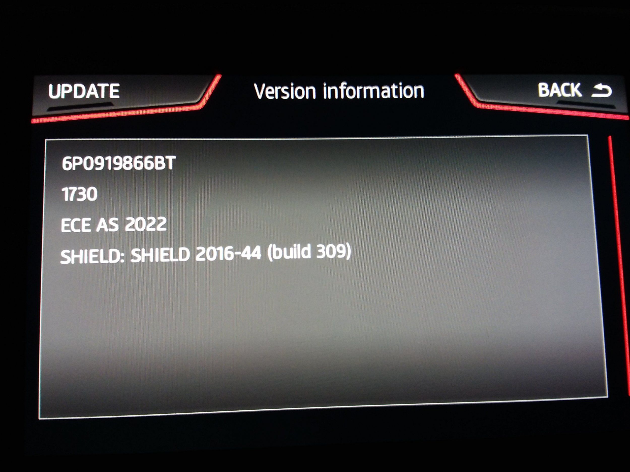

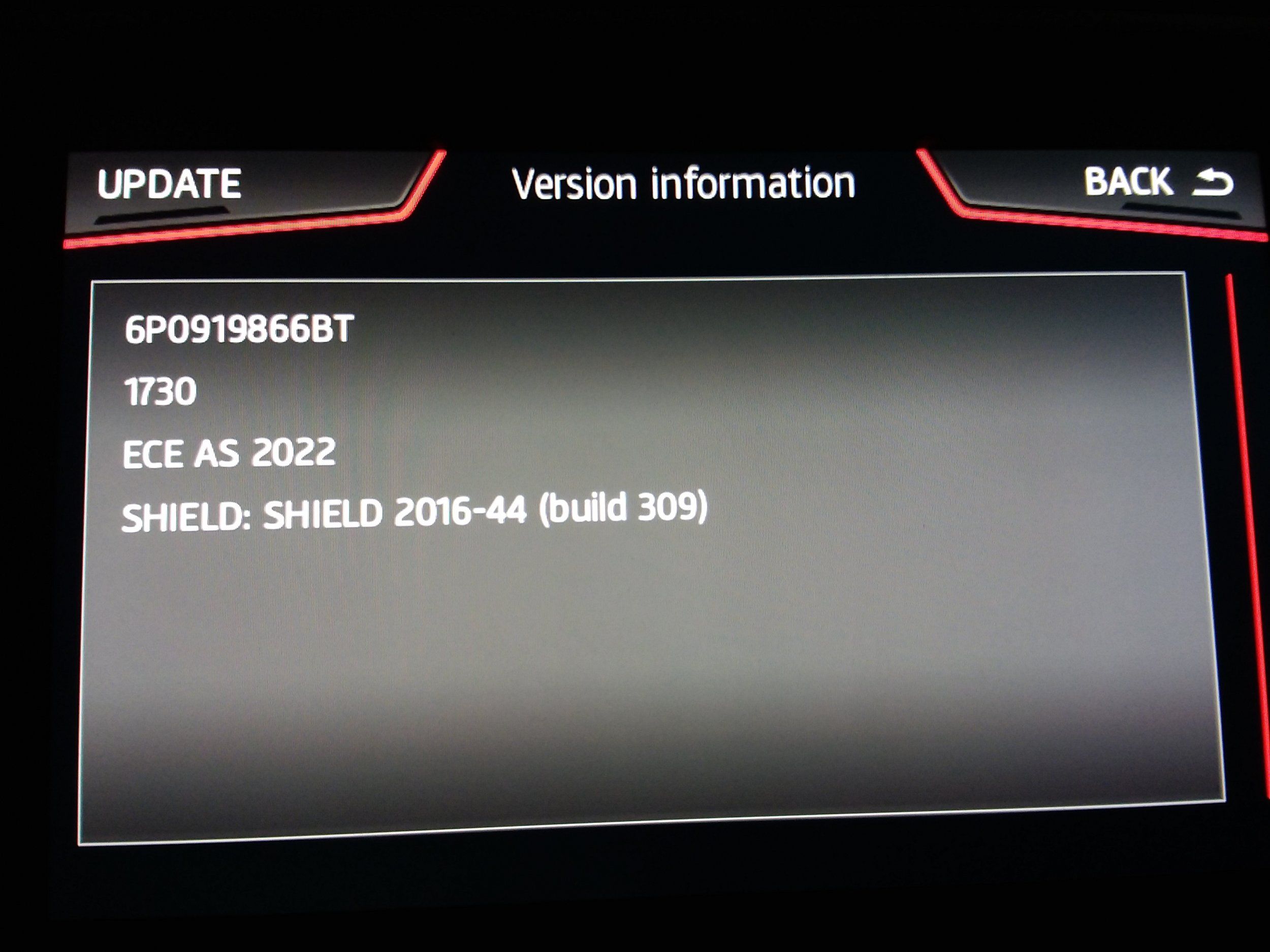

Normal success picture using the Seat download:
DON'T delete the SD card until you have taken a copy.
DON'T bother if you haven't got a 32GB VAG Map card the all Europe map won't fit. That day of reckoning for the all European map to fit on a 16gb card has occurred.
You need the workaround see the Overview tab at the top if not familiar with the process. (credit the workaround to Stefan). The overall.nds trick.
Just buy the Skoda 32gb map card to get all of Europe on it or just wait till a smaller zone is released.
I've used a 32 GB Skoda map card. Just buy the cheapest from your favourite E store. Mine is a 2019...
(the Seat European image takes up 16,523,067 and fiddling with the allocation unit size didn't help on the Seat 16gb card, still didn't fit with 4096 allocation size, has to be Fat 32 in anycase)
