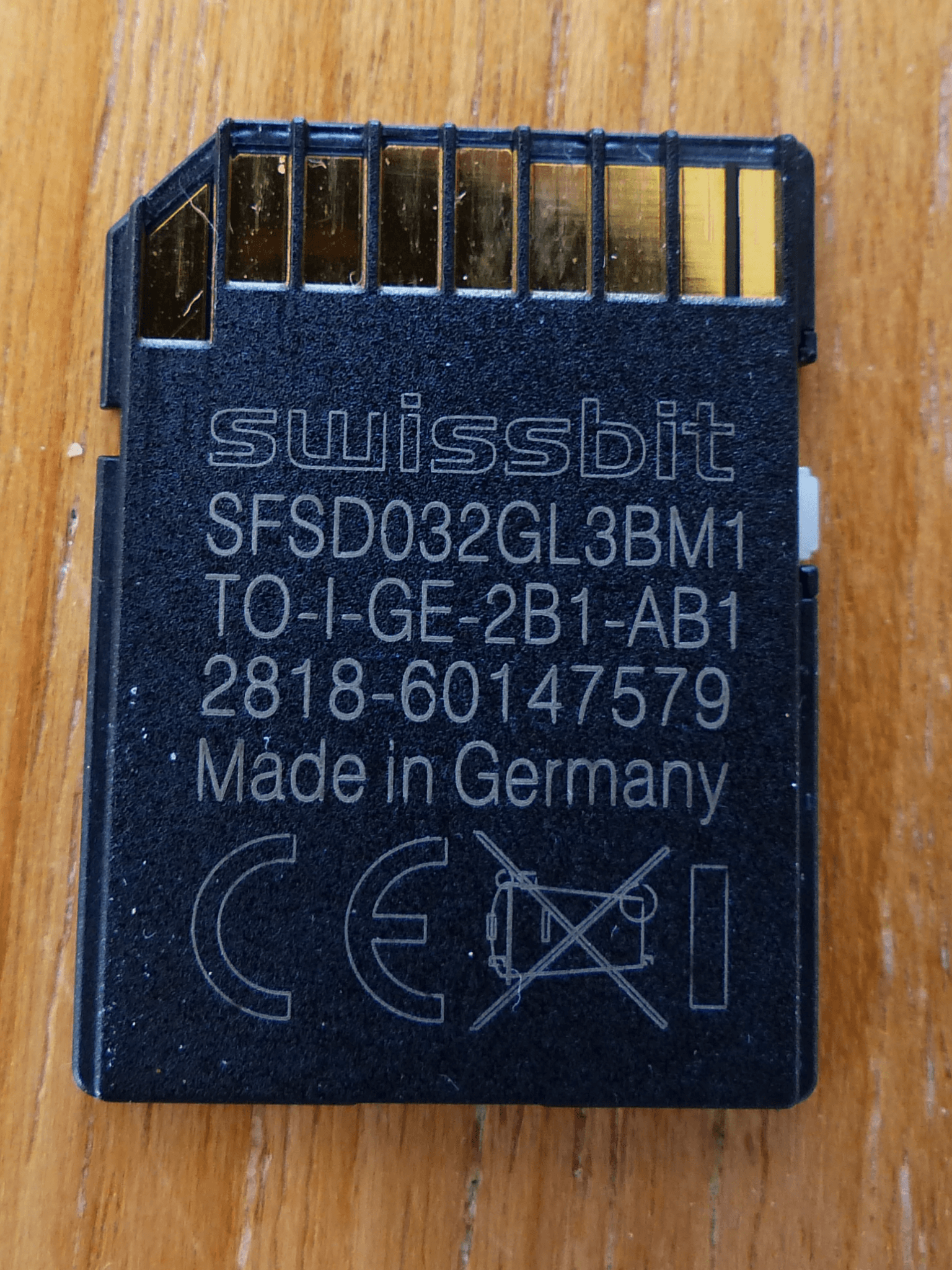

32 GB does the back look like this. That's the back of my Skoda card from last year. They were using Swissbit SD cards then.
screenshot_20210525-181529-png.25037
Not like that, branded ATP, made in Taiwan, seems pretty generic.
Ah well worth asking. Normally those cards have a write once CID so that's configured as one of the VAG, probably some Hex check on it since they are different but interchangeable between VAG. I know the Seat one is different from the Skoda one by that Richard Burton software I used to read the two cards.
Perhaps they got a better deal from them this year than Swissbit ?. Seat have used ATP in the past.
Seat and VW use currently ATP (made in Taiwan) I updated both cars and both was made by ATP.
Picture shows 16GB version but 32GB looks the same. Different are only model type.

I suppose we are now left thinking whether last year's Skoda 32gb was genuine ?. Safety in numbers, the 32gb Skoda one was made by Swissbit least the same as the German Skoda board that look solice in that they were made in Germany. Mine came from a UK address.

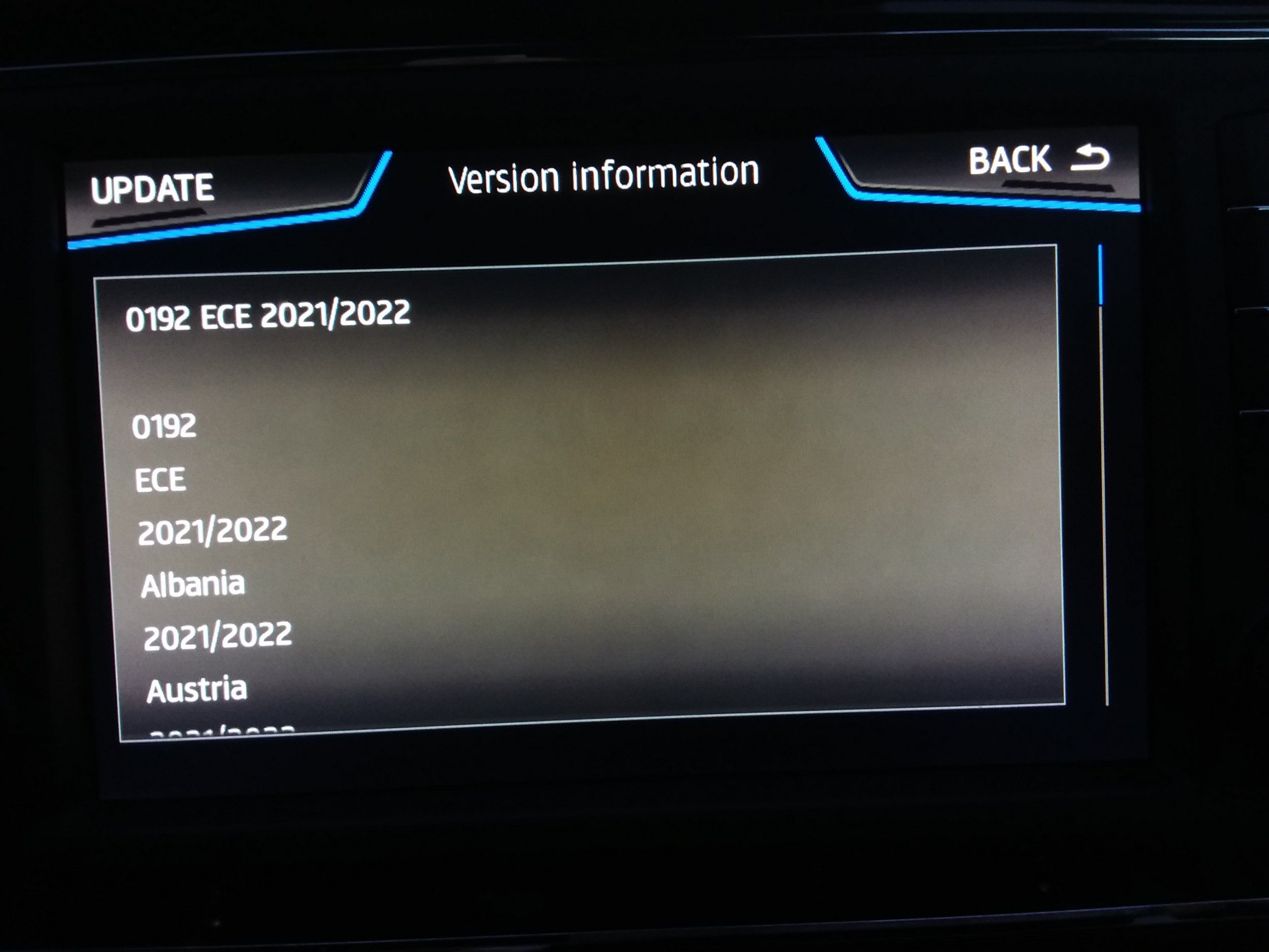

Oh look I have map release 192 installed on my mid2 high. Needs the Skoda navigation lifetime FeC added to your list (08300008).

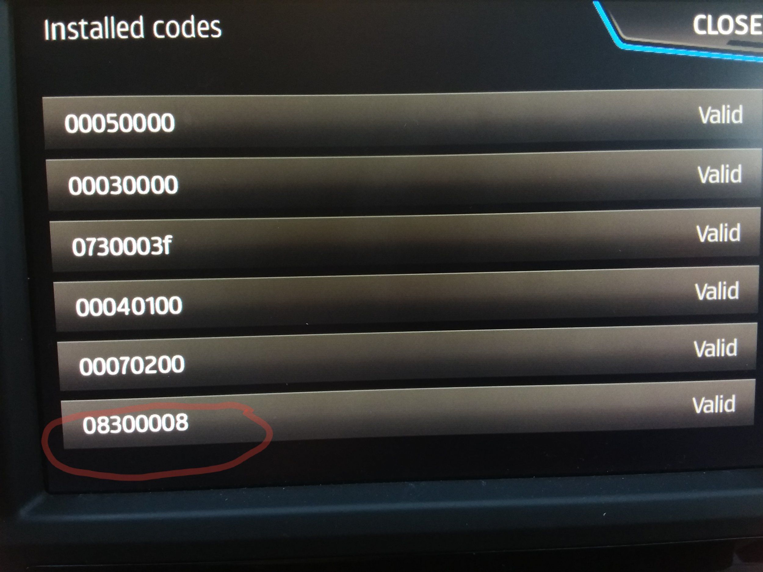

Obtaining Lifelong FeC for 192 release
About the 1447 software, I never did it and you need to check whether you can move off what you are on directly to it. But the link does cover downloading Mib Tools if not upgrading the firmware, just patching for FeCs (just need point 0, 5 & 6 from that):
Then you need a friendly person from the M.I.B. collective if you are keeping your firmware and they dont have that in the database of patches to make you a dummy patch. I had @jpmedia.
Having put the returned dummy patch onto the SD card under the patch directory, you just tap add FeC, don't install the patch it's a dummy one (the Skoda navigation FeC will be added to the FeC list supplied) (note a long on / off press to get the unit to reboot to read the changed FeCs):
& all is good ?. Possibly not for the faint hearted. No animals were maimed or killed in the process ?.

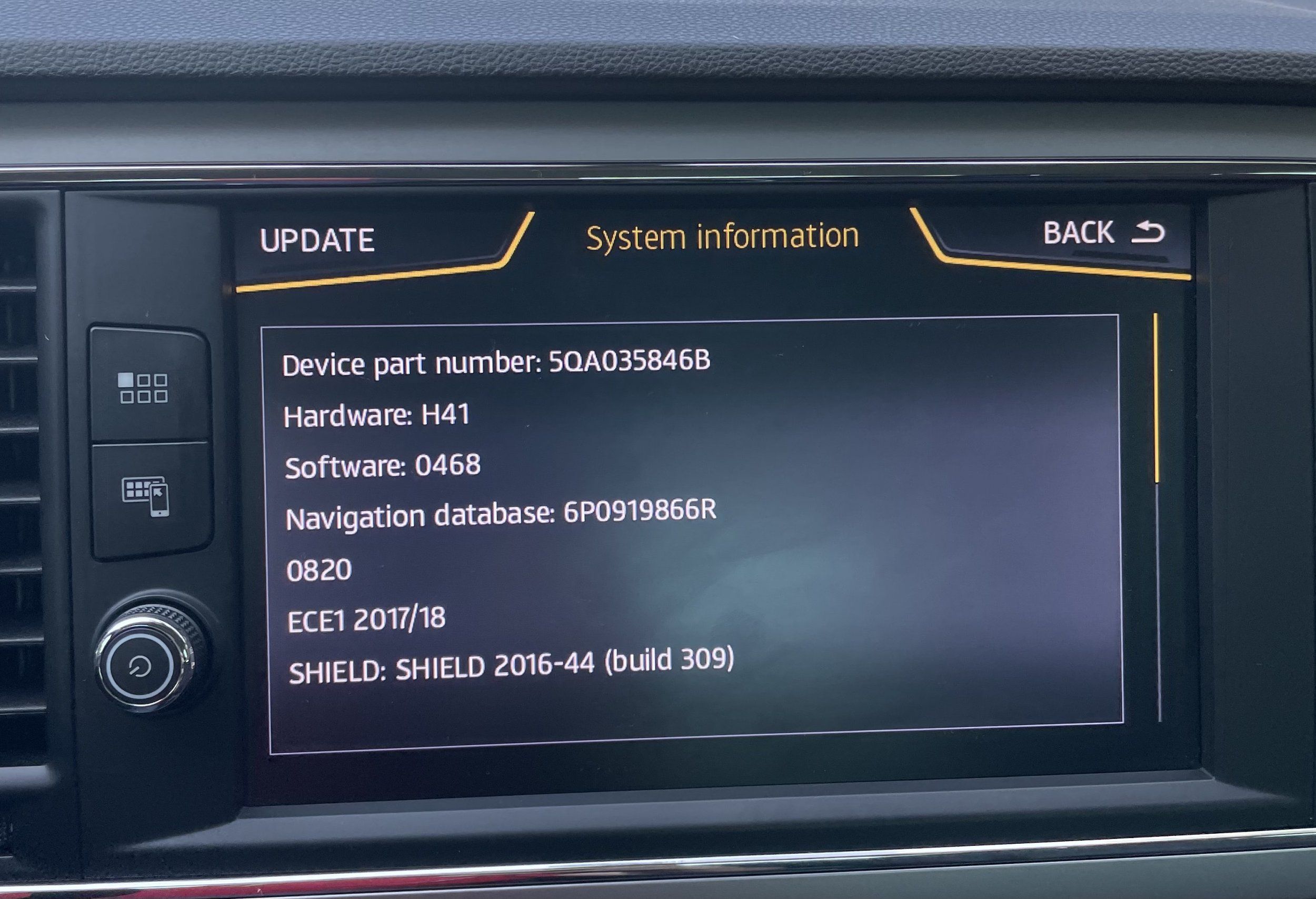

Hello all,
I need a little help pls, I have seat leon 2017, bought in march 2018, Iam going on vacation next week and I want to update the maps also you can see the system information on the picture I attached.
Also I dont know which MIB I own, I want to know just in case, I see a lot of discussions about that, It is MIB1 or 2?
Iam little confused because SEAT updated the web and only there is guide for cars from 2018 and onwards. Also there are two types Navi System - 6P0 and Navi System Plus, I guess I got the 6P0 version right?
Thanks in advance.

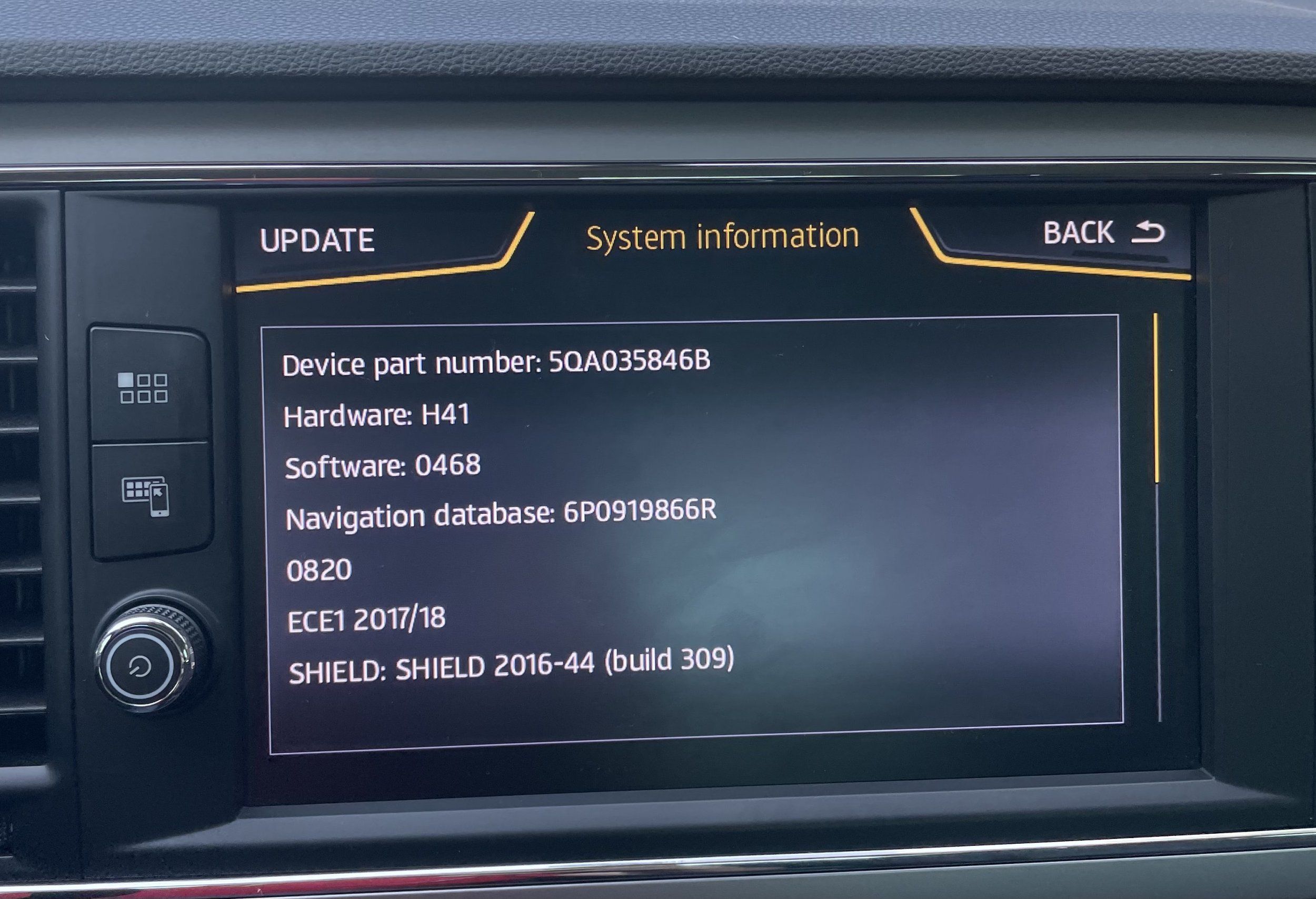

Hello all,View attachment 25896
Thanks in advance.
That is indeed a mib2 standard from the 6p you see under the navigation database.
You follow the workaround instructions in the resource section:
You first take a copy of the card to your PC, if all fails you have a copy. There is one file you need from that see the workaround instructions. Then follow the text from Updating a Standard Mib2.
Current map releases are shown under the section "Current release see".. link below that.
One variation now is that the all release for Europe is greater than the 16gb card. Options
- use one on the zines released
- edit the language files of the all European release (temporary fix till all Europe out grows 16gb even with the mod)
- Buy a 32gb new VAG card
Suspect in the Covid climate nobody apart from lorry drivers are driving across Europe so one of the zoned releases is adequate.
All the current map option downloads are here:
https://www.seatcupra.net/forums/th...b1-card-solution.388586/page-121#post-4971082
If using a Mac you need to follow the Keka / CleanMydrive instruction, PC 7zip.
You must follow the workaround instructions in particular 9. Copying back your existing overall.nds file else it will not work.

thank you very much.
I downloaded all europe maps, and they are more that 16gb, instead deleting the languages, can i delete unnecessary maps?
