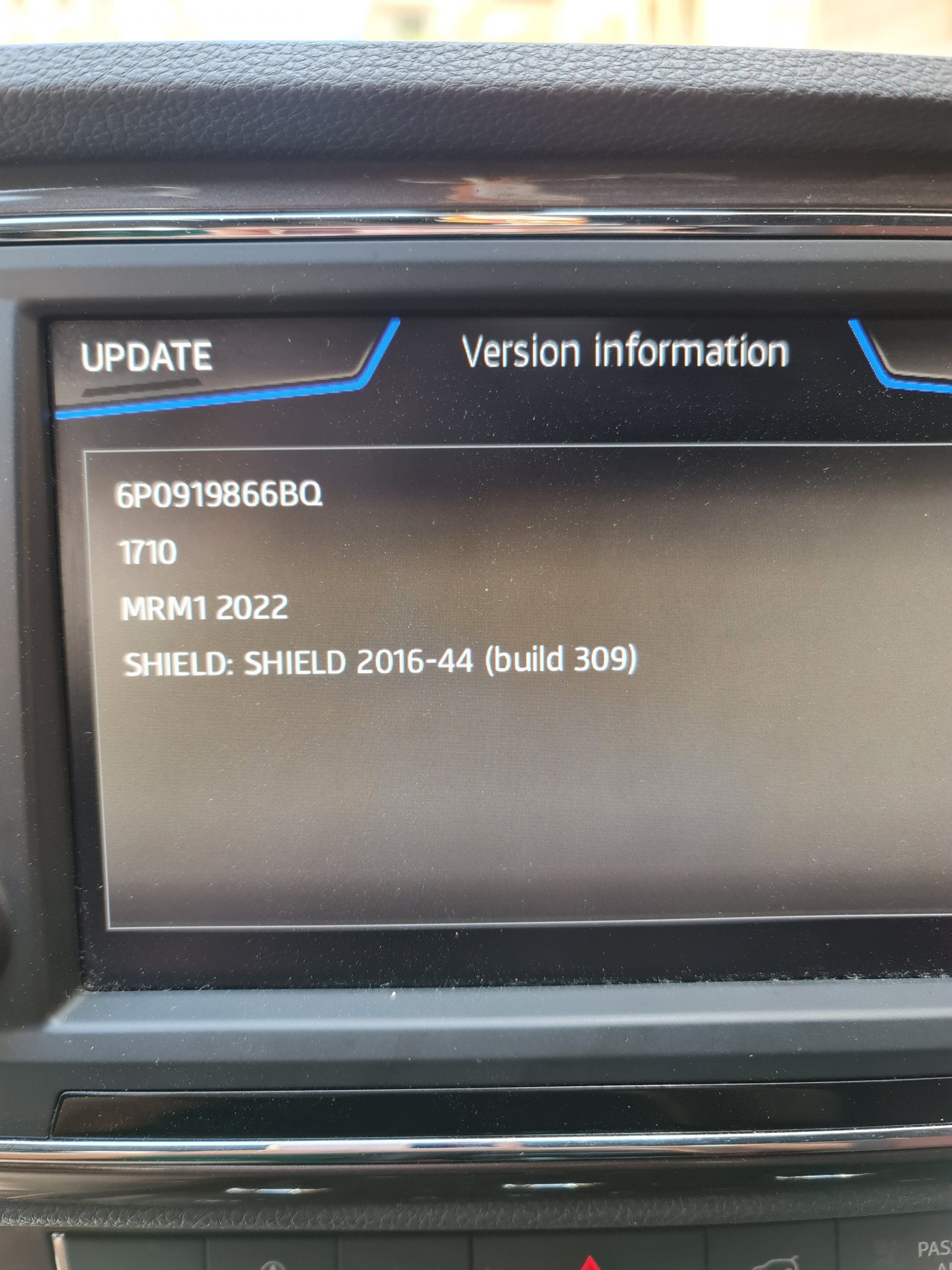

Hi
Sorry i was too busy these days. I installed the new update today. As previous update it was smooth and easy. The only thing i did as the previous one, is i changed the name of Israel folder from 21 to 00 then reinserted the SD and bingo.
Here is the version installed:
I didnt see any changes in this cersion, however, i will check some roads that was not in the maps in prevoius version, if they updated and appears in this version or not.

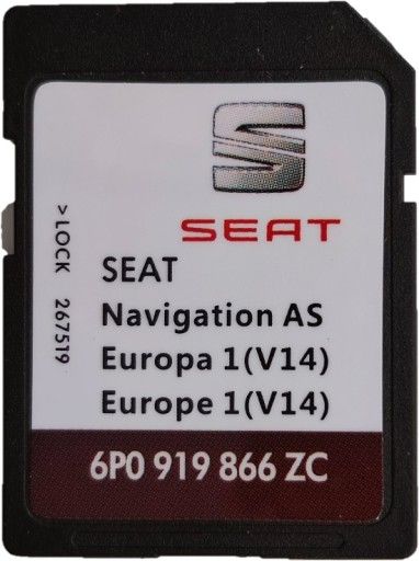

Hello Gents,
I facing same problem as most of us - 16GB orginal navi card and way more data to copy.
I'm leaving in poland and i have three options.
Orginal Seat - 6P0919866ZC
Orginal VW - 5NA919866ZC
Orginal Skoda - 6P0919866ZC
I spoke with Seller and he told me that he checked all three SD cards and on Seat & Skoda SD cards you can't see any files, On VW you can.
All maps are for 2021.
My question is which to chose? As I understood last few pages and description of @Tell it's doesn't matter what is on card, the most important is CID.
Please correct me if I'm wrong:
1. Downloading maps from links on previous pages
2. unpack them
3. From old 16 GB car copy overall.nds and product.nds
4. Delete (format?) new card (for example Seat one), because we will not broke CID
5. Copy new, previosuly unzped maps.
6. Copy overlall.nds and product.nds to folders
7. Should work?

All of the 1730 downloads are the same. Pick the one that's the fasts, Skoda can be slows either VW or Seat.
If you want all of Europe you can delete all the language files except your country (do that on the unzipped copy on your hard drive). That's covered in the resource or if you are happy with a zoned release just use that. Trimming out unwanted language files is only if you fancy driving across Europe which probably isn't any time soon.
That's in this text:
June 2021 the All European map out grew 16GB current short term solution if you require all of Europe on the card:
For GB language across Europe you just need GB and the meta_info.db in the folder:
maps\00\sds
That's a fix till it out grows the card again. Other languages pick your plate and delete the rest except meta_info.db
I would keep clear of that unless you deem the published European zoned aren't workable for you.
On 3. You don't need to copy out the product.nds only just the one overall.nds. It's if you have an export car or import car to the rest of the world or Europe and it isn't a Seat where more bloated instructions are required which are in the resource that pick up other files.

So as i can understand.
1. I can buy Seat 6P0919866ZC which is for sure 32GB.
2. Format it using FAT32.
3. Copy news data from unzipped folder (https://seatmapdownloads.akamaized.net/EUAS/EU_AS_STD_1730.zip)
4. From my 16 GB card copy overall.nds and it will work?
If it's a proper genuine rewritable VAG card. If it was from a dodgy seller the issue would be how good the card was.
Other than that you treat it as the 32gb Skoda card covered in the resource, your steps above. All VAG cards are interchangeable and the cloned CID ones from wobbly sellers should be the same apart from durability.
I did note there are a fare few sellers now listed. You have to judge whether they are selling the real thing. The ones last year were all made in Germany as per the photo of the back above, so I got what German Skoda boards were getting and talking about.
Reactions: Lord_Nikkon
You won't have a problem as long as it's a genuine navigation 32gb card.
At some stage the all European map may out grow the 16gb file with the language fix but may be not in the life of the updates. Depends whether TomTom finds a lot more additional material to put on their maps which are used in the mib2 standard. That slowly increases each year. Zoning Europe was a fix for that which they introduced a few years back. It took a few years extra to break the 16gb download for all Europe, but that deletion of language folders not used gets some extra time.... possibly the fours years that VAG will still release mib2 updates.
This is good question to which future will bring answers. I will check how this card (32GB) will react. According to seller is original. He has really lot of positive comments so i believe that it will be fine. People form polish Ateca and Leon forums are really interested in this my tiny project, which I based on your experience.
For now removing language packs is good workaround but only for now. I compare old and newest package size and the growing around 500MB a year. For me removing all other languages beside polish save around 644MB, so it will be enough place for one more major build. That's why i want to test 32GB card solution. My parents has T-Roc and no AA (they forgot to chose it) and current maps are pretty crucial for them,

Hi guys,
My new 32GB SD card came and SD marked as 6P0919866ZC has map version 1610. Worked since first moment and i used it as my new "overall.NDS" source.
I noticed that all new cards for Seat & Skoda don't have MBR so when you will connect them to PC DO NOT FORMAT THEM!!! Older or more advanced users know very well hopw to fix MBR for FAT32 directly from CMD. For those who are not fell to well in command line, you can download free MiniTool Partition Wizard, put SD to reader, select in software memory card, right click, "Check File System", Check & fix detected errors". After few second you will see files on SD card. This fix will not interrupt and functionality of Navi and will not corrupt data.
Next you just need to follow great instruction of @Tell
My memory card cost me 169zł in Poland which is around 38euro. I had shipment for free. My seller also can ship cards anywhere in EU for around 5euro.
Reactions: Walone and Tell

Second hand items always bring risk. My card was original for sure or it's amazing copy with CID made in correct place.
Thew most important it's working and i will jump to parents car (VW) and made the same. I cna always use AA but parent don't and better for everyone if my mom will not lost here way :p
