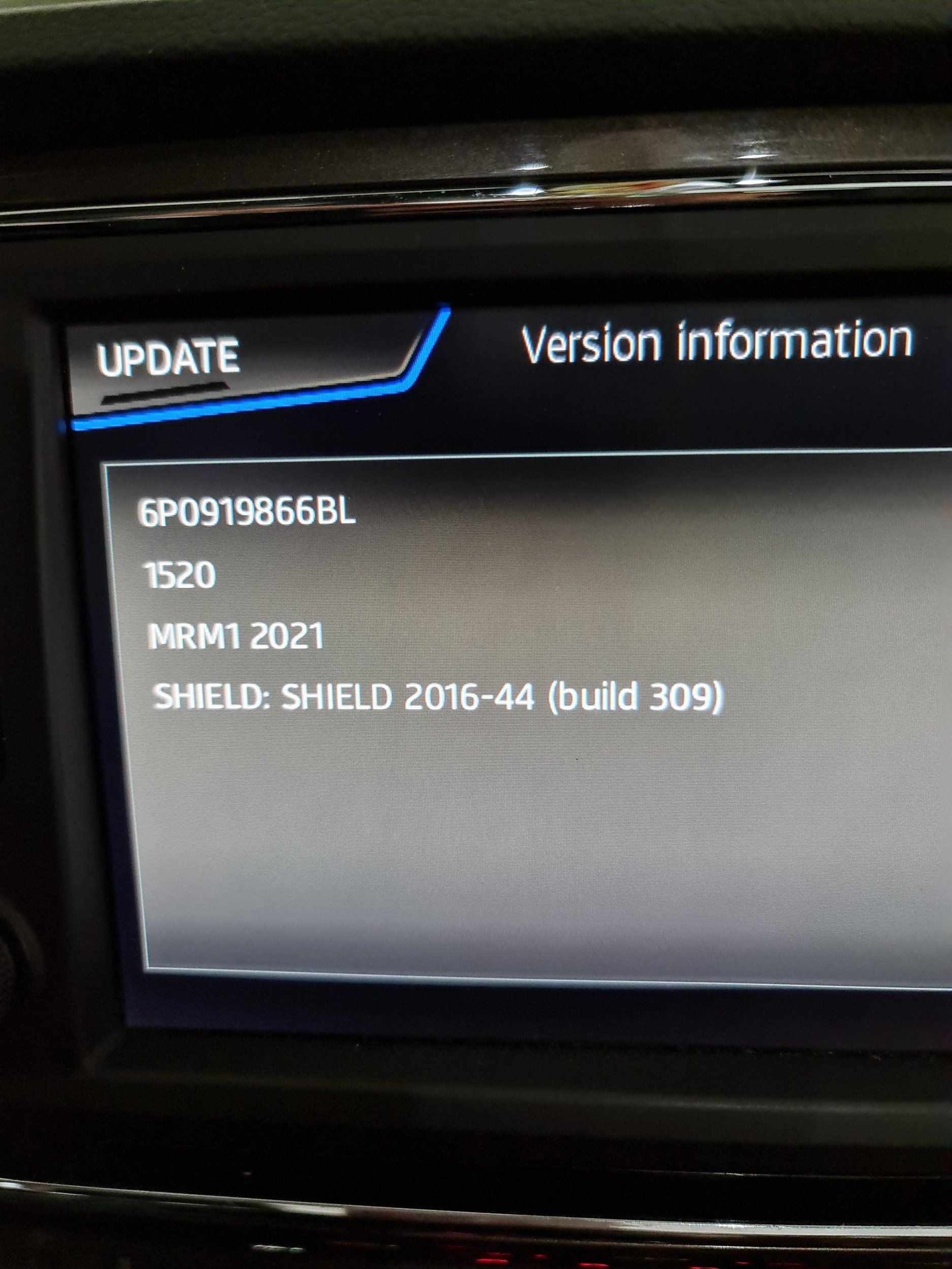

What do you think?
What do you think?
Suppose to mean it's good with the June 2018 release. May be switching regions has confused it. You might be allowed just the one you did then after that the simple overall.nds workaround.
0740000EDB_EU_MIB_STD_GEN2_SEAT_22_18
That's normally how navigation FeCs work reading off on the standard table shown above. You did select a destination and start off navigation. On a high unit with an out of period map in it, it locks navigation in 30 seconds.

I'm not sure if i understand you well, as I'm not experienced vey well.
What do you mean by 2018 release?
I will wait to the next update then do the same workaround, if it didn't work i will try the overall.nds
See the attached picture please
Exactly. I'm surprised it bypassed Mapcare but will probably get you on the next update. So that NDS file of the simple workaround on your working card now will be the one to use if that's the case. Copy the card out at the time of doing the next update just in case. Normally on the standard system it just tells you, you dont have a valid card or words to that effect so you will know.

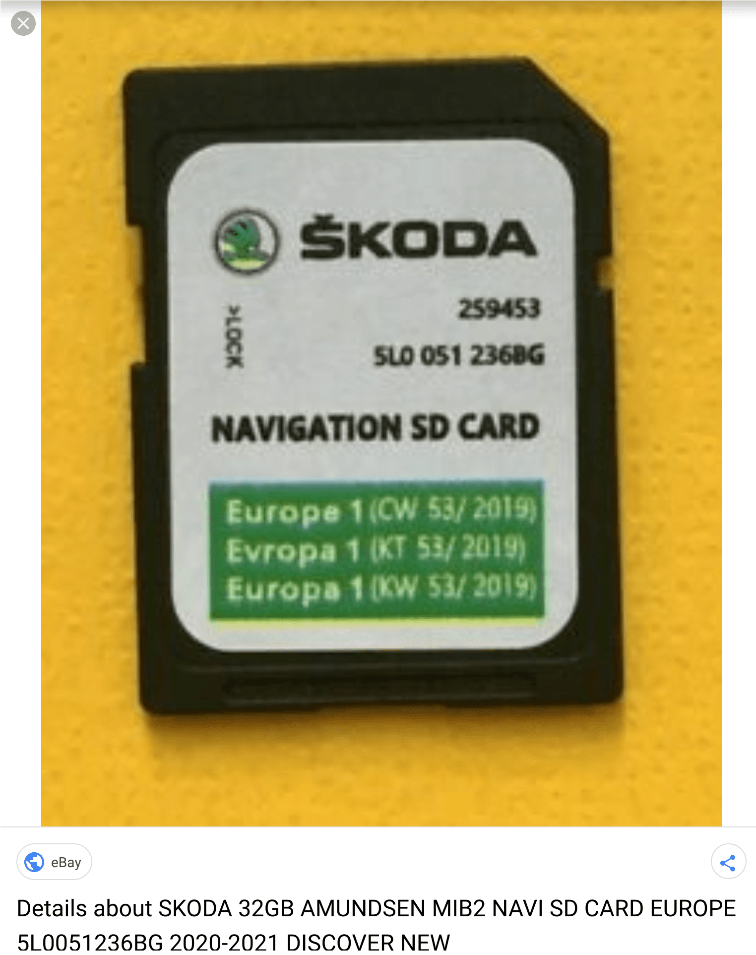

On the 32gb sdcard topic, the only ones on eBay that are advertised as genuine Skoda 32gb ones are either located in Latvia or Lithuania it seems.
There are a number of UK sellers selling Skoda map cards, no idea if genuine, but don’t list size of the card.
I’ve emailed a number of these and double checked and they are generally selling 16gb cards.
A couple of them have said they can do 32gb on request however.
Ive no idea if these would work though , I’ve contacted those that can do a 32gb card and asked if it will work the same as a genuine 32gb VAG card (eg have the required CID). Waiting to hear back.
