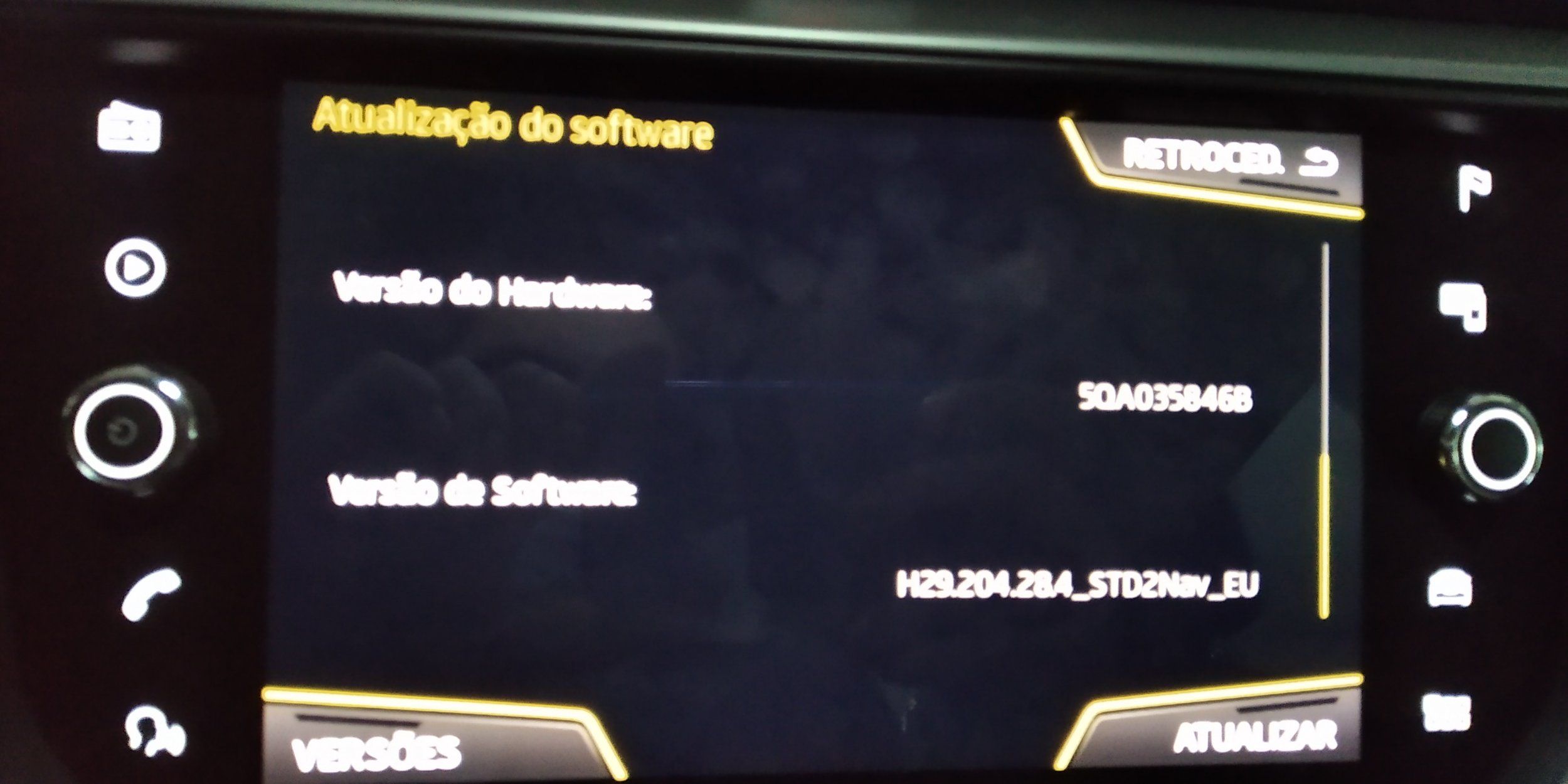

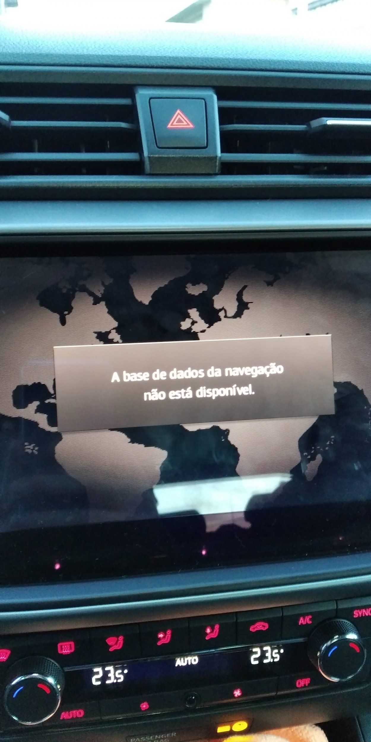

i have a seat ibiza from 2017 and i decided to update my gps. I downloaded the maps from the seat website and replaced the maps folder on the original sd card. does not work!
need help. does a new card solve the problem?
thanks !

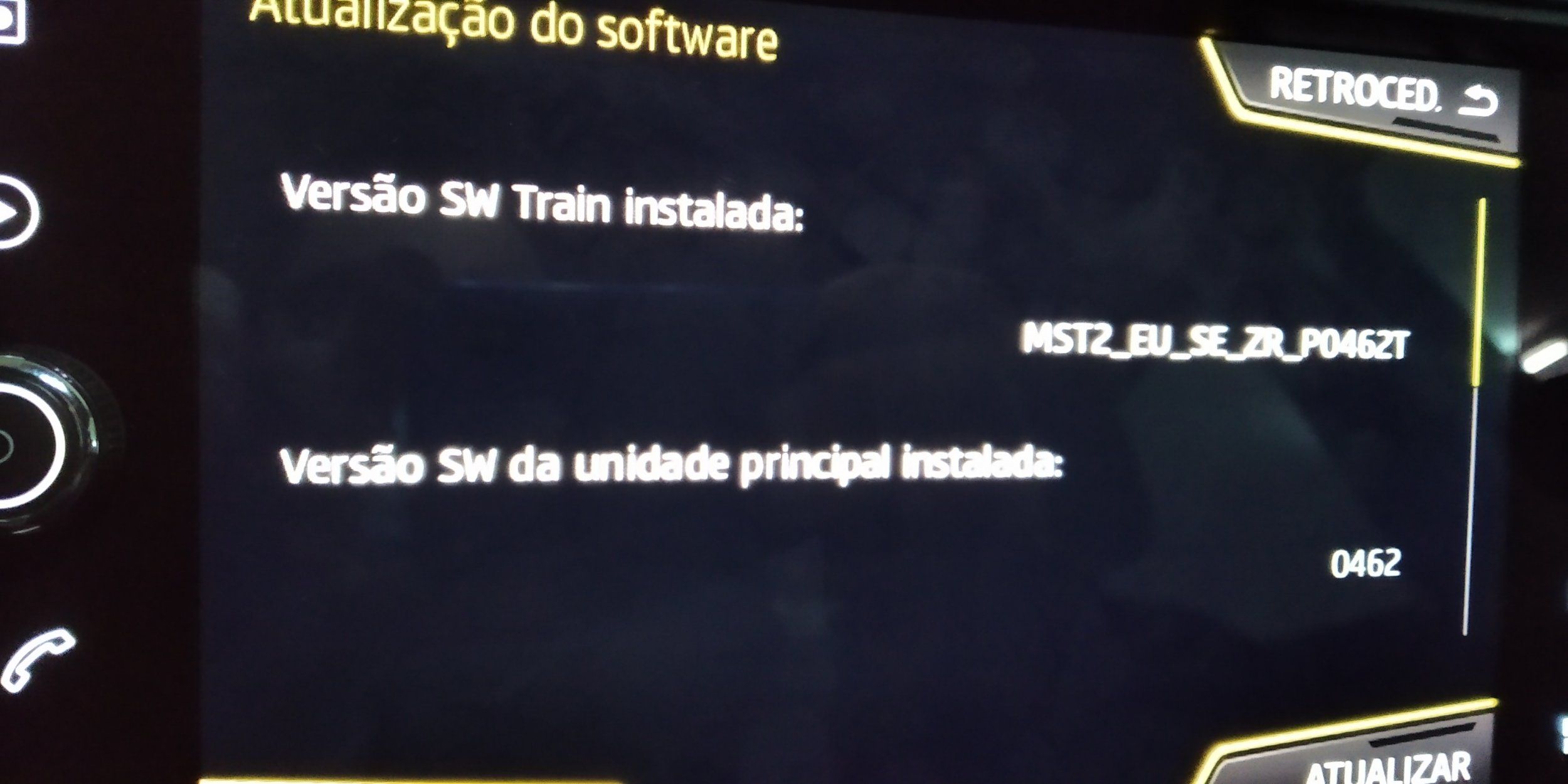

Did you take a back up copy so you have the overall.nds file so you can do the workaround. I'm assuming it's mib2 standard. Check that.
After checking... but I suspect it is, did you do this bit
Before proceeding it is important to take a copy of the contents of the SD card.
If you didn't then follow this heading
Lost, Stolen and Missing Cards from a Mib2 Standard Unit
That gets you back to a working file you need, then read on from the heading
Workaround
Suspect that is your issue.
No you follow the lost and stolen bit of the text. Quite a few people have fallen into this trap. I use to find each of their releases but in fact it became apparent that a universal solution was to download what I give you in that text. That's the first mib2 standard release that Seat had. The overall.nds file in that release is then good for all installed releases that are paired with the unit. That is then your savour file.... that's the one you use with the work around method.
E.g. this download gives the missing file
V1 link (Credit Markobc with that one):
http://infotainment-cdn.skoda-auto.com/base/maps/0430_MP143-1248.0EUR.zip
Then you just write that overall.nds file in place of the one you got on your latest download. Step 9 of this
Steps:
  1. Download the latest standard MIB2 maps
  2. on the infotainment go to settings, safely remove, sd1 card
  3. remove sd1 card from glove box slot
  4. long press on the on / off to reboot it a couple of times
  5. insert sd card in to computer
  6. copy and paste all contents to a directory on your computer
  7. Format the SD card keep it as fat32 and leave format settings as default in file explorer (don't forget to push the card lock mechanism to off) (ditto in a MAC or delete all from the SD card)
  8. Copy the new downloaded map version to the SD card (after unzipping it)
  9. Replace /maps/EEC/EEC_WLD/OVERALL.NDS on the SD CARD with the one from the original SD card
  10. eject the sd card (on a MAC run CleanMyDrive on the SD card - then eject)
  11. Inserted the card into the card 1 slot in glove box whilst infotainment is off
  12. power on and go to navigation
Your original will be off that Skoda link. If Skoda servers are playing up then use the second link I gave in the mib2 lost and stolen card section. That uses the Skoda download manager and is more resilient to internet server difficulties.

The link does not work.
what is the other one?
That one works for me but they can hang since Skoda servers can be problematic at times.
First link:
Second link:
That uses the Skoda download manager. More stable on wobbly internet. It first downloads the download manager, you then click on it, then click download, it then prepares your file at the server end, then you OK it to start off. You can unzip from where it saves it rather than copying it on to SD as I recall.
OK I see you got it but get the extra documentation :). Off to bed.
First link:
Second link:
After the download is complete, I will replace the file you mentioned. Then I give feedback. Thank you very much!! Good sleep
Reactions: Tell
You are magnificent! It resulted, I already have GPS in my Seat again.
However, the map is not updated, even after the folder with the recent maps has been placed
Reactions: Tell
Glad it worked. Stefan the guy behind the original workaround takes the key prize plus others who tested the approach of going back to Seats year dot with mib2 so that an overall fix can be found.
On the map not being updated that will be I guess a new road has been built etc that TomTom cartography hasnt digitised in yet / within the one year lag. You need to get a TomTom account (free) so you can tell them about missing and incorrect material. Best to provide the evidence via web links / photos so they can validate it. See under the section on Cartography
