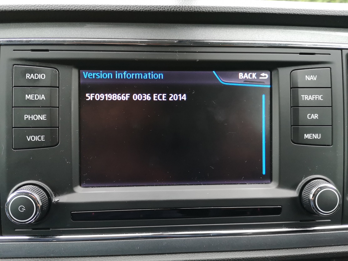

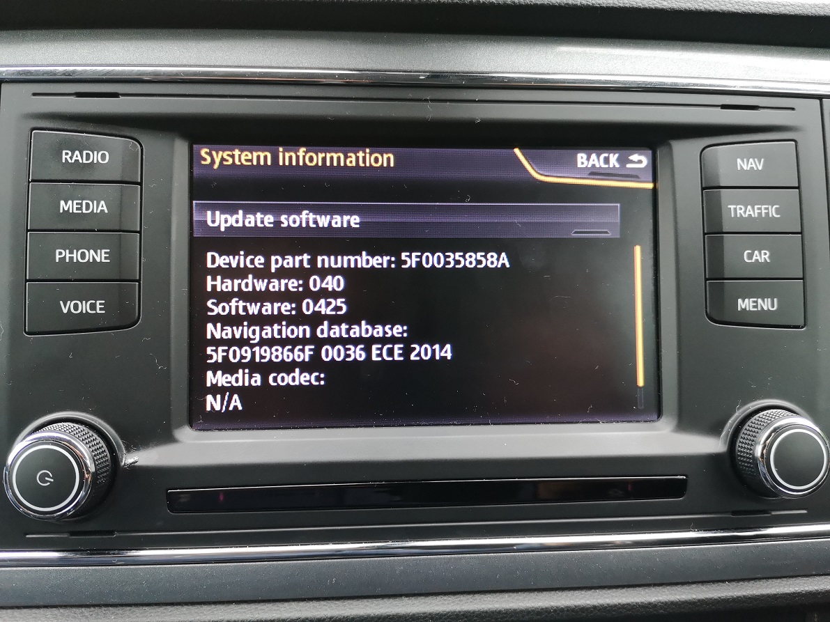

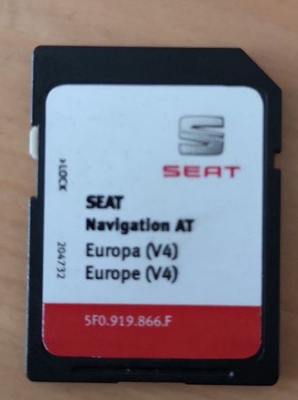

That's the version what I got in my car.
Sat nav is running from sd card and it showing that satnav is from 2014.
I just try update maps from Skoda (I think, found the link somwhere) but my sat nav in car after loading them showed "Maps are not up to date". But when I checked version number showed 5F0... ECE 2019/20.

You are out of luck with DIY updates, it's a Mib1 standard. The holly grail. Hope you took a copy of the card before you deleted what was on it. Using a Mac, use CleanMydrive utility after you copy it back to SD.
Yeh I took copy before I done anything.
Tried them new maps but unfortunately didn't work :banghead: same problem "Map are not up to date.."
So what is the best option to do ? Is any chance to update sat nav in my car ? Or just left to contact with Seat dealer to buy new card with new maps ?

I wouldn't buy any eBay cards for mib1 standard off eBay that's where people found they couldn't upgrade themselves, mib1 Mapcare how it's implemented stopped that. A few people could put the cards in, in 2017 and it worked, the majority couldn't. Ask your dealer about it, think it's like mib2 will cost you over £100 Or so, they unregister the card and register a new one. You always have the retrofit option if you can find anyone reliable to doodle with it. That's basically where we got to before. One person appeared once who said they could, wouldn't say the process since they were attempting to run a business out of it from East Europe. Amounted to opening the unit up as I recall. Probably using a standard process that retrofitters know about. Depends how much you belove the car and maps on it. Yeah it's irritating when new roads open and aren't in it, why I went down the retrofit mib2 high option with mine and keep the standard maps up-to-date on the partners car. If you are interested in navigation having a car with duff maps in it, isn't something you do.
