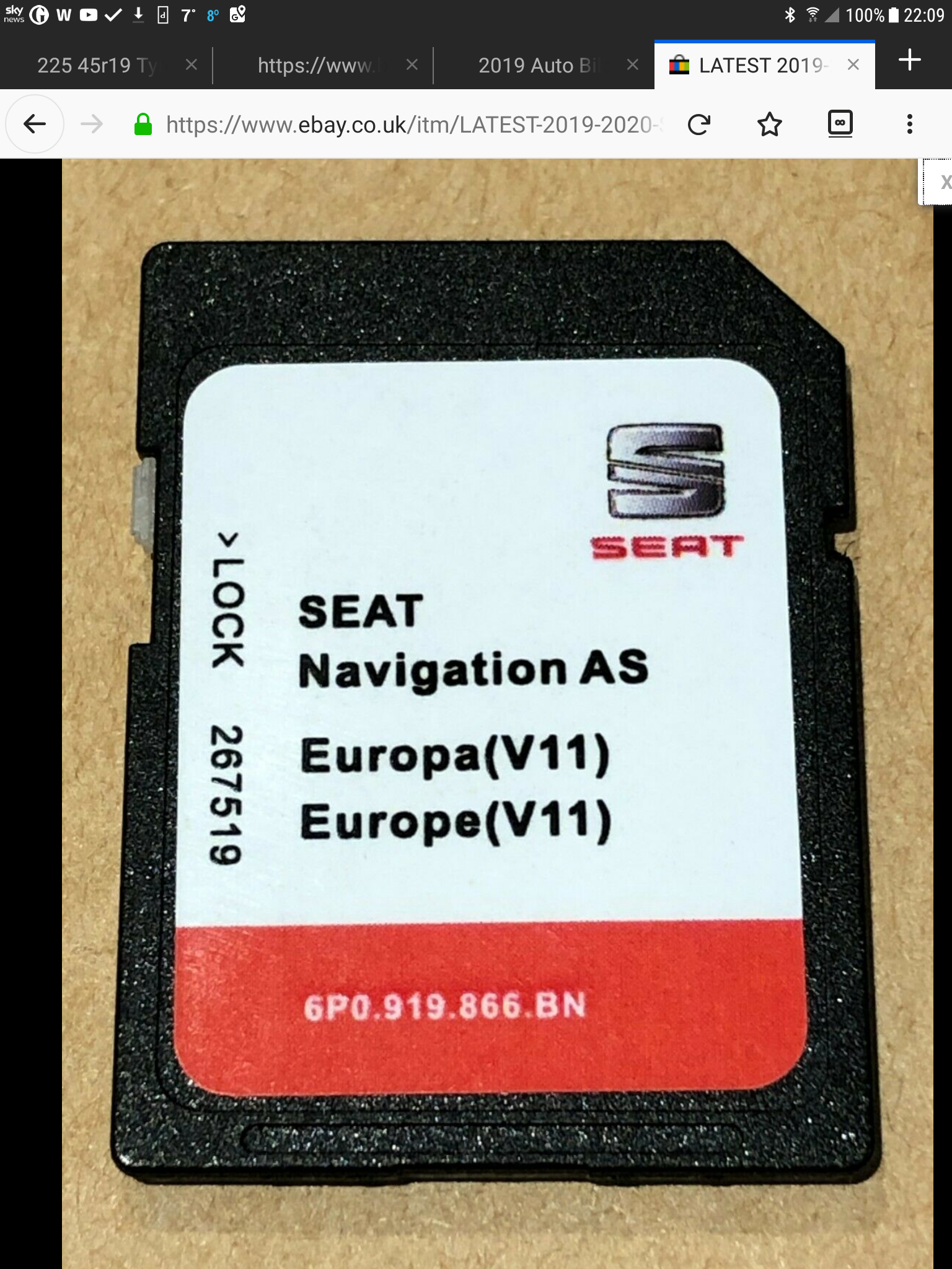

Hey, last week I bought a 66 plate Leon FR Tech, but it came without an SD card, I'm new to this whole thing so I was wondering if I could get away with buying a card and hoping it would work, or will I have to get a new one from Seat? Cheers for the help.
If it's the standard mib2 which uses an SD card, no best to get Seat to install the map card. If it's through a dealership it should be supplied. After that the "workaround" is available for map updates. Often the card supplied is out of date so you'd update it yourself once a working version us installed. If the unit has been married up to a card in the past the dealer needs to remarry it to a new card. Its only if its never been married up can you put a card in it yourself - least as I understand it. That's how dealers send people cards and they work.
I'm not up to speed with what the options were on 66' plate Leon FR tech. I'm assuming it's the standard mib2 and not cut down colour thingy as posted above. If you got a box in the glove box that's a proper navigation unit. Doubt it would be a plus and the maps are on an SSD in any case.
Thanks for getting back to me. In the glovebox I have a box with 2 SD card slots and what I think is a CD slot. As far as I'm aware, I don't think it's ever had an SD card married with it, because I think it was an optional extra that the first owner before me didn't choose.
I was tempted to buy a card just to see if it would work, but I wouldn't have a clue which card to buy, since there seems to be many different versions.
Failing that, I'll just take it to a Seat dealer haha.
I'd ask them the price. 1030 version is a common one installed which has a 6P.... part number. As long as it's mib2 standard thereafter once installed you can upgrade.
You can always buy the latest v11 card and if it doesn't install present to the dealer to install. Do a price check, supplied by them and installed, supplied by you and them to install or if it's never had a map card in it may install assuming it's a fully pledged mib2 standard. The 6p number on the card is the one it shows on the info screen once installed. What the V11 looks like, image attached. I'd enquire then review your options.
