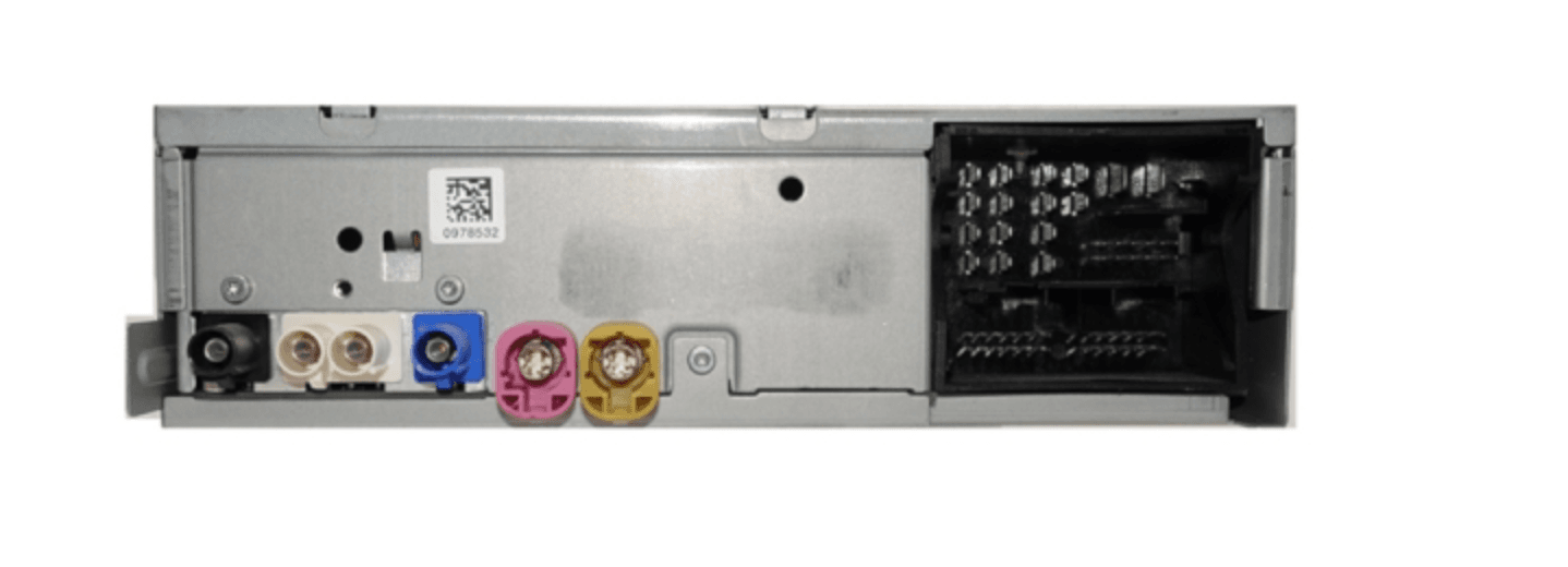

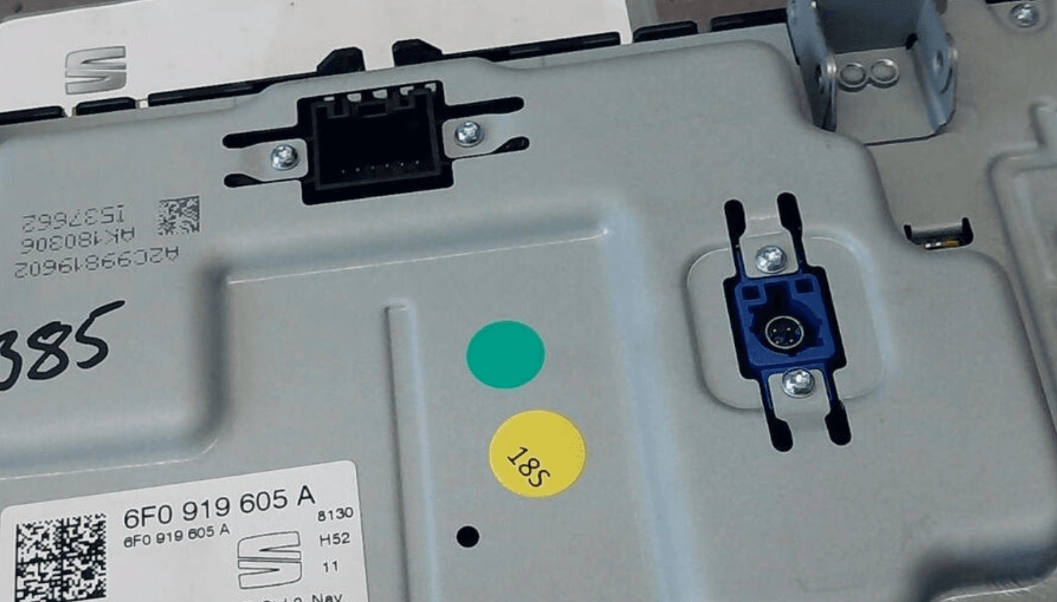

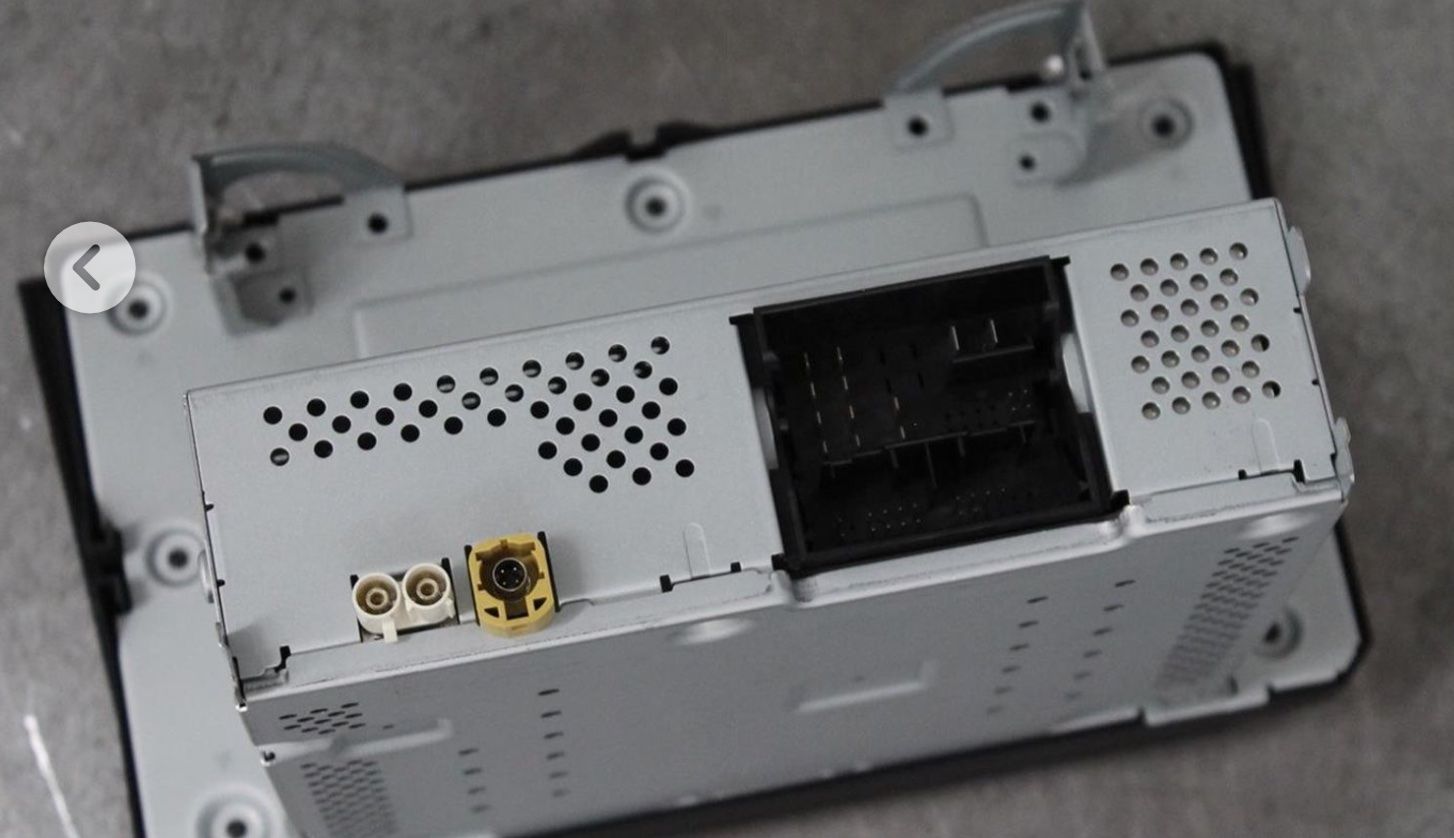

I am in the process of upgrading from a 6F0035871A to the nav unit 5QA035858B and the 6F0919605A display.
So from this... Untitled.jpg to this.. Screenshot 2023-09-26 at 19.43.08.pngand this Screenshot 2023-09-26 at 19.39.56.png
I already got the pink-to-blue LVDS cable, but can't figure out what else I need. Can anyone tell me what additional cables I will need and where I can find them? Like what are the blue and black connections on the back of the nav unit?

do I really need this one? the double white connection looks the same as the original unit that I am replacing so it should already be there when I pull it out?

On a previous post you wrote that 2 new cables are required when doing this upgrade. If I buy all that is so far recommended I will have 4 new cables. And I still don't know what the blue and the black connections on the back are for (maybe one is a navigation antenna and the other?). If I figure out what those are then I will have 6 new cables.

Nº3 If your current radio only has one white socket (and mine only had 1) you need that cable to divide it into 2. If you already have 2, you don't need it.
