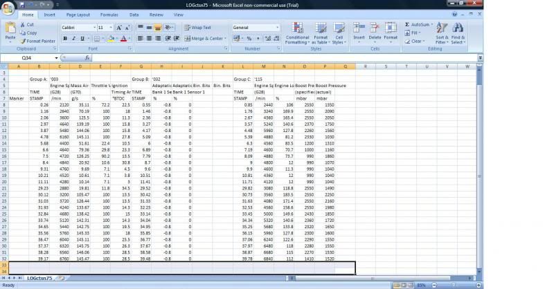

anyway heres another log if anyone cares to spot something that i havnt.
