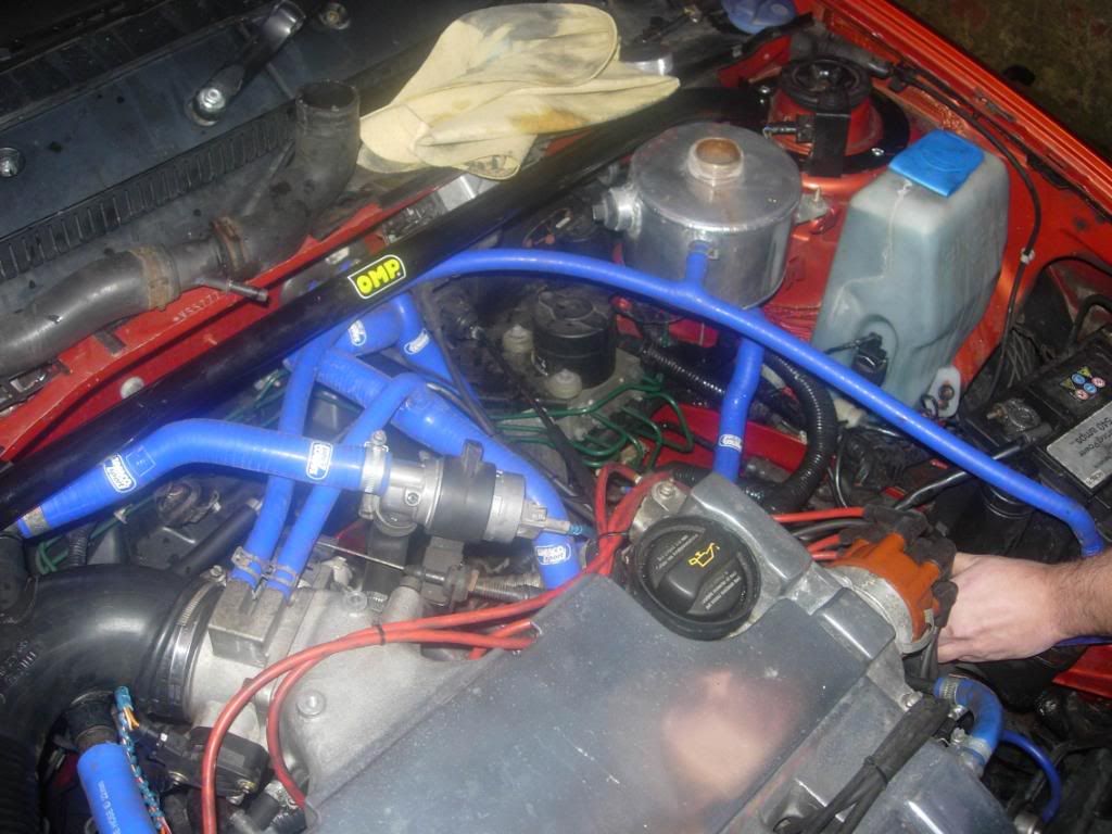

bit of a update got a nice samco kit the other day
got some cams coming for it and getting it mapped in feb
