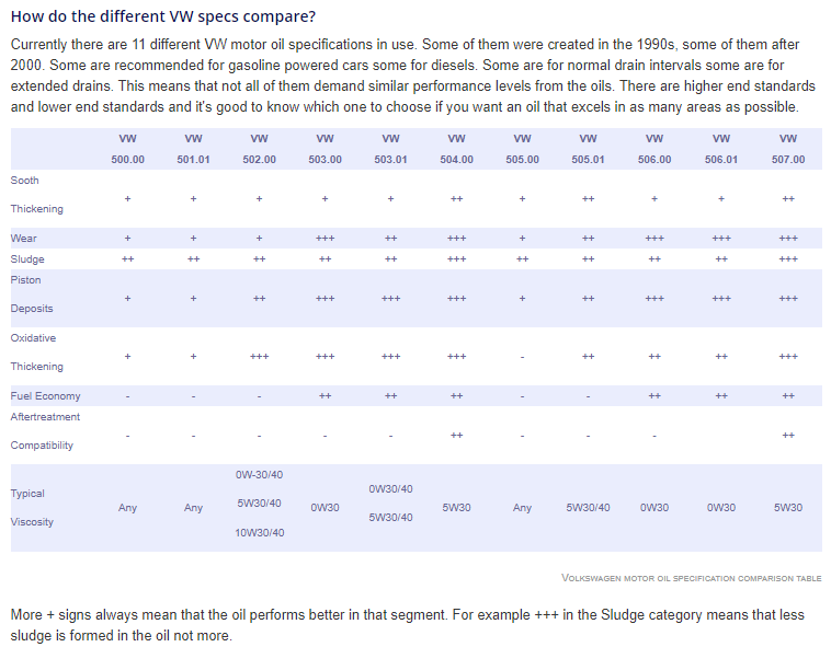

https://www.oilspecifications.org/articles/vw_motor_oil_specifications_explained.php
Strangely while it lists 504 for petrol engines, it does not list 507 for petrol engines, maybe there is or is not a reason for that or that listing is wrong. There are a few online explanations of VW Group engine oil specs I think, maybe more info elsewhere than the one I linked to.
Edit:- though Mobil 1 ESP 5W-30, which I use, claims to be 504 and 507 compliant, so I'd probably believe that info provided by Mobil before the "official" looking site I linked to above - though probably that link above does not necessary disagree with the Mobil website.

I've been burnin' up the internet trying to find out what the difference is between 504 and 507 and I've found nothin'. I also can't find anything to say that they are the same and are interchangeable. 504 is always listed for petrol, 507 always for diesel.
It could be that while the 504.00 and 507.00 specs are slightly different, in reality oils can be made to satisfy both specs at the same time, and for convenience oil companies have designed an engine oil that covers both VW specs - while out in the wider world, some 504.00 spec oils do not meet with the later 507.00 VW engine oil specs, ie maybe some earlier 504.00 oils - or may not have been submitted for formal testing for compliance to the 507.00 engine oil spec.

https://www.my-gti.com/7/volkswagen-oils-50400-and-50700
From that, and the same words plastered on every other Google link lol, I take it the Oils are nowadays manufactured to incorporate the same standards be it diesel or petrol.
This only looks to apply to newer engines (Euro5+), and I would guess that's due to the cleaner running capabilities!

Coming from a background in motoroil chemistry, I can confirm that oils can have the same functional properties but be chemically different from each other. With respect to the quoted post, oils made for diesel engines will more often than not, contain low SAPS compounds. That is sulphated ash, phosphorus and sulphur.
A low-SAPS motor oil is an oil with a low proportion of sulphate ash, phosphorus and sulphur. These oils are also designated “low-ash” due to their low tendency to ash formation. Particularly useful in modern cars with a DPF! Stops your DPF from clogging up so quickly and prolongs the life of catalytic converters.
Whilst this sounds like a great idea, High SAPS oils are easier to make, and thus tend to be used in petrol engines where the requirement for low ash is not as high. However, with the introduction of GPF. I imagine we will see more cars requiring Low-SAPS motor oils.
Based on the above, and the below flow chart, it would appear there is some chemical difference between 507 and 504 that would impact the longevity of the DPF. I would say it is safe to put 507 into a petrol car, but not the ther way around.
Below is more supporting information about the importance of SAPS between the two oils.
