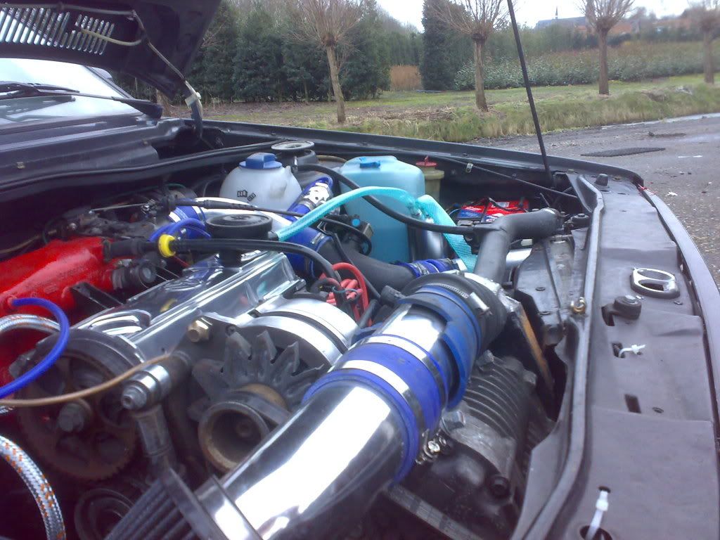

well then lads, had a bit more of a play with the engine bay today. Switched some of the oem hoses for silicone, and started polishing the kompressor outlet to airfilter housing.
result:

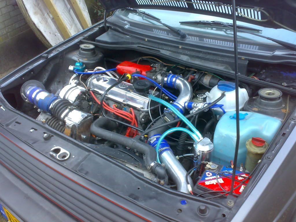

small-ish update:
catch tank fitted (excuse the cheap garden hose fitted, have proper hose on order) and braided fuel lines fitted. Also started cleaning up the alternator.
More work will follow shortly
