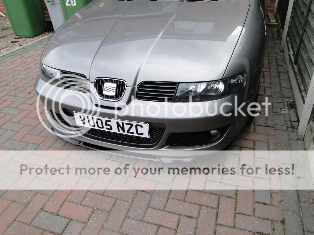

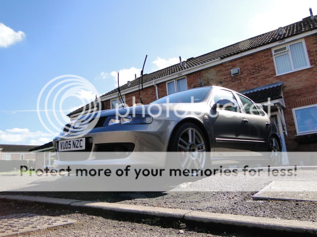

are going to be adjusting the height at all or you happy with how it is?
I'm happy with how it stands at that mate, just about get on my drive, if it was any lower then no chance! I have only come across afew problems with the hight but all is well and I'm happy!
Just have to keep wet and drying the splitter now and again! :p
LOL you've definitely got to be aware of the splitter, im thinking about raising the back of mine ever so slightly. I want to fit rear spacers and looking at the rear of my car it will be a little too close for my liking, its sounds like yours got it spot on![B)]
Car looks awesome fella... enjoy! :D

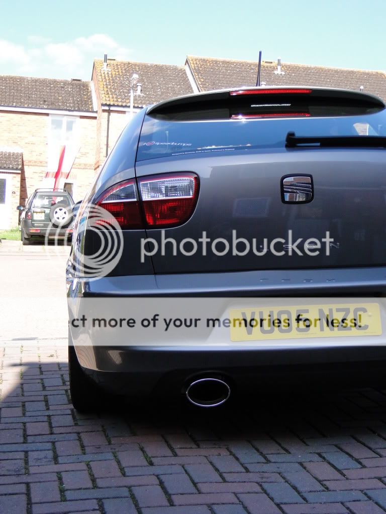

Just took some pictures with my new camera after cleaning the car! Still unsure how to use this camera correctly yet but I will get there! :D
(Sony DSC-HX1)
All taken on the Easy Setting!
That's it for now, Watch this space! :)

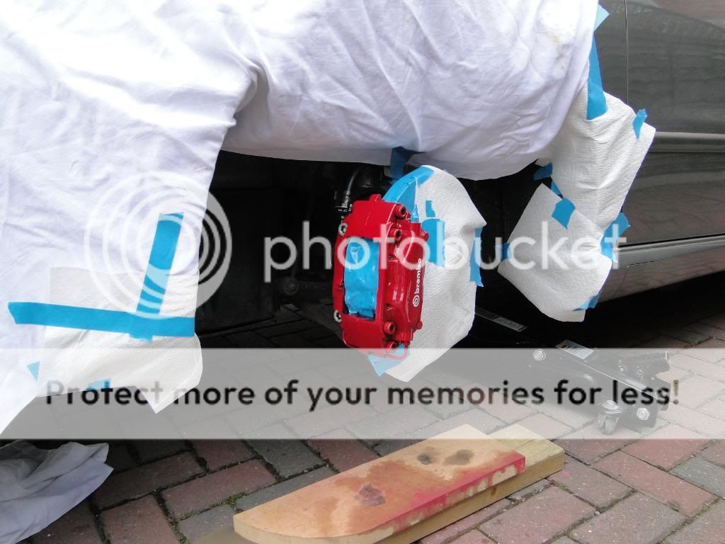

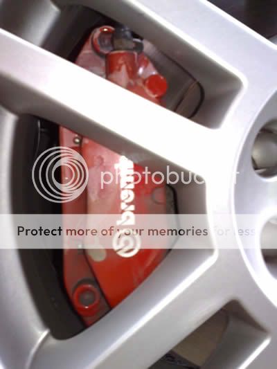

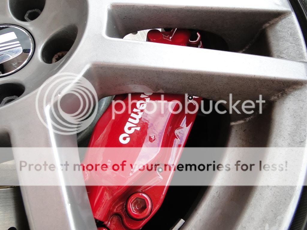

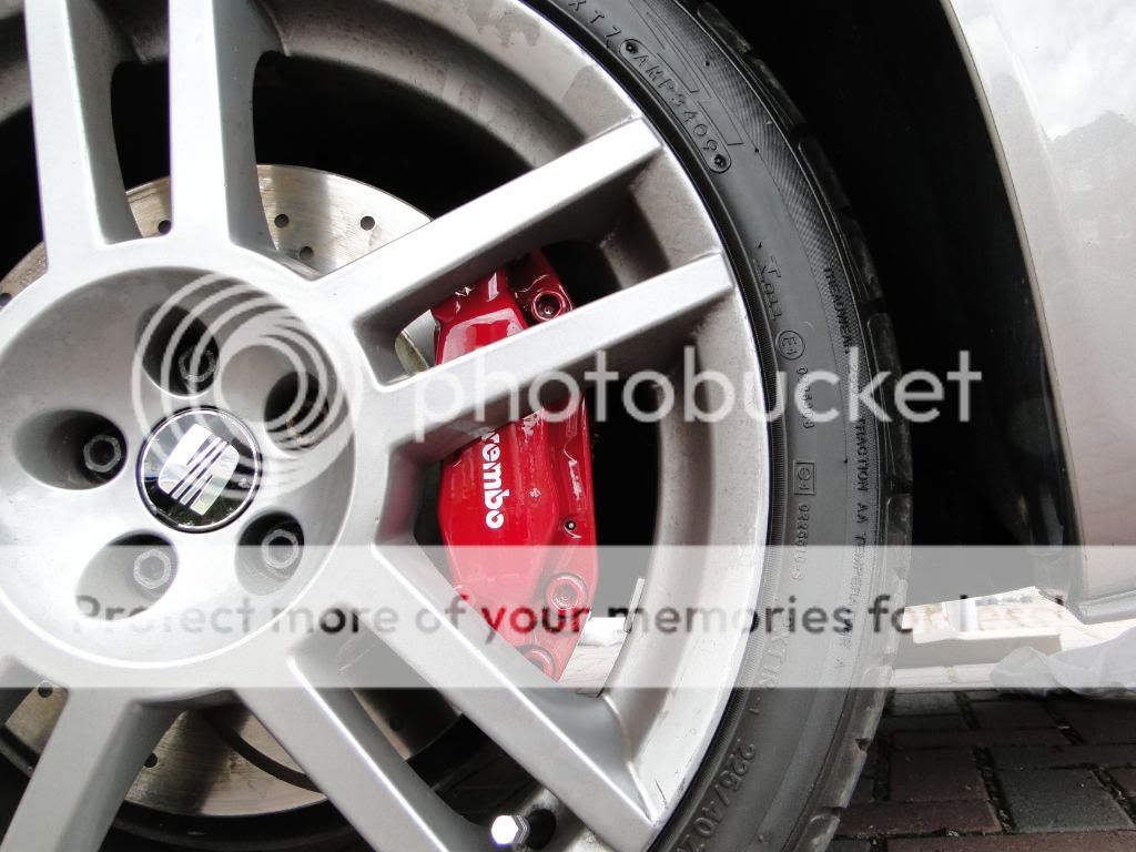

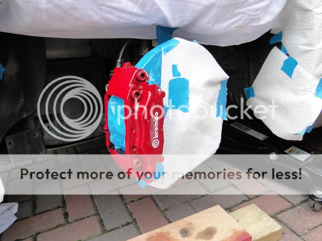

Ok another little update from today, decided to give the Brembos a good looking at! I don't have any before pictures sorry but they did kinda look like m.r.davies. :(
This:

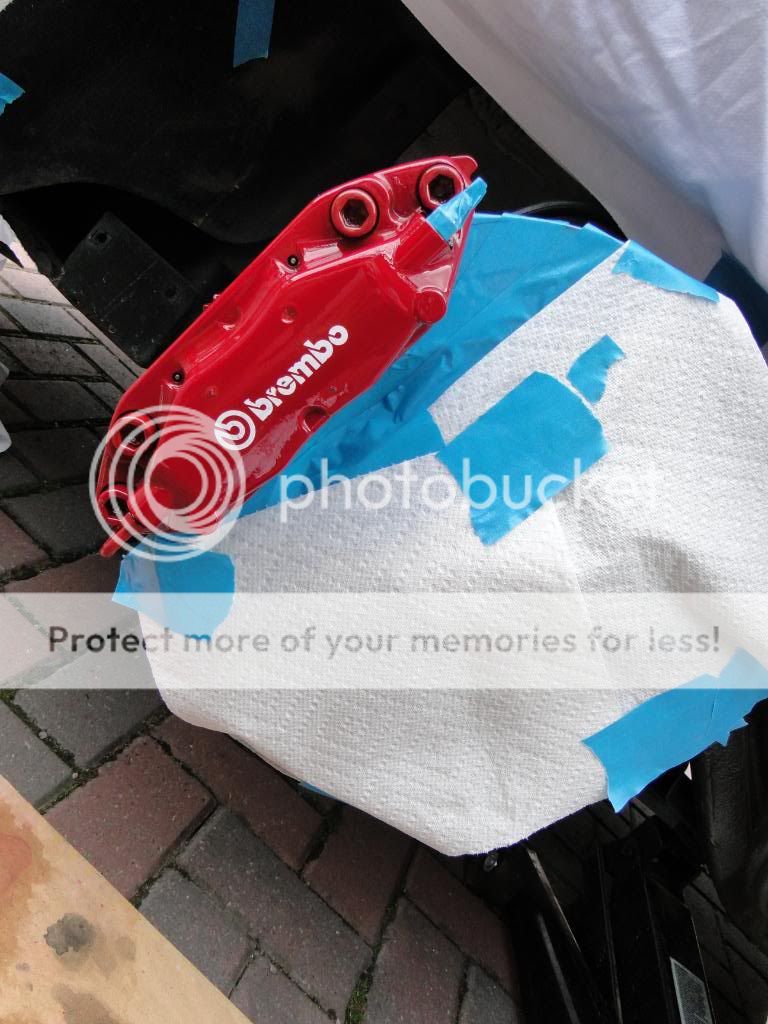

This is how they turned out! Very pleased.
Te back are easy mate, just clean and spray laquire them ;)
What did you do to the front's ? Just peel off the old and laquire and re laquire them ?
Yeah the back look easy enough, will give them a light sand!
For the fronts,I used de greaser and some petrol to remove any old brake dust and dirt!
I then peeled most of the lacquer I could off, then used a blade from a Stanley Knife to get as much of the lacquer off as possible, only took the lacquer off the one side of the brembo.
Used 1200 grit wet and dry, gave them a good sanding which brings back that nice red colour!
Then gave them 3 coats of lacquer! Going to leave them over night now! :)

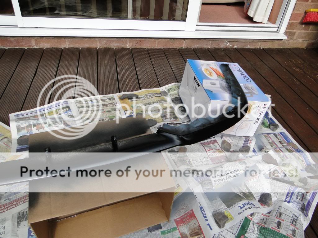

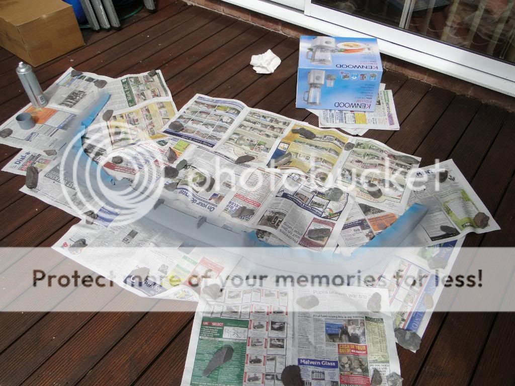

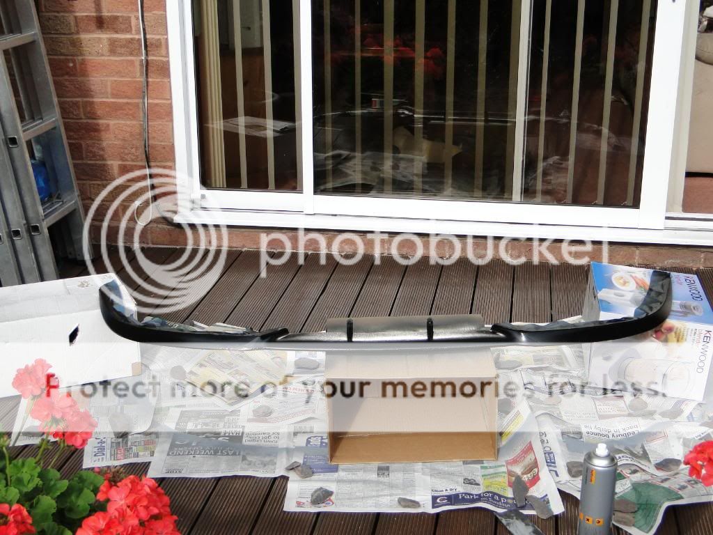

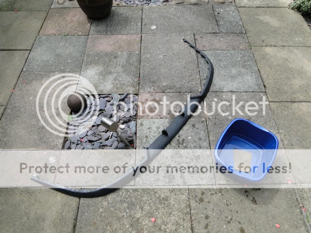

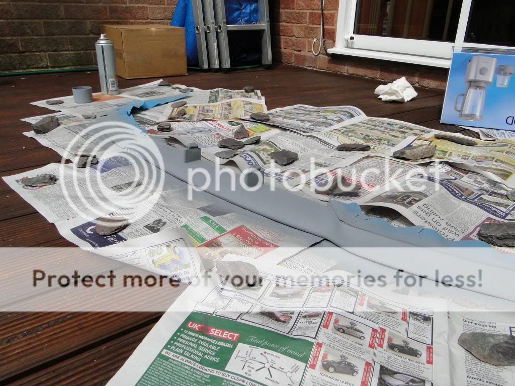

Another update,

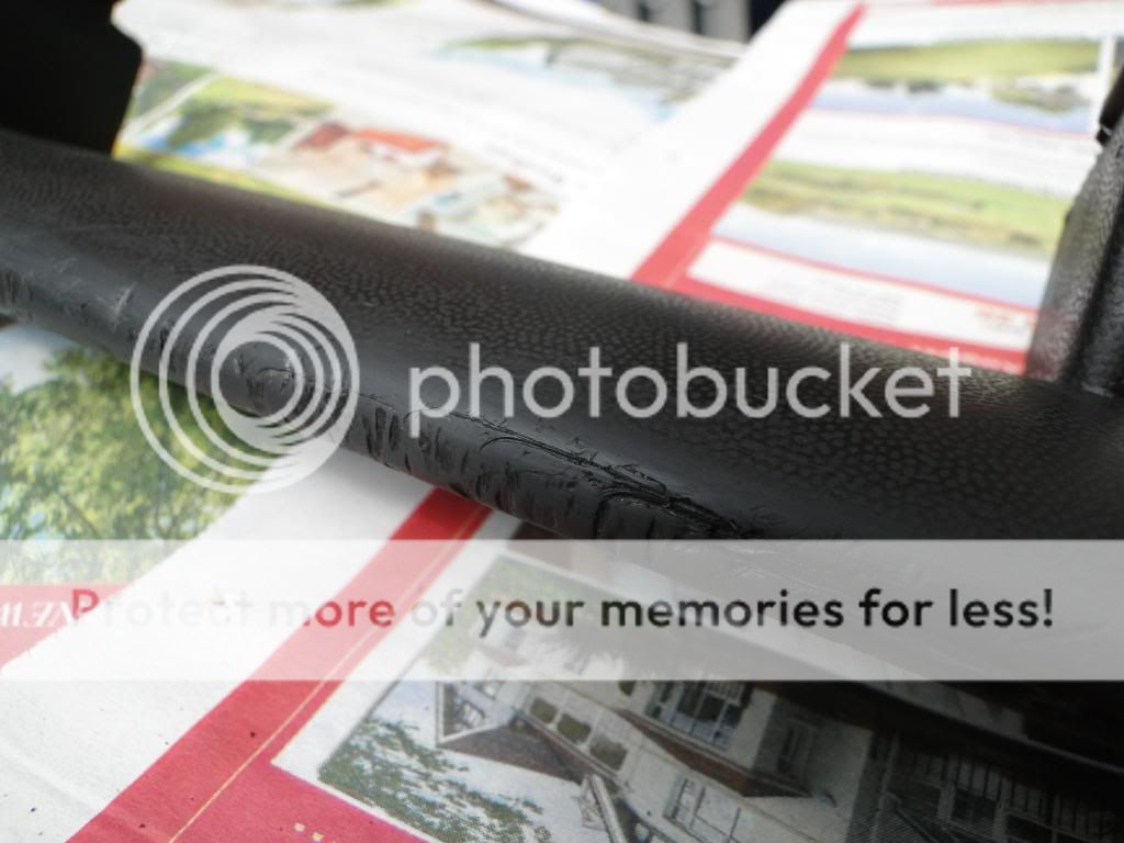

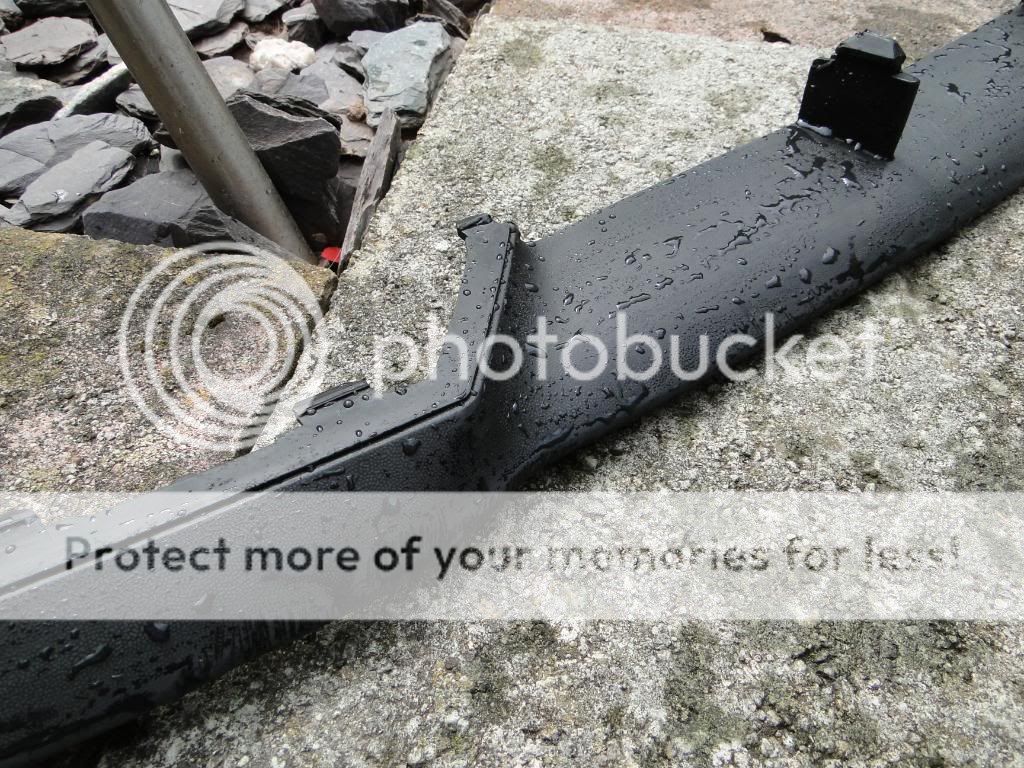

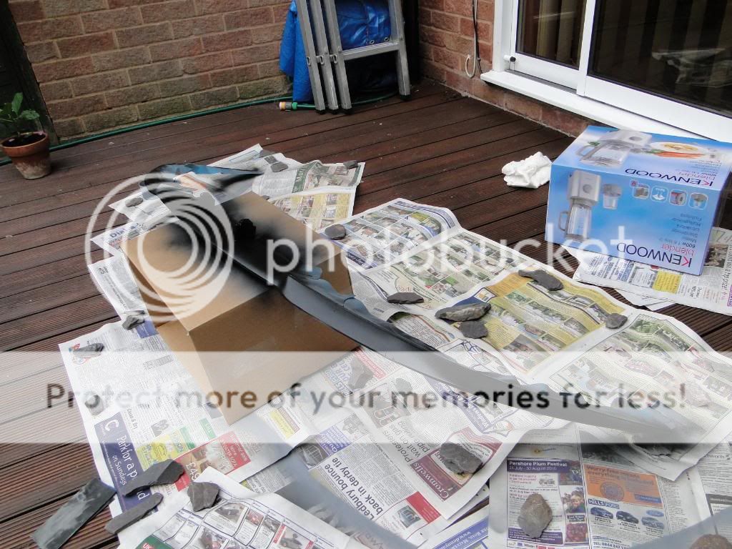

Decided to give the Splitter a good sanding and a spray! the result is what I expected because the splitter was in bad condition anyway, but until I buy another I thought I would have a play!
This is it,
Bit of wet and drying

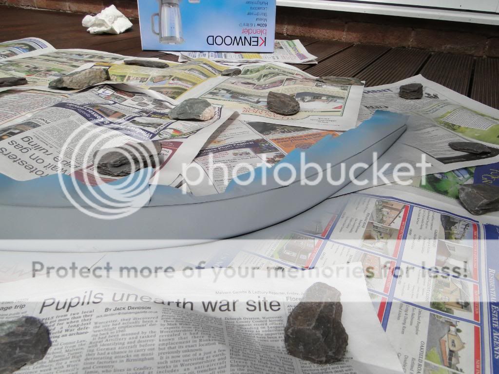

Primer

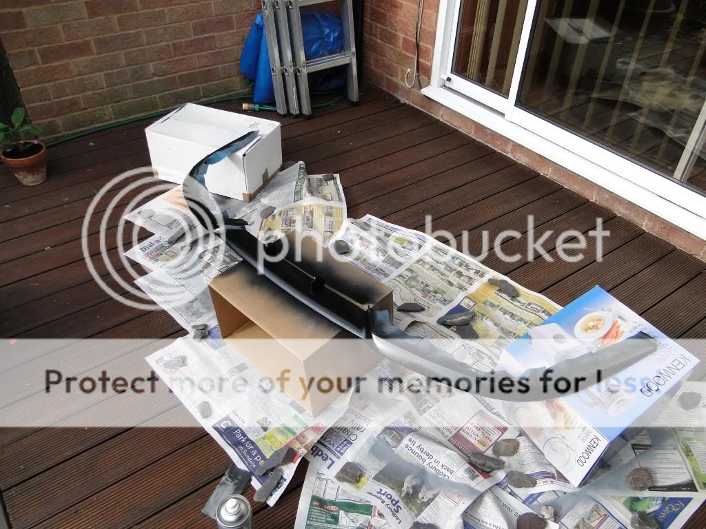

Matt Black
She's coming along nicely, you done a great job on the brakes. The splitter look good, i like it. I thought about doing exactly the same!
Keep up the good work fella.
