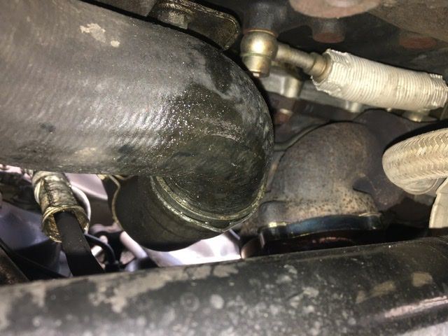

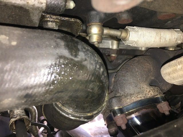

Rooting around the inter cooler pipes and noticed what seems to be a lot of oil on the pipe just beyond the pancake pipe. Is this abnormal?View attachment 13779 View attachment 13780
Be ready to replace the turbo. Oil will be leaking from the seals. I've had a few 1.8t and 1.9tdi and any oil in them pipes or around the joins means turbo failure is going to be an issue soon.
Second possibility could be and it's a long shot....turbo went....was replaced...but pipe work wasn't cleaned out. I've clean up pipework after a turbo went and it's not nice but fairly easy job so anyone replacing it would have taken the pipework off, unless told not to bother to save cash.
Wip of the hose...see if you have play, ..check for in and out mainly, slight movement? Shot seals and oil will be leaking from there into the pipework into the intercooler ect ect. Most cars that have a blown seal smoke a little, maybe off boost maybe on boost or spool up but it will smoke maybe only a little bit...more smoke, more damage to seal.

Like my day wasn't bad enough already.

What colour smoke? I've never had even a puff off blue smoke that i'm aware of. I will recheck the pipes for play, from what i gathered it seems like everyone has a little oil in there. Previous owners were certainly not enthusiasts, so i doubt that pipe ever saw some rag before then.

Funny really as it was white. (1.8t) many mechanical men says it's normal...I've met a few...oil isn't mean to come out of anywhere. No TDI left the factory like this and it doesn't go like this over time, Garrett never did this as a feature. seal is about to give way or has or has in the past. If an mot man see's it he may have a fit with the new mot laws. May not be leaking but shows signs of it so really should fail because it won't get any better and may fail and throw oil on the road.

You can replace the inside of the turbo, badger5 sells them for half the price of a new turbo but having it fitted, balanced, price will go up.
I'd take the pipe off and have a feel of the wheel. Any play...replace.
More play there is...sooner the replacement is needed.

£200/£300 ish . If it's not smoking, leave it, when it starts it will still drive. Treat her nice, she could go on for another 10k if driven ok.
Best bet, get under it, take the pipe off and check for play, maybe just be nothing.

Took the car out today to pick up a few things and kept an eye on the rear view mirror when I was accelerating. When the engine was cold, high revs in a low gear did see a little white/grey smoke out the back, but once the engine was up to temperature, there was none at all.
No trouble with acceleration and I could hear that the turbo sounded normal, so fingers crossed we're not looking at a turbo rebuild.
Once I can get under the car I can have a proper look - only problem is I sold my proper jack a few weeks ago and didn't get round to buying a low profile one before the lockdown started. We'll get there eventually...
