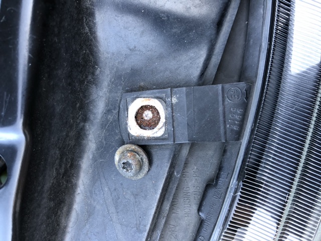

In the process of changing my headlamps. But I’ve just snapped one of the upper headlamp torx nuts. I’m reluctant to try the 3 others now without knowing how to fix get the snapped one out.:think:
What are my options??? I’m a DIYer so don’t have access to an abundance of tools.

Going to have to drill out the old screw. I'd then use a rivnut took and rivnut to create a new threaded section in the metal. Then you can use a new bolt. Try using penetrating oil on the rest before attempting them

Ok thanks for the advice. Mission abort for today I think. Lesson learned - I could have loosened these nuts yesterday before I jacked the car up, removed wheel arch liners and undid all the front bumper bolts!! Thank god I didn’t remove the bumper. :doh:

Defo give them a good dose of penetrating oil + if you have access to a heat gun or similar just give them a heat up before you try undoing them

Penetrating oil worked. I undid the other 3 bolts with no dramas.

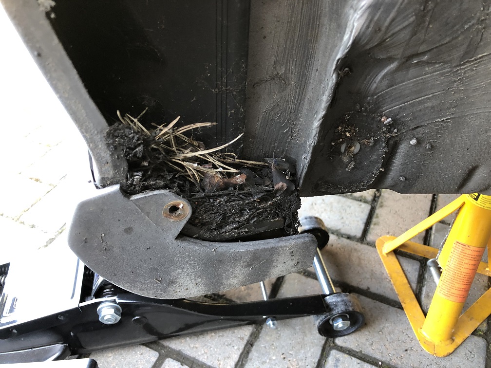

Amazing amount of crud built up just behind the wheel arches:
I cleaned it all out.
