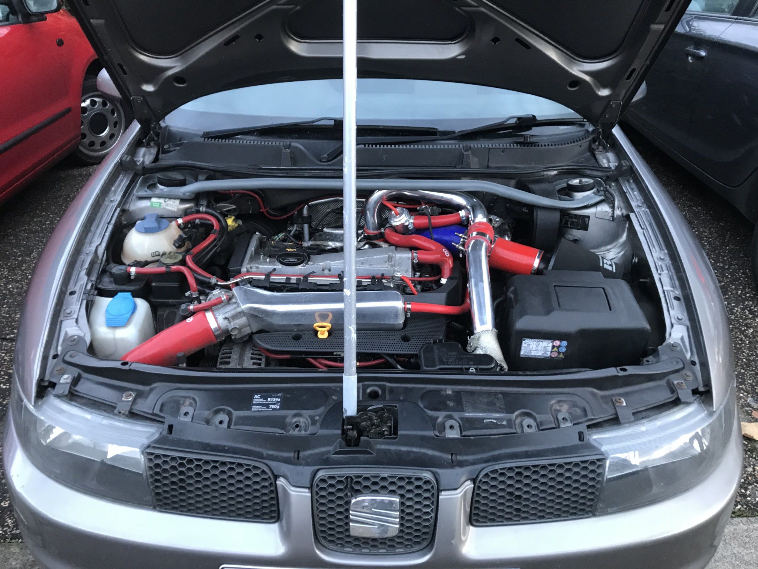

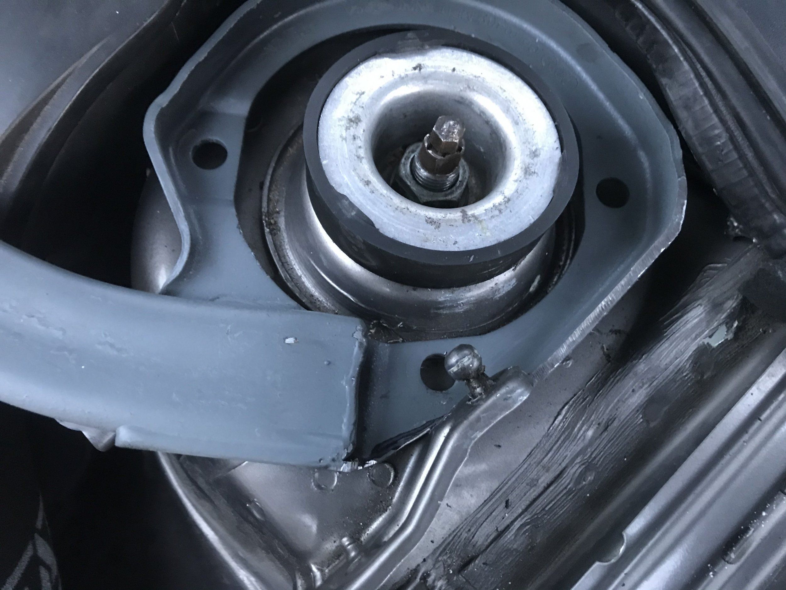

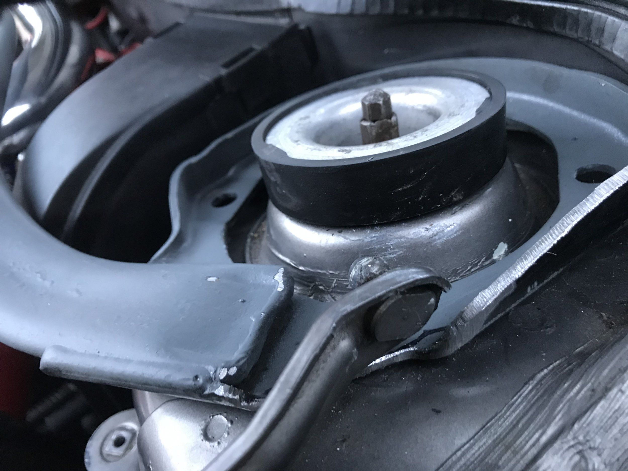

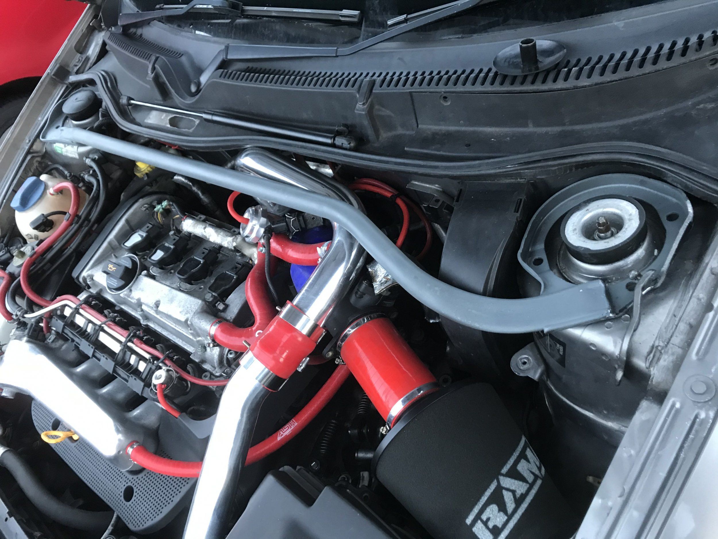

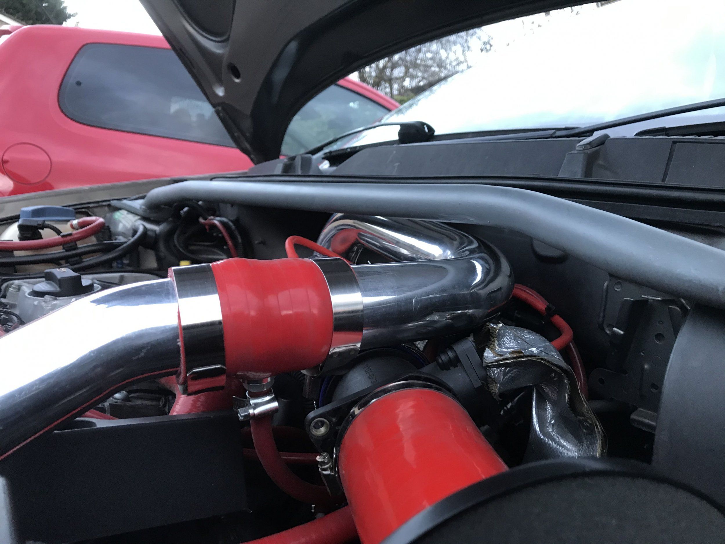

today i started working on my TT strut brace, grinded the tabs off and started sanding it all down to get rid of the lumpy texture. Hopefully tomorrow ill get to take the bonnet strut off and see what needs to be done to fit it around the bracket
Reactions: Sl1ced

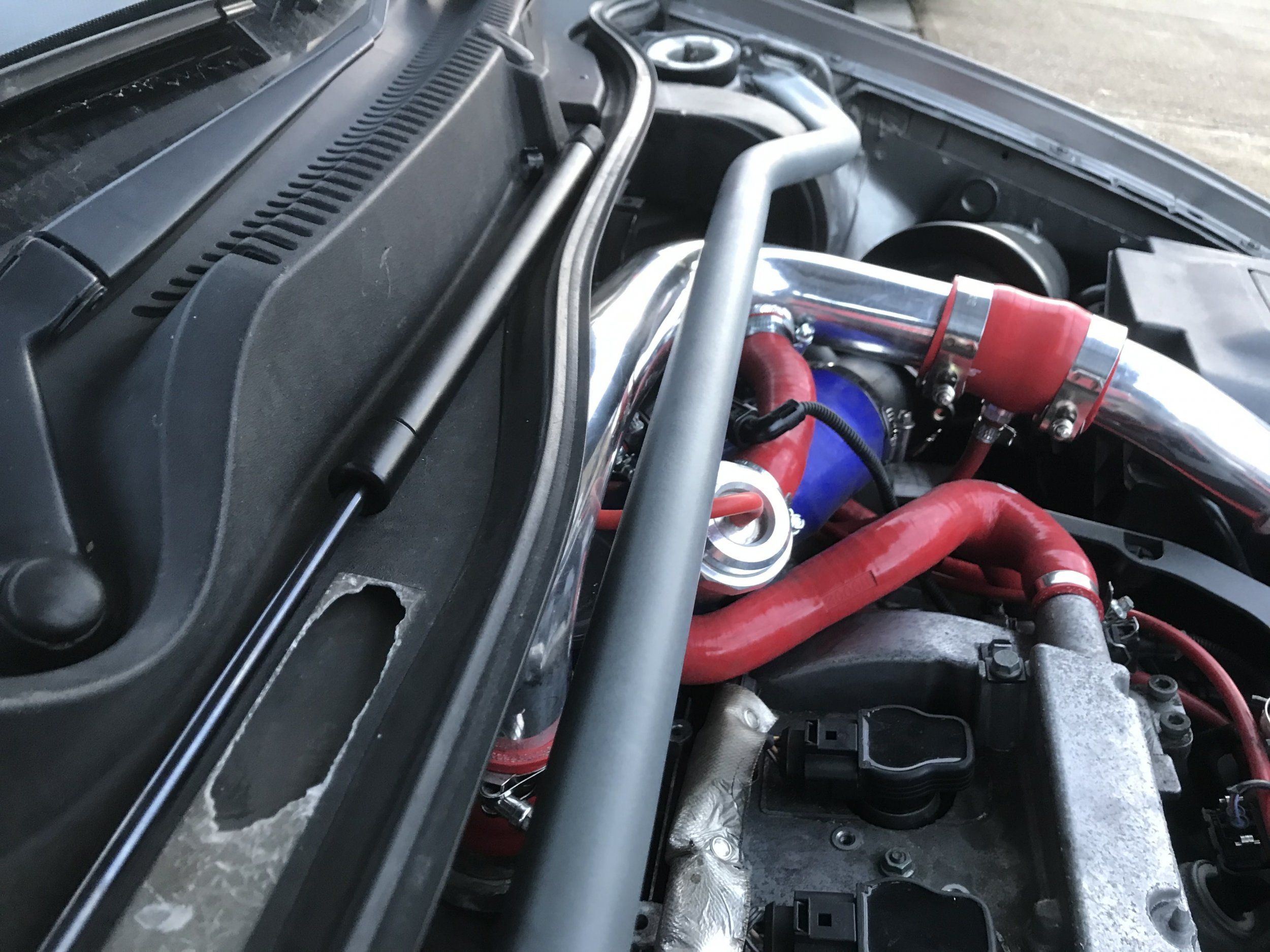

busy busy day working on the brace and making changes to accompany it
-First issue is the hot pipe was 100% in the way, couldnt even get the strut close to the turret. So i had to get ghetto and flip the turbo alloy pipe around. which was a massive PITA because its like a 60 degree bend so it aimed downward toward the tip.
-This meant the TIP had to move way way down, which means good bye heat shield (not like it does f*ck all anyway) and had to rotate the MAF away from the alloy pipe above it a bit.
-This also meant the DV take off was in a different place so luckily had some left over pipe to cut for that.
Once all that was sorted i had way more clearance for the strut over the hot pipes, started marking it up to cut and actually managed to squeeze it in
I decided not to cut any further into the strut and now will turn my attention to the bracket with a dremel tomorrow so the brace has more room to slide underneath, then i think it will be pretty much fitted.
I was going to cut it and move the ball joint on the bracket but i have no idea how to get it out! otherwise that will save me some serious hassle.
anyway, some pics of the work today

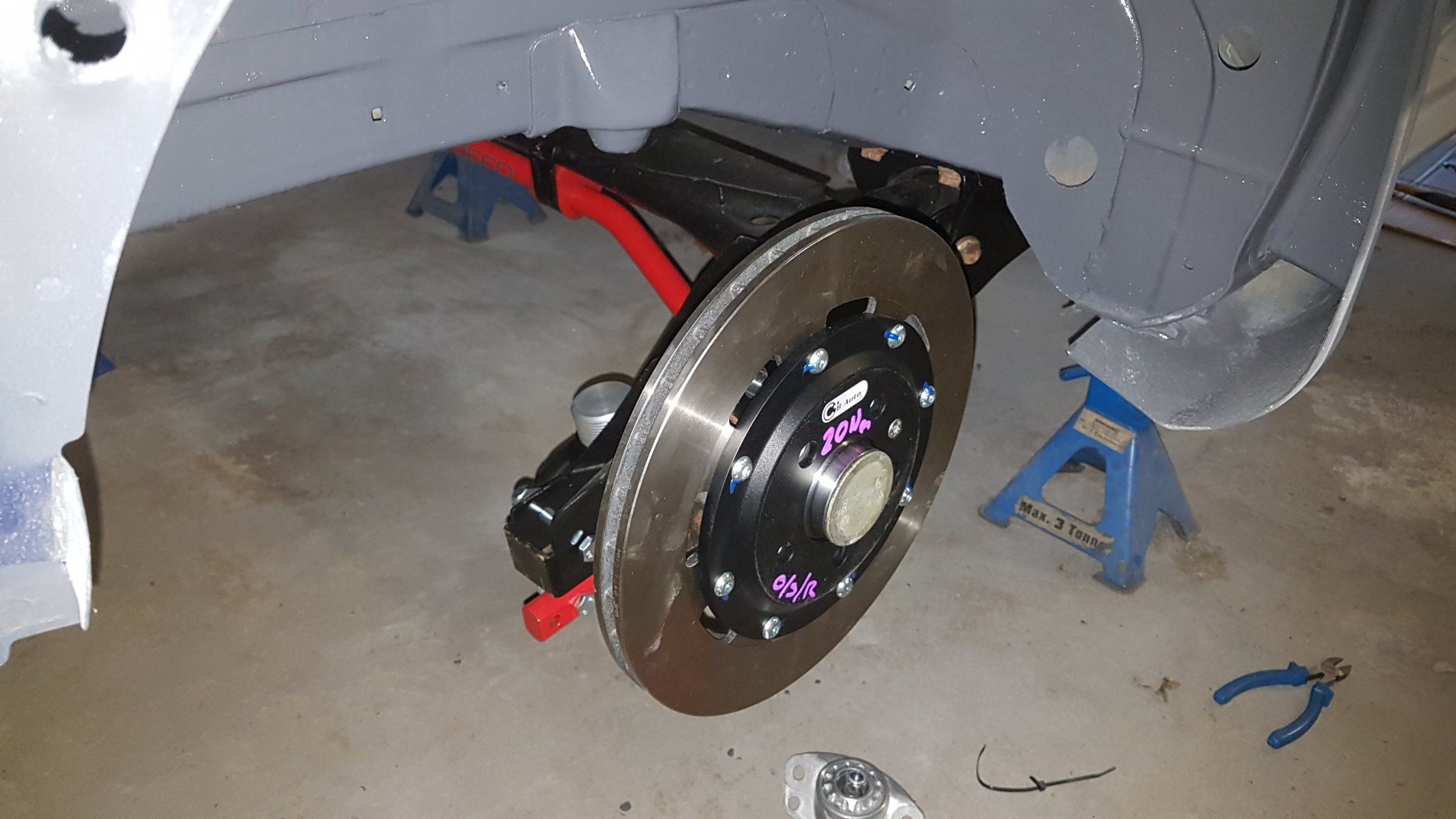

Drilled more holes and started making cooking ducts for the front brakes. And some nutserting. Will do a write up on my build page if your Interested
