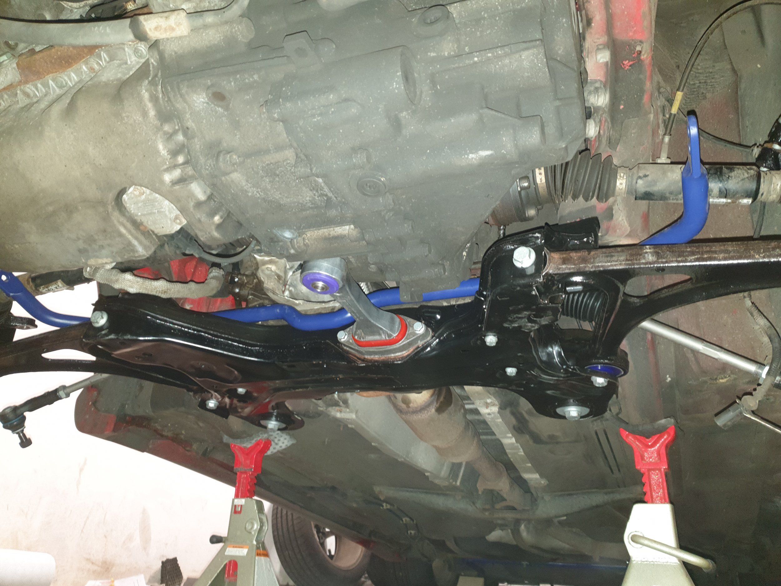

So theres no outer ring on the original rear axle bushes?
Just get the axle out of the way and poke em out?

Are you happy with them?
Did you need any special tooling to push the new ones in?
I've just put one side in. Used two steel disks with a hole drilled in the middle, and some threaded bar. They went in without any trouble, but you do need something to push them in.

Just to say on the outer ring point - it depends. I think the later models had plastic rings, while some of the earlier ones had metal.
Mine's an 05 FR TDI - it could be different with the petrol Cupra.
With the metal ones, you just have to clean out the rubber and then saw through the ring, so a fair bit harder than the plastic, but still doable as a DIY job.
The right tools seem to be most important - 18mm socket and spanner and a jack that you can lower smoothly.
I didn't have to use my breaker bar in the end, but it's handy to have in any case.

I’m happy with them and had to use a tool to get them in
I have the same ones as mooks and Yellow FR, havnt fitted yet but one thing i found out;
They dont have a recess in them like the Pflex ones, thats apparently a feature added to aid rear steering and harshness
