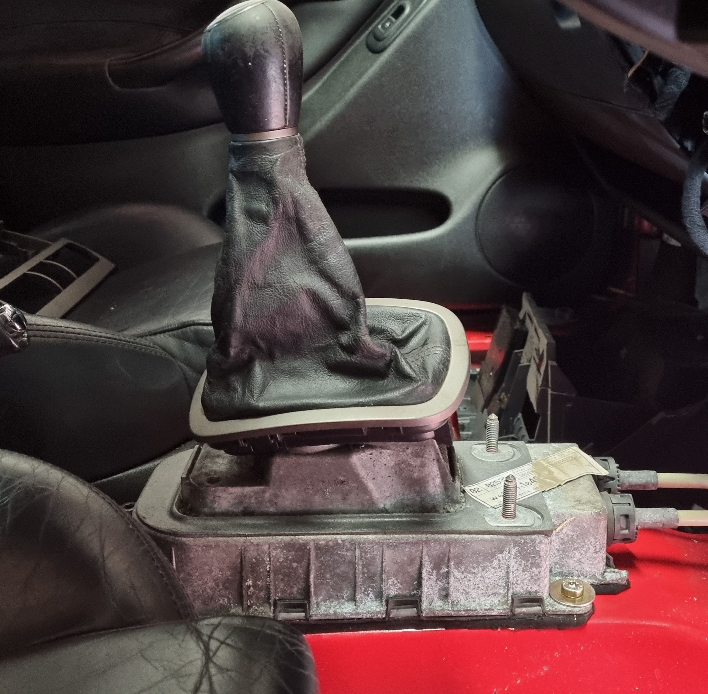

Just got back from the test drive so here's what was done.
Forge front to rear short shift set to almost max
Forge side to side short shift set to almost max
42Draft solid bracket bushes
Recon'd bracket
Darkside cable end solid bushes
What's it like? As Thai said it's notchy as hell, shifting into 1st or reverse isn't a good feeling, just means more care needed which I'm okay with.
Shifting is a lot more direct and each shift is a flick of the wrist away. It turns heel n toe into a joy rather than an exercise in patience and faith/luck.
If this wasn't a car headed for track days (and commuting when the weather is too crap for a bike) then I'd back off the throw.
