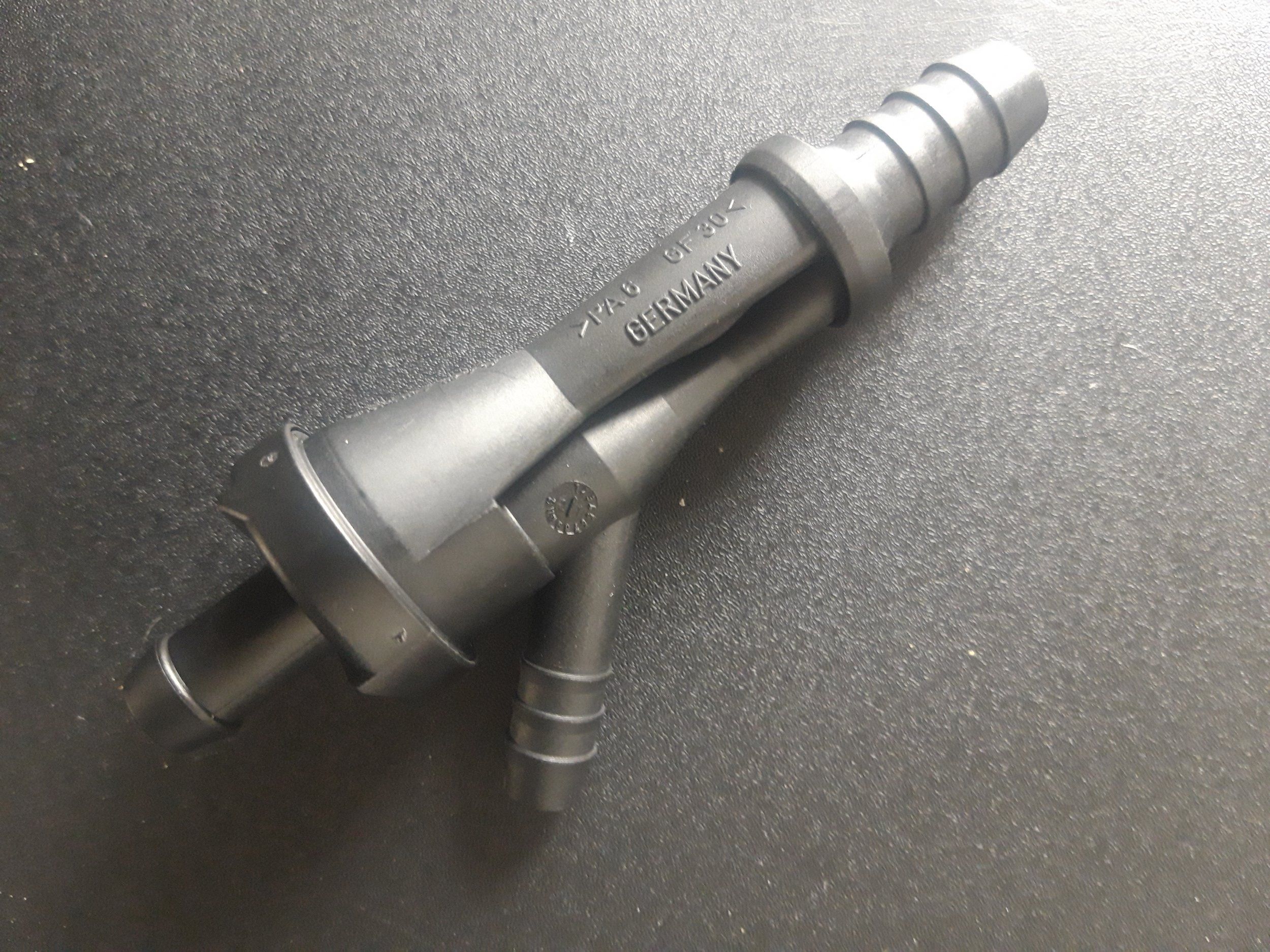

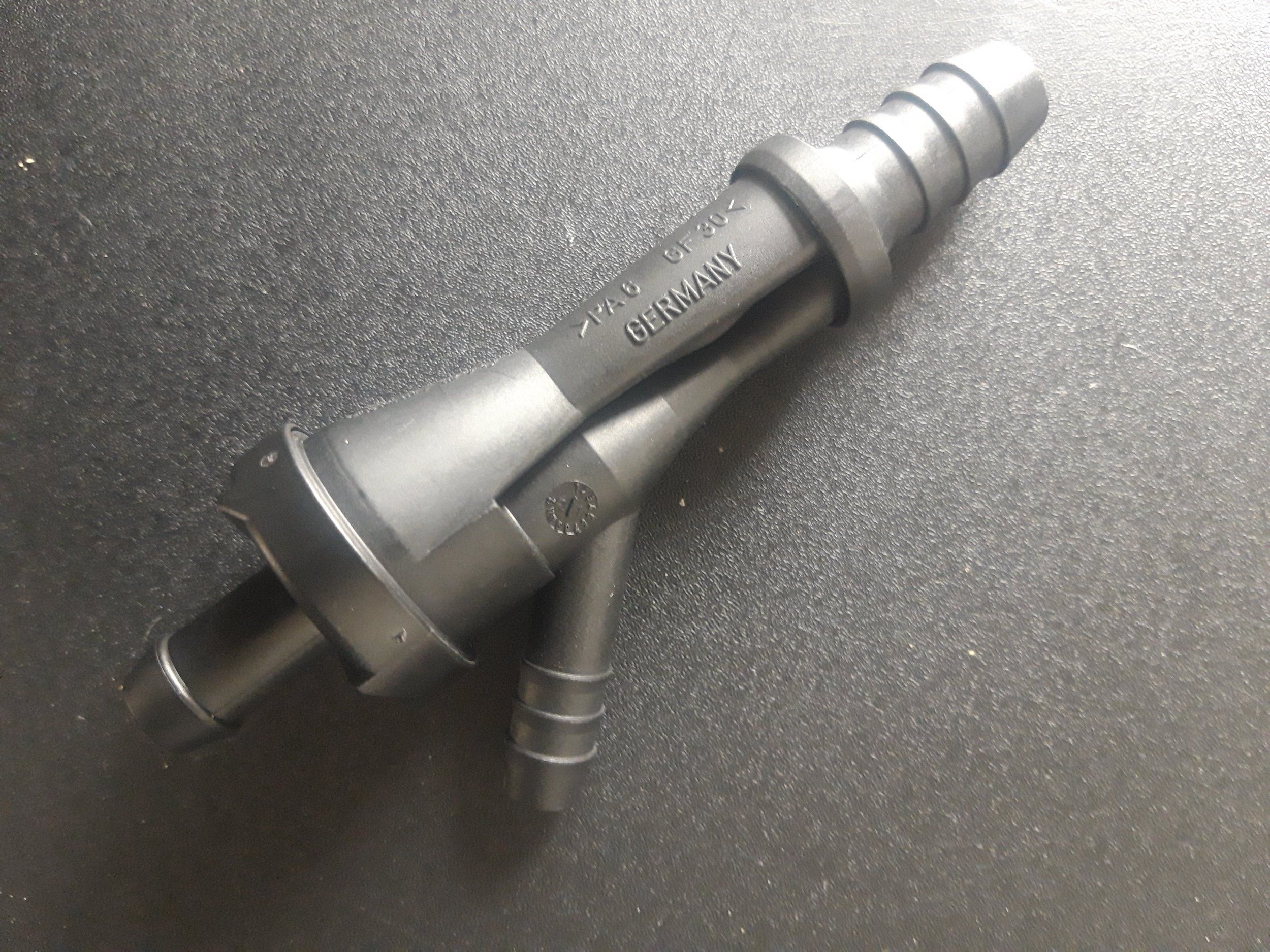

Its working when i suck n blow on it. But when it shuts off it isnt totally air tight but definitely functioning.
So, the post above relates to a valve fitted into the pcv system that im refitting to my car as i cant get on with the catch tank setup.
Wasnt convinced that when i sucked and blew on one of the pipes that the valve shouldn't fully shut off and ordered a new one from TPS.
Turned up today and gave it the suck/blow test and the new one fully shuts off.
The moral to this story is, if your running a standard system and your not busy spending money on door locks, window regulators and butyl tape you should buy one for peace of mind.
Rich
Rich
What's the part number for that Rich?
