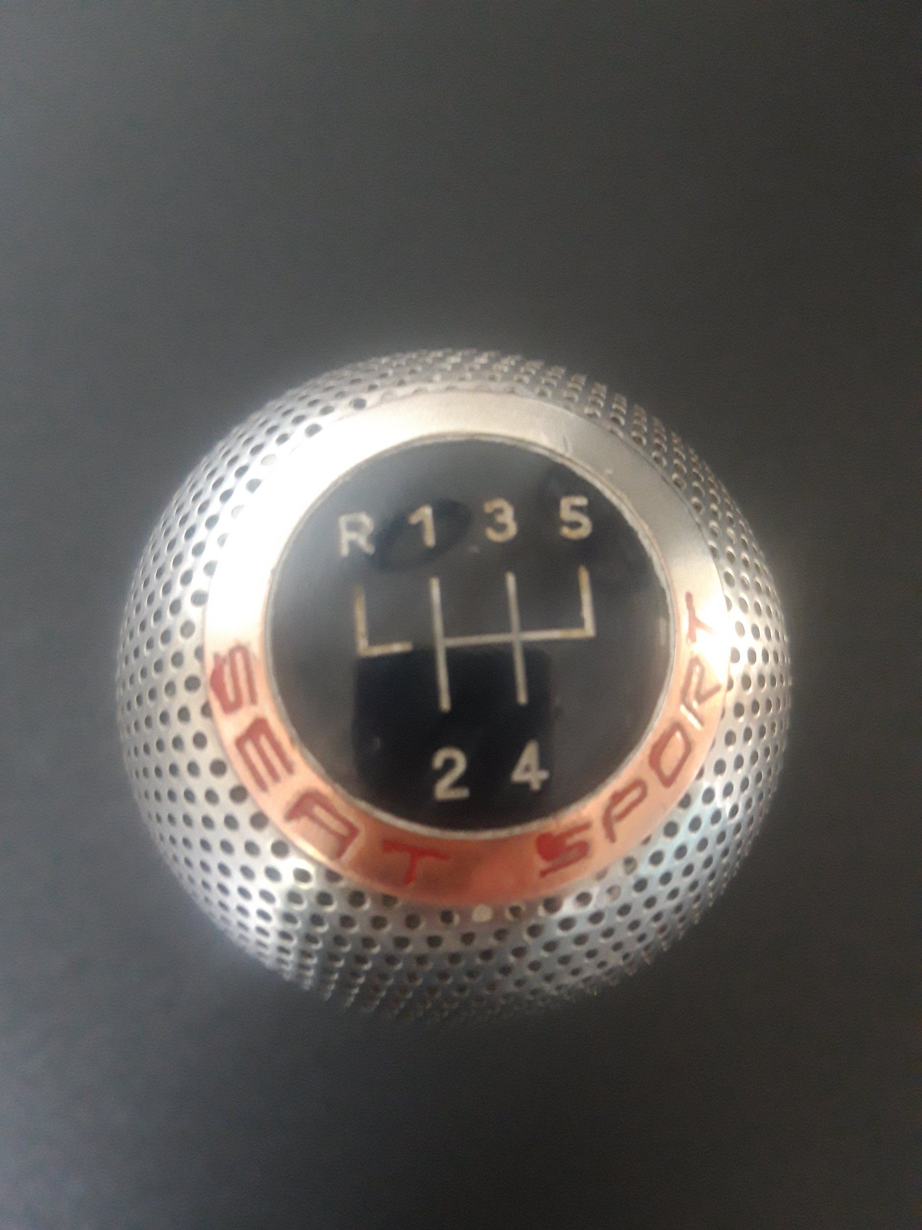

The gear knob that i shouldn't have bought has turned up.
Not sure what to do with it now.
It has been used and didn't notice in the ad that the chrome ring is worn.
Whats the ring made out of? Looks like copper/brass?
Do these knobs come apart easily enough?
Thinking zinc plating?

I'll stick it in the drawer for now and come back to it.
Have some time to ponder on it.
Did see these on Ebay though. Cheap enough to sacrifice.
Maybe next month eh?
