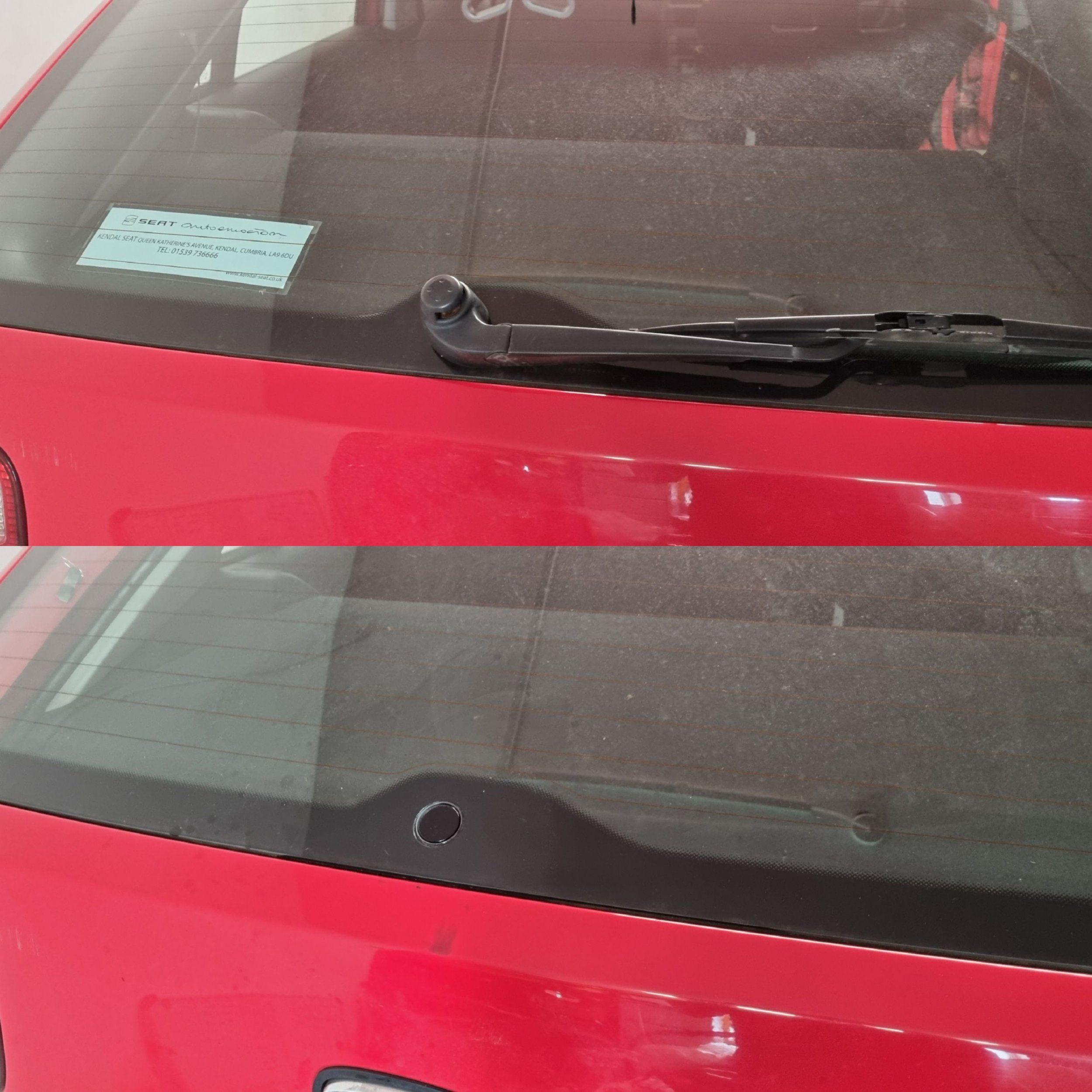

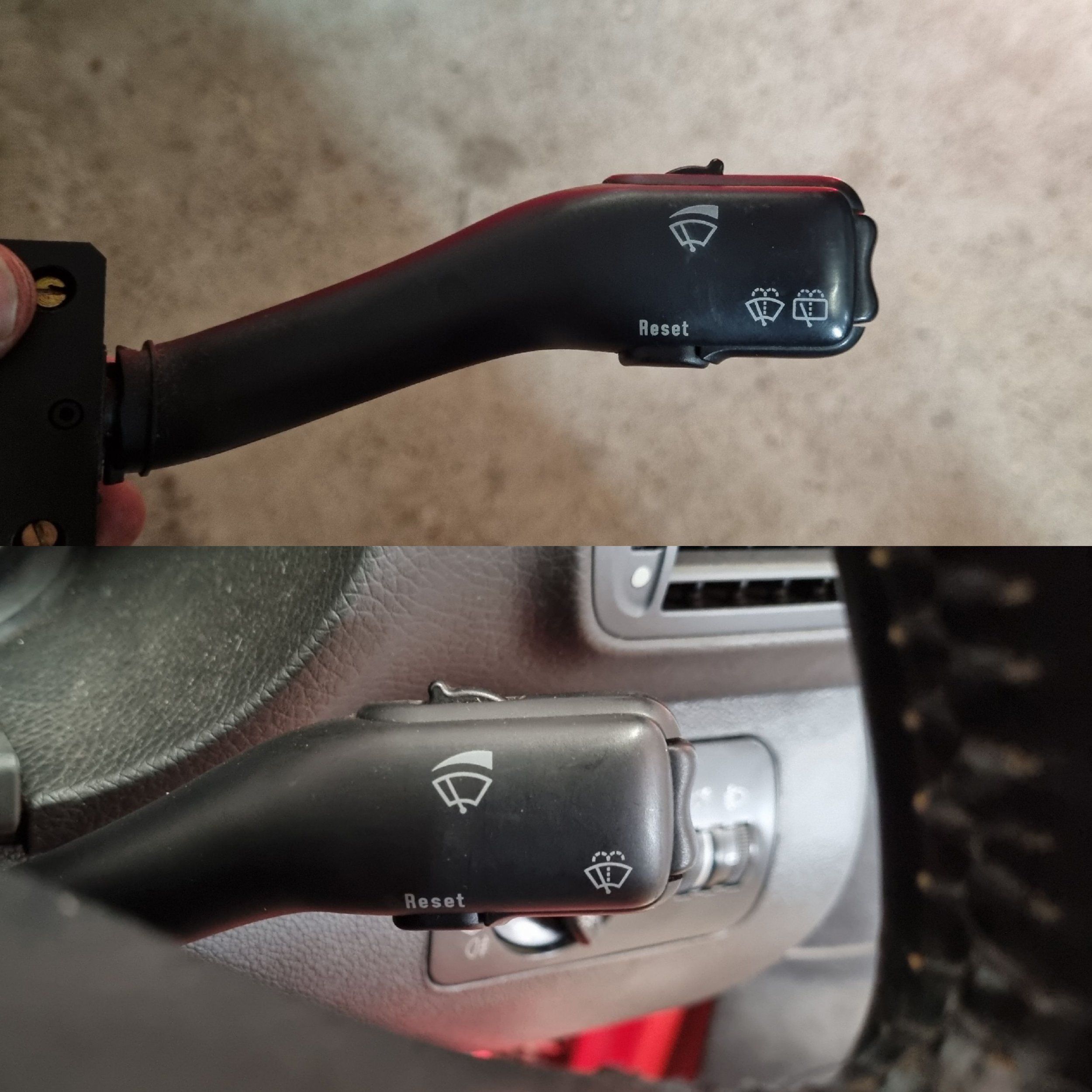

Did a little work
This is probably the least important thing on a big list to get done before a road trip but hey, at least it's something ticked off.
Just... reroute some switch wiring, replace wash/wipe stalk, tidy up wiring, finish installing the seatbelt buckles, maybe do the solid top mounts and tweak the tracking to do in... about 24hrs.
No pressure
