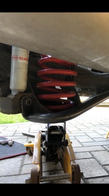

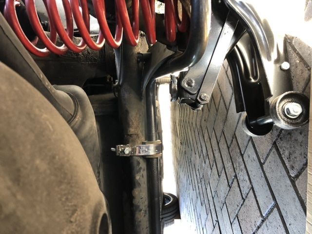

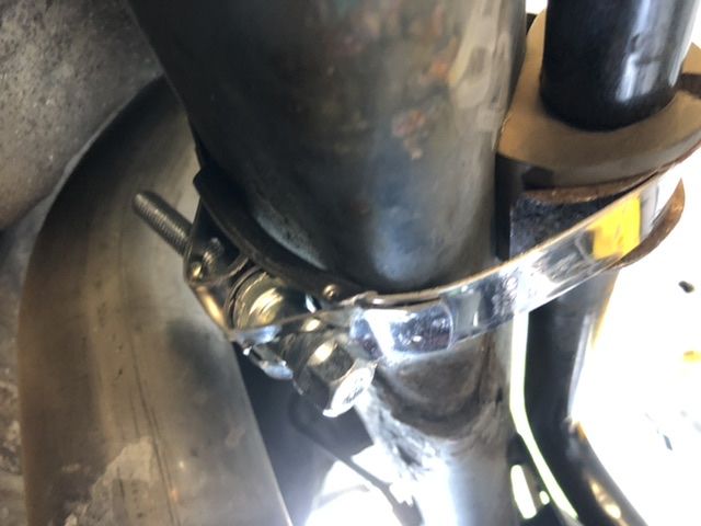

Here are some pictures of the clamps I used on my h&r roll bar. I think the clamp size I used was 97-104. I think I had tried the next size down and failed to get the bolt to locate and tighten.
You’ll need longer bolts for the lower shock fixing.
I don’t know where you’d get the rubber bushings from.

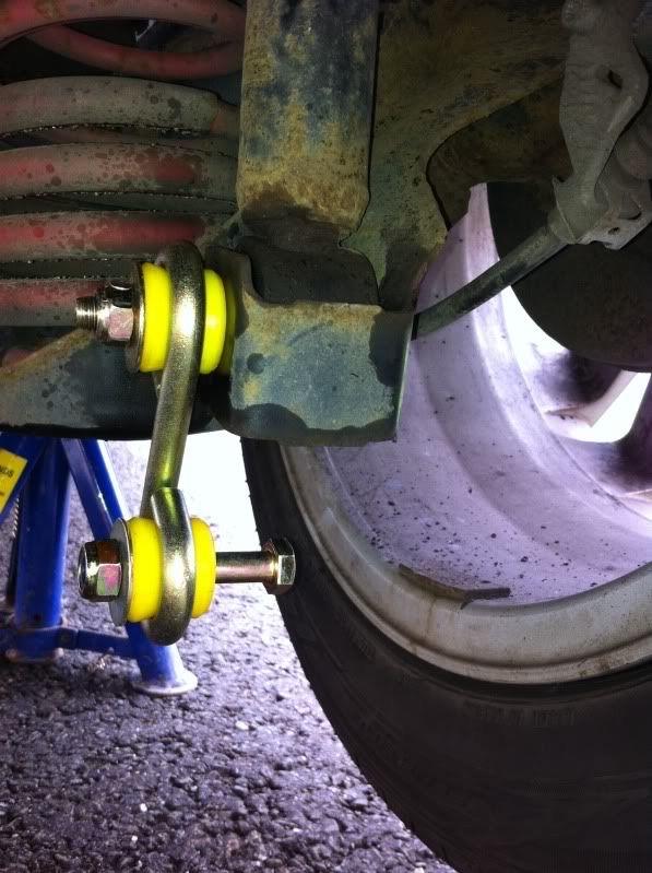

I assume yours looks like this, so just longer bolts required:

No drop links, just bolts through the damper mounting. You can try the stock bolts if you like (may just fit) or order slightly longer ones. Bushes just need metal straps round and tightening up to hold stuff in place
