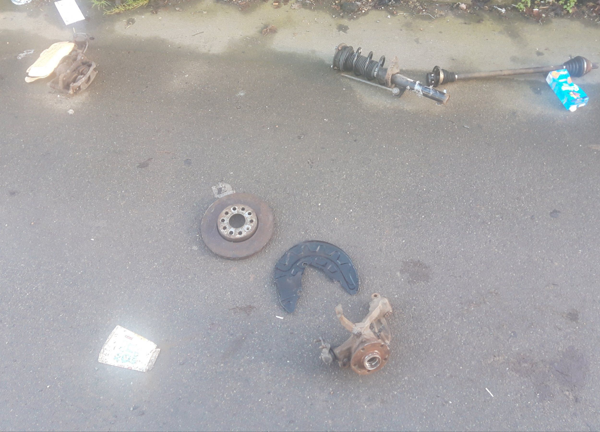

In all honesty, I'm amazed there wasn't any damage. Me driving probably less than 500 miles last year probably had a lot to do with that though. I just see this whole experience as a massive dodged bullet - my wheel not falling off being the first, and the second this garage being honest enough not to bend me over and charge me hundreds for doing work that didn't need doing.
I'm so tired of crap garages. So, so tired. How is it some driveway mechanic can do a better job on my car than a bricks and mortar garage?

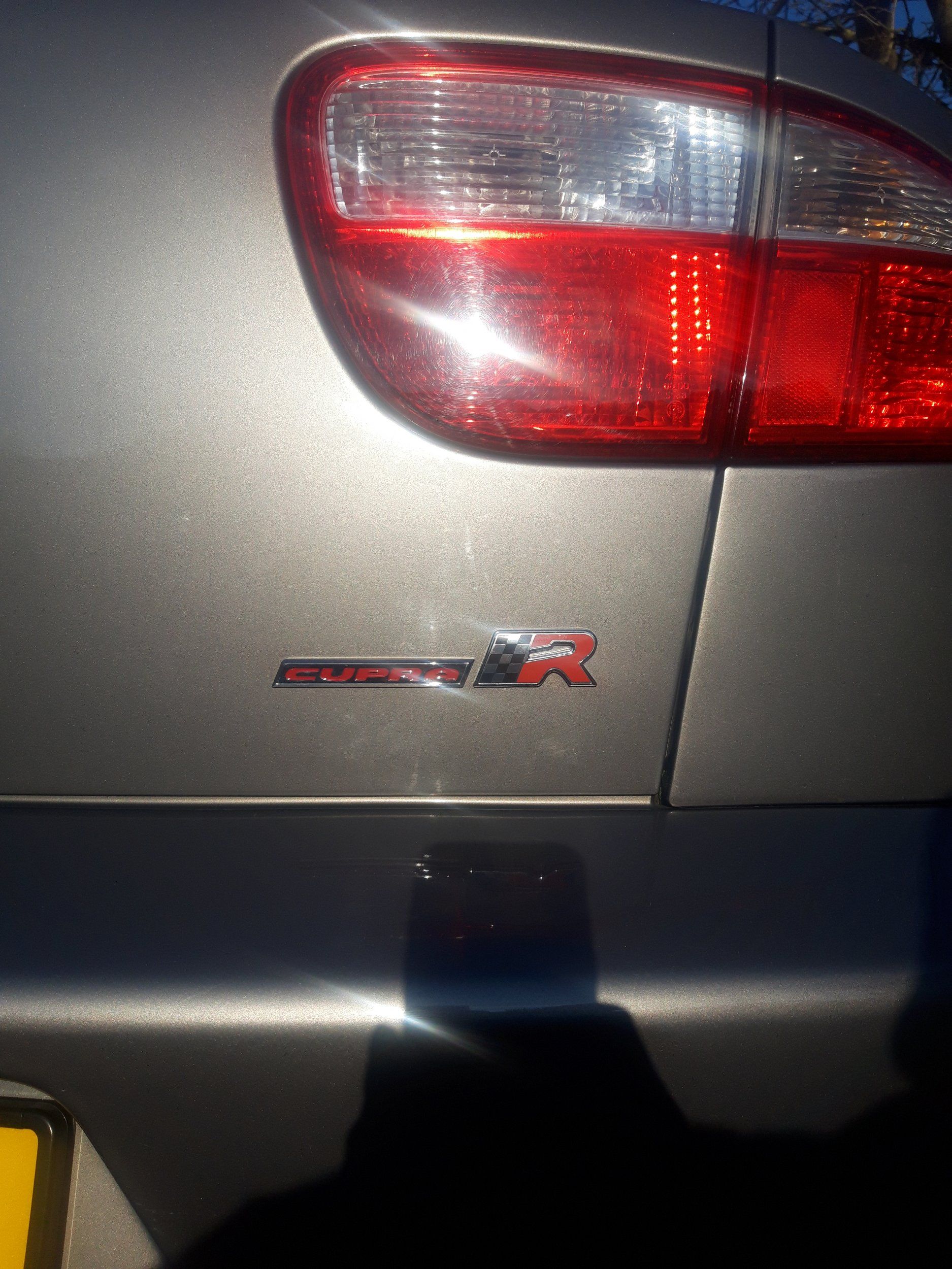

Fitted a new badge.
Thats enough maintenance for one day.

If I weren't so bad with conflict, I'd have gone to the garage to tell him how badly he could have ****** everything up, but after a year, it would be so easy for him just to say the nut had come loose on its own or something. I remember the wheel being wobbly when I had my MoT last year because I mentioned to the tester that it was the only one I'd ever had changed and so it seemed weird that it was going.
The stupid thing is that I do work on my car sometimes and I'm wondering if I should be taking it to a garage instead, in case something goes wrong, but the reality is that taking it to a garage is no guarantee of safety.

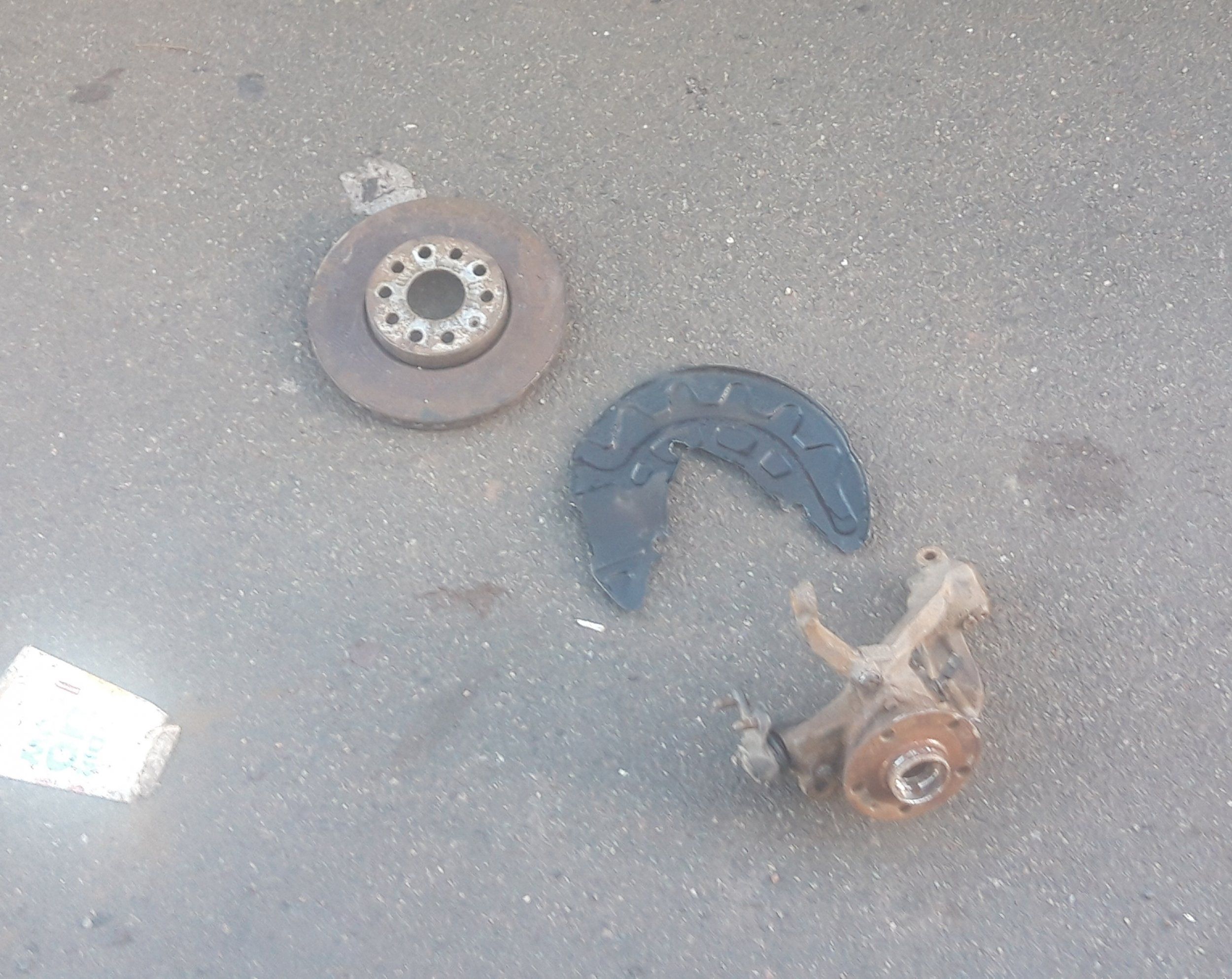

I'm guessing what the other garage did was to take out the driveshaft so they could get to the top nut of the ball joint, rather than get the control arm off by undoing the three bolts underneath and sliding it out. So when the time came to put the driveshaft nut back on, they just noisy gunned it rather than torque it to spec and it wasn't even on properly.
When I've been working on the car this past year, I've been looking at the nut thinking it looked off, because there didn't seem to be many driveshaft threads visible and there was what looked like plastic or something sticking out one side.
Fair play to this other garage though - they could have charged me £250 and say they changed the bearing but they put a new nut on (when, as always, I have one at home) and charged me labour.
All seems fine now. I won't know until I next get the car in the air whether there's any play, and I hope they put the disc retention screw back in (little details like that are important to me) but it drives fine and means I've got more money to replace my boost pipes now.
And get this - they used copper slip. First garage I've ever found where they didn't go in dry.
It is a bonkers design that won't let a ball joint clamp get in there.
Bodgers (& me!) just unwind the ball joint nut until it stops hard against the CV joint.
Then keep going until either the ball joint pops or you brinell your wheel bearings and the ball joint pops.
Unless you absobloodylutely have to replace the ball joint, as said, undo the three M8 bolts.
Else you enjoy a really lousy time.
