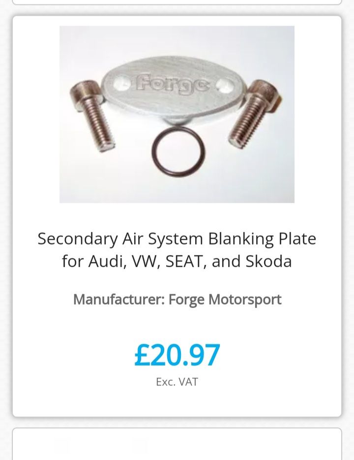

Whats this do?
Been looking on the Forge site for stuff i don't need and came across this. I dont think i need it and wont be buying it but what does it do and where does it go?
Cheers all.

On some models (not the R) there is an air pump that blows hot air at the cat on startup to warm it up. When it fails (they all do) you can pay £300 for a new one, or stick a blanking plate onto the hole.
