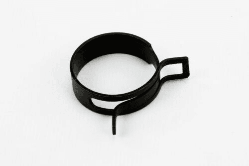

I did post that battery a while back you may of saved it, did the pipe have a crack in it seems odd , on engine side mine had a spring hose clip i removed that but hose was tight so i did not force it off did yours have that clip
look like this
look like this
Sounds about right about the battery - it's been on my watch list a while, so it wouldn't surprise me...
I've seen some photos of the engine where that clip is missing, so it doesn't seem to make a massive amount of difference, but I still had mine so I kept it on. I wasn't able to get that side of the pipe on completely flush, but it seems plenty secure in the meantime.
