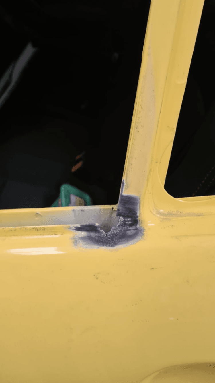

The lad in the paint shop sent me these photos.
This was under the rubber on the near side rear door.
He’s built it back up now, rust treated and painted.
Should be getting it back after the weekend.

Odd place too rot, that premixed fibre glass filler would work well there after metal treated, it sets rock hard
That’s what he’s fixed it with. He said the same it sets rock hard.

i thought the same but when i removed the rubber it was the spring steel insert that was rusting in the rubber, hard too find now there attached too the small window, make sure he treats it well the rust looks deep in, you can get a chemical for that and a rust inhibiter undercoat, if you ever take the inner door card off i.e the dam lock lol i would waxoil the back of the door or something similar

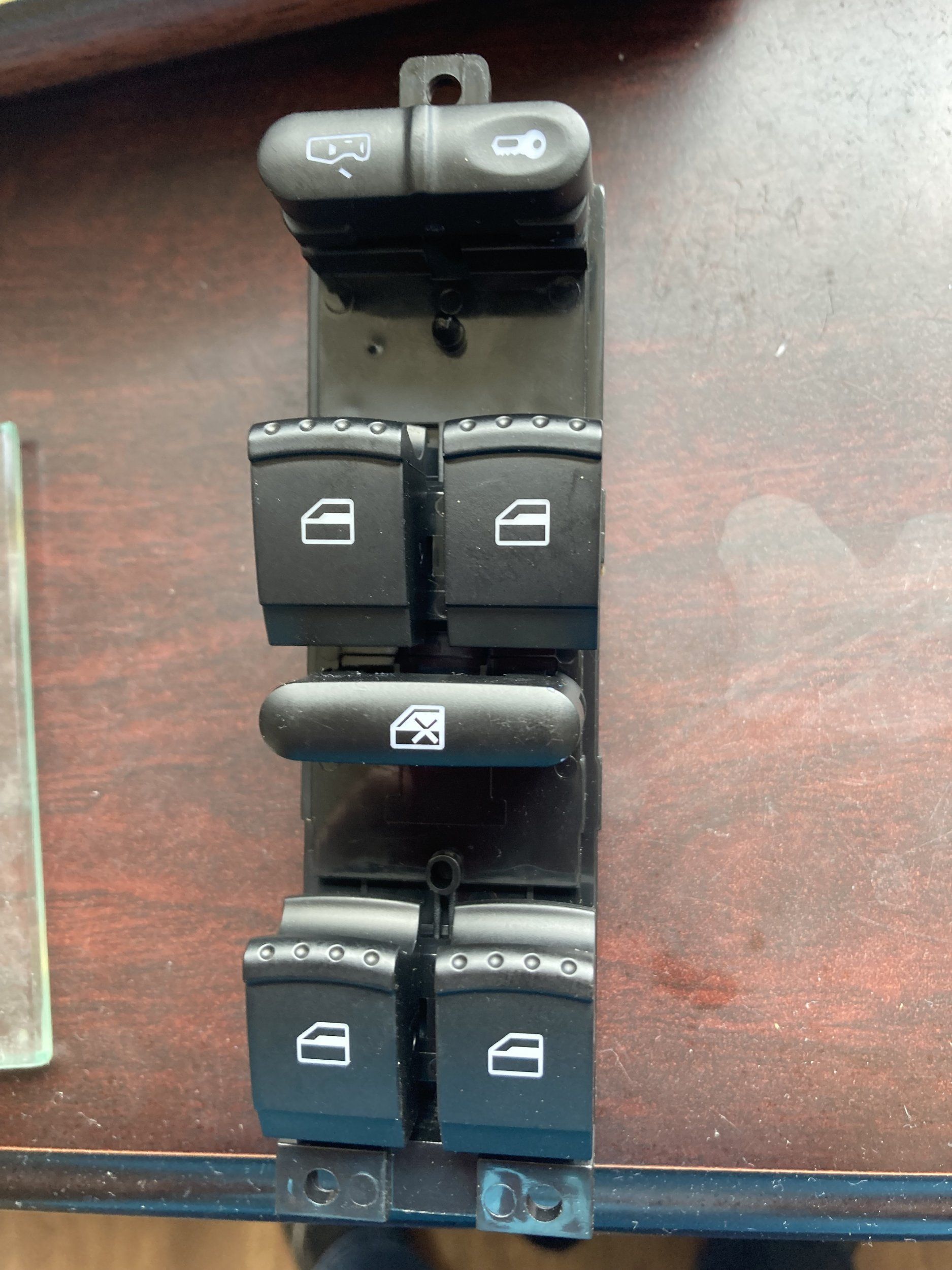

Master control unit replaced I did fix it but issue come back £6.70 from alliexpress, new cap line from same place £1.98 delivered and a new power steering cap as that cracked £5.70 from same place, you can get them from eBay but I bet they come from same place chi-na and there allot more, they have definitely sorted that place out since brexit as it wasn’t worth buying from there, not the case now also delivered in two weeks.

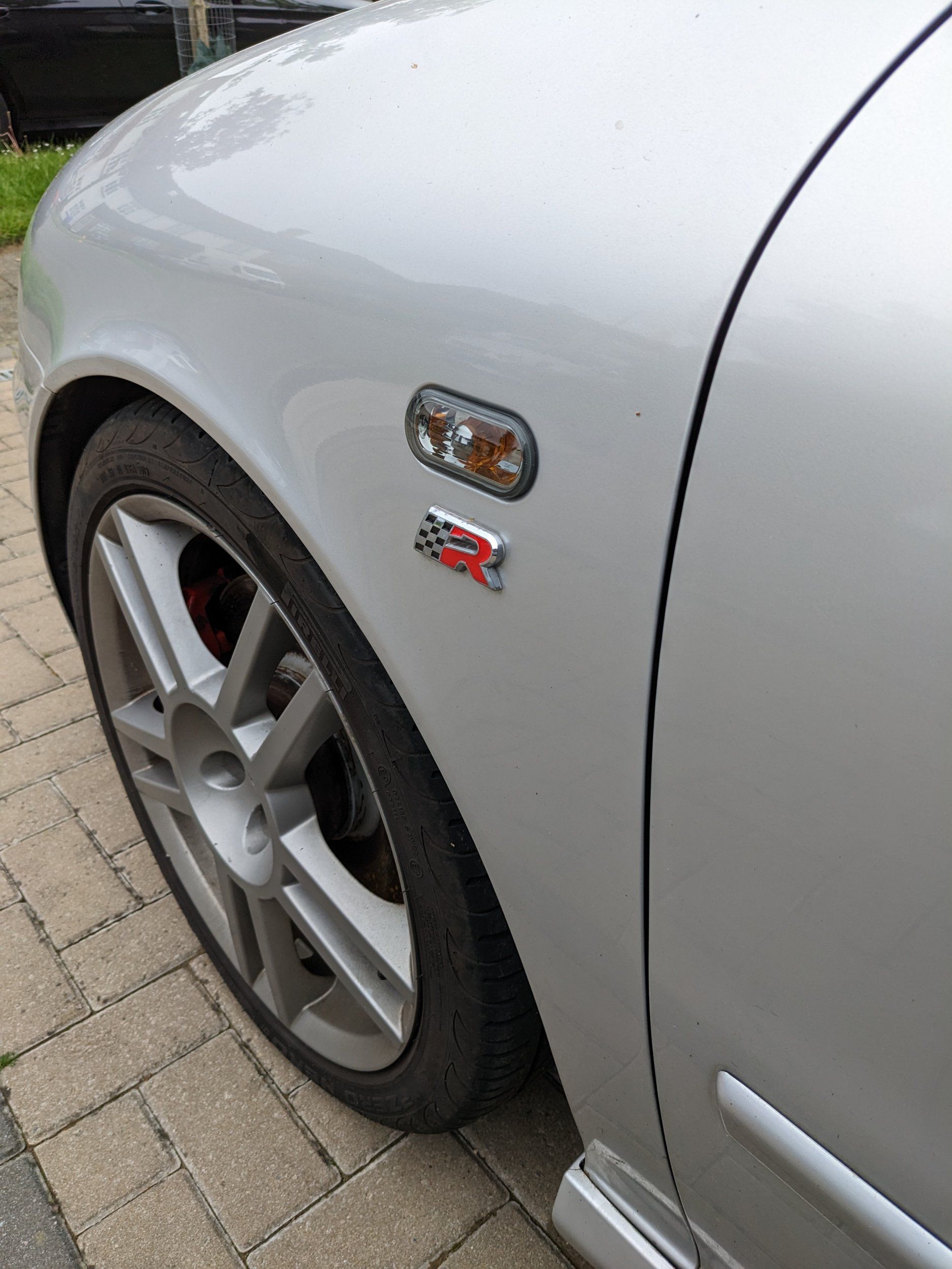

I changed the side indicators as they were water ingresses. Couldn't find the one which take the twist bulb fitting so bought the SEAT EXEO ones which are slightly smoked and look really nice
