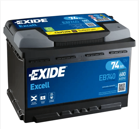

So, monday morning drove to work and late afternoon my battery was zombie (at around 30% charge level). Even with cables and a friend car's juice it was a no go. Ending up leaving the car there (was a parking garage) and got back yesterday with my dad's battery just to check if it was a dead battery or the starter before buying a new one. It started ok so I have to spend on this:
I guess it is ok for Leon 1.9 TDI right?
Best regards.
Is it a lot?
Best regards.
looks good , i ended up getting the Varta silver Dynamic a while back from here https://www.tayna.co.uk/ put your reg in
