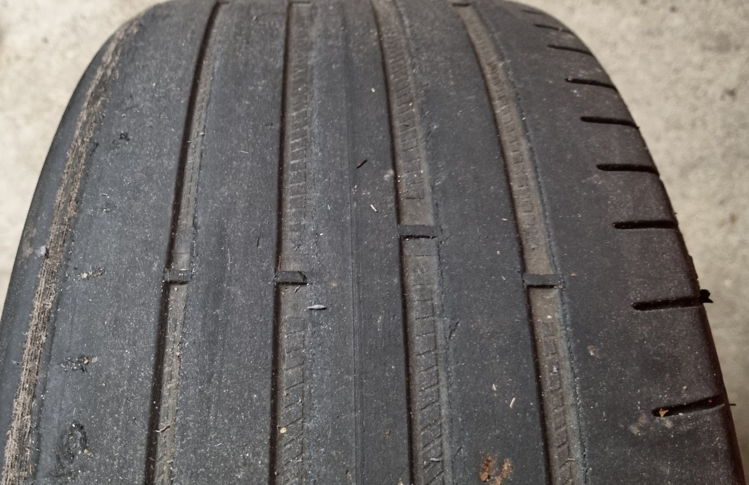

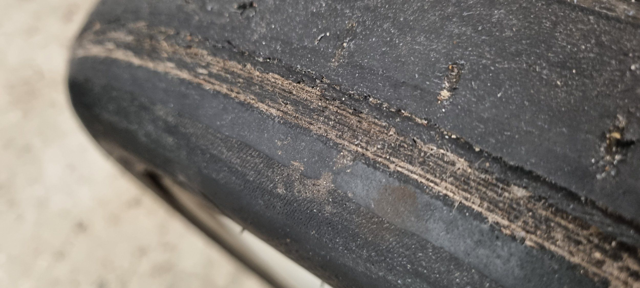

Looking at your tyre wear tells you a lot about your suspension setup...
See, good suspension settings mean even wear across the whole w...wait a minute...
Ok, so we learned two lessons here. 1) I may need a tyre with a stiffer sidewall (this is the outer edge) and/or a degree more static camber. And 2) Yeah, may be an idea to check all the way round the tyre instead of cursory glance when parked up ??‍♂️ (only worn like this one part of the tyre, not the whole thin)
Have all 4 wheels laser tracked i had this done when both front ball joints were replaced as i was getting 4 new tyres just in case that happened.
Yup! That is my fronts when the toe is slightly out.
I can't say my Leon is ever gentle on tyres, even when everything is bob on.
And also the rear twist beam setup dates back to the first golf in the mid seventies.
Tyres were much taller then & less bothered with the camber changes inherent with that set up.
The wider, lower tyres of today don't enjoy running with camber.
Are those Goodyear Efficient Grips? they do love to roll off the shoulders if the toe-in is a smidge out.
