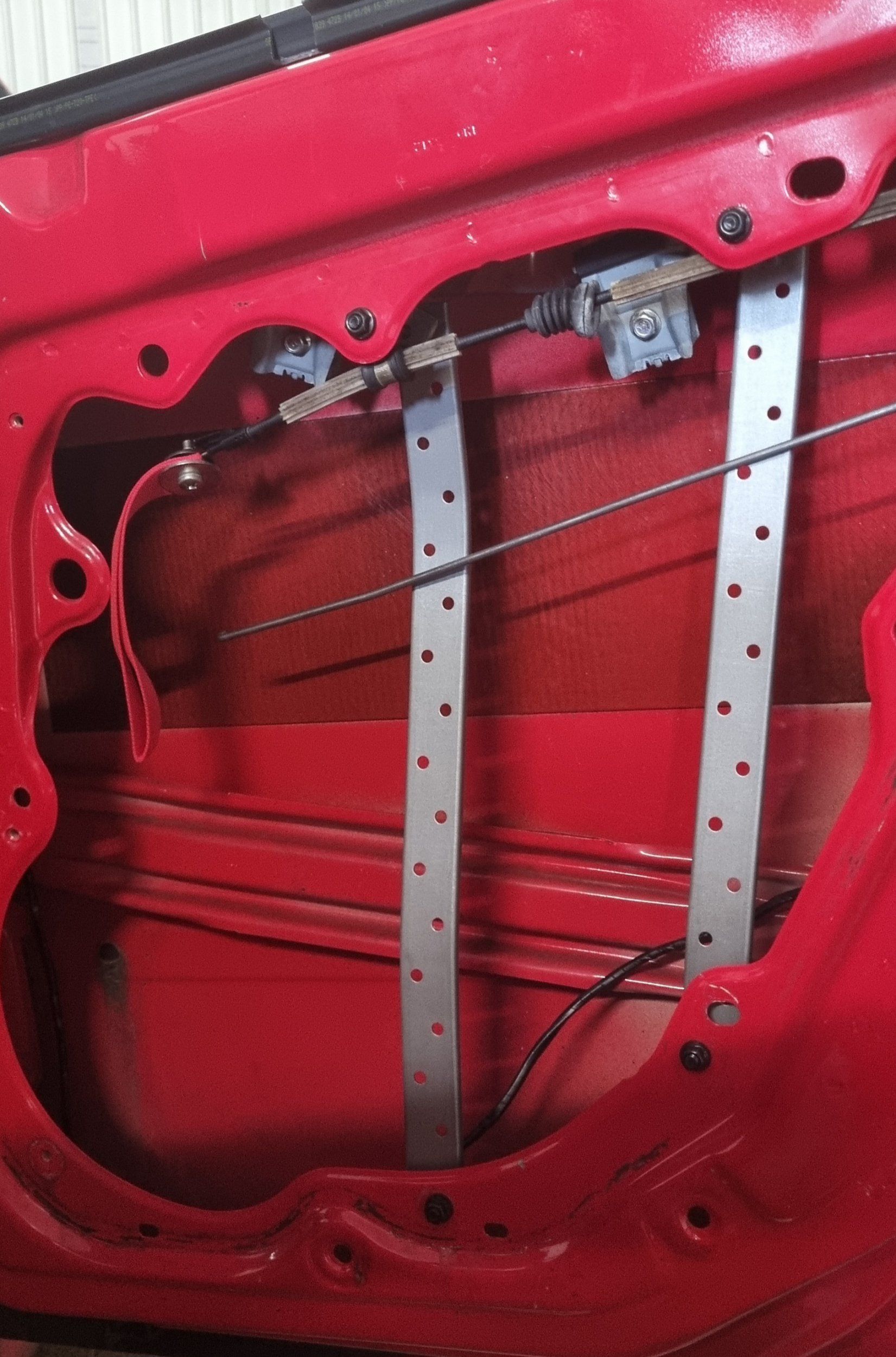

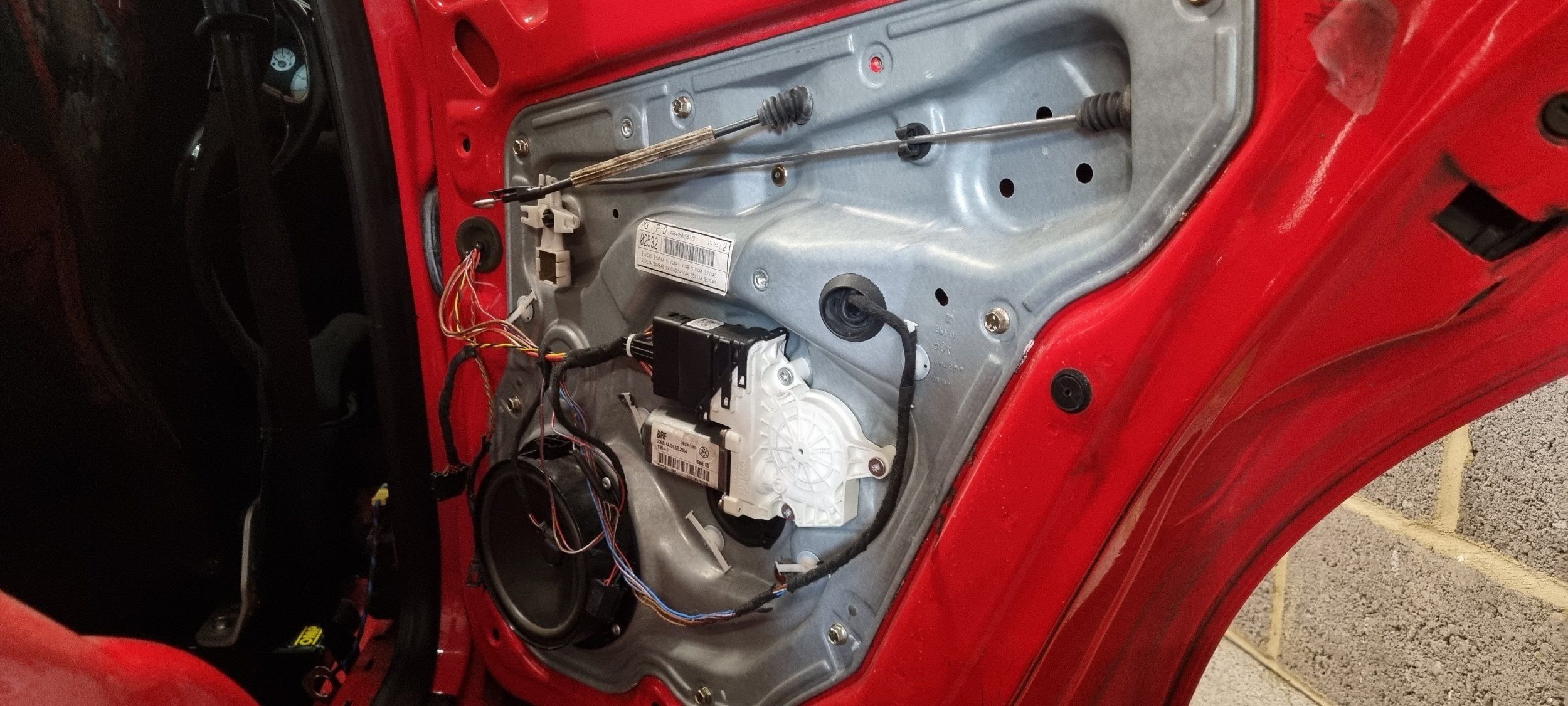

You'd know the answer to this - how on earth do you get the window out? The seals are all connected to the one that holds the rear window in place, and I really don't fancy breaking either the seals or the window.
The rear quarter glasses actually quite simple to remove and yes it's integral to the rubber frame and door lip seal.
You can prise the rubber lip up from inside whilst pushing the glass panel outwards.
Sent from my SM-S906B using Tapatalk

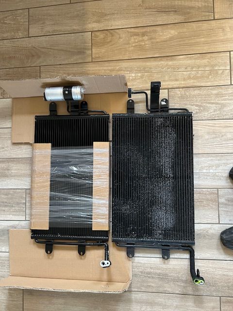

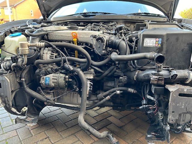

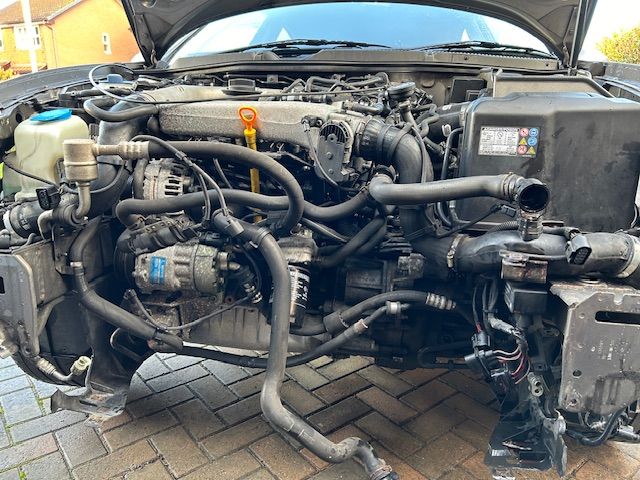

Looks like it could be bad news. Now I have the rad pack off, the new a/c condenser is physically slightly different to the new one I have. Could be a show stopper. I’m going to have to review part numbers tomorrow morning.
Noooo, that is a major pain in the arse you really don't need. I'm really sorry to hear that mate, I hope today brings fresh hope. ?

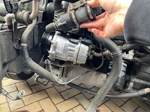

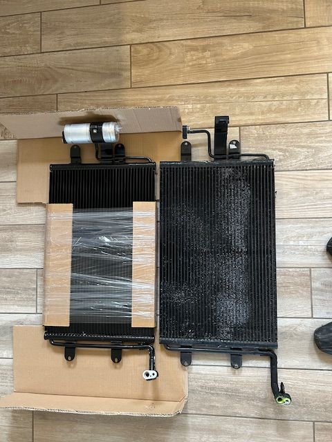

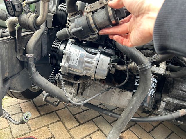

I’ve had to order a genuine condenser from Deutsch parts. Hopefully will have it by Tuesday if I’m lucky. Photo below shows the issue with the Mahle part I have. The a/c connection position is quite different. Annoying because I used the Mahle part catalog to buy the right part. Even their CAD diagram reflects the correct position.
Anyhow, I’ve swapped out the compressor and have put the job on hold.
View attachment 38972Anyhow, I’ve swapped out the compressor and have put the job on hold.
Fingers crossed for you ?
It is so frustrating when you are on a a job, you've done your homework, planned it all out & the part just ain't right. It will be worth it in the end though ?

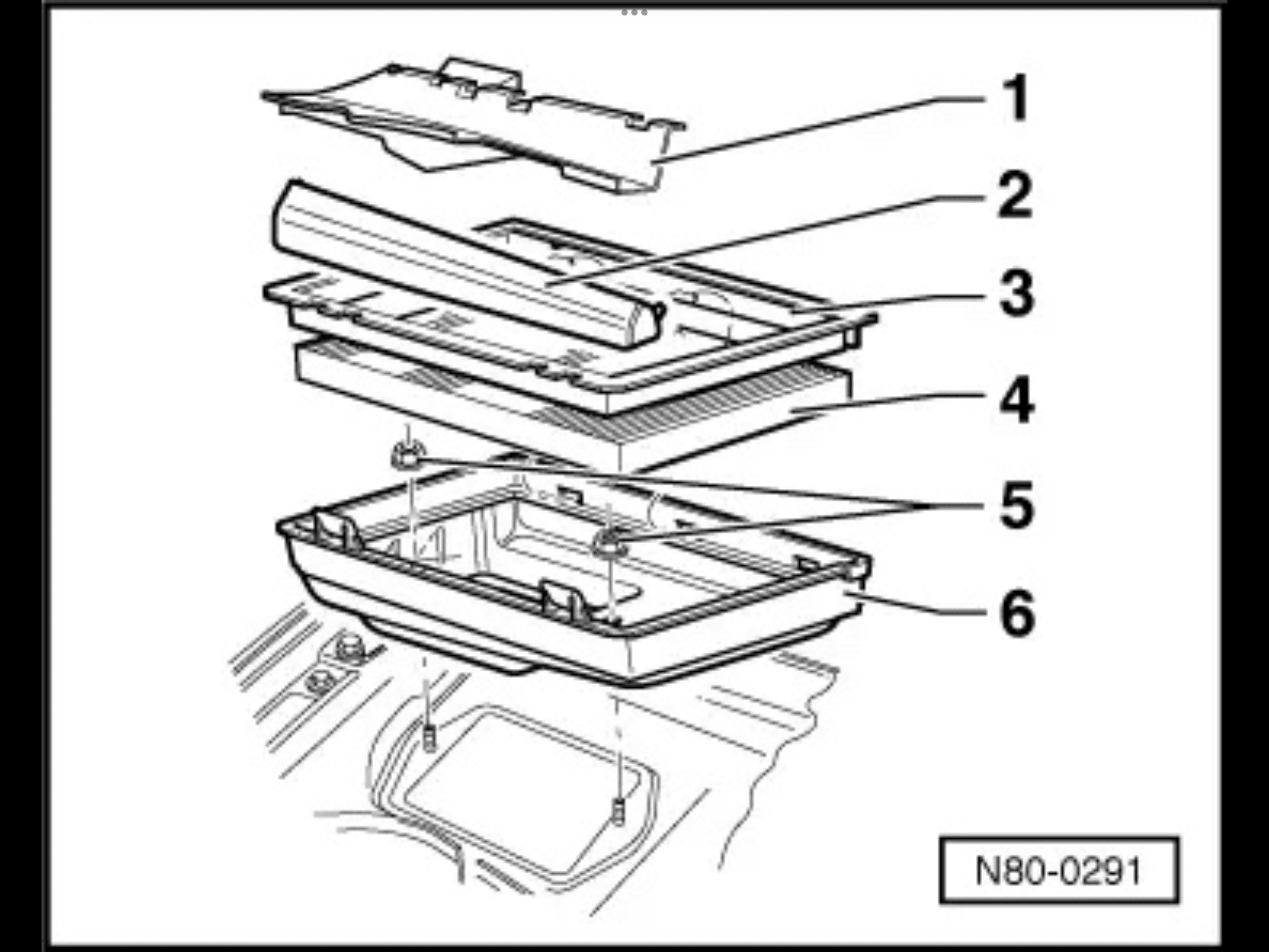

remove the cowl panel that's just as bad and I've done it before to flush the jet washers out when i first got the leon, and recent to seal the pollen filter box, your like wtf lol
I got down and dirty (there's no choice when it comes to that job) with that a couple of years ago when the seal failed around the main wiring loom and my washer jets kept clogging. Ended up cleaning everything - scuttle, hoses, washer bottle, the insides of the wings... I was amazed there wasn't any rust, given how clogged it was.
Looking at the pollen filter side, I know I'm probably going to have to do it all again, as there's a load of sycamore seeds merrily rotting away under the scuttle.
Love how SEAT thought a 2p sized slot was going to be enough to drain all the water and leaves...
Reactions: Nam-uk
seal the bottom of the pollen filter box with butyl tape while your at it the foam on mine was going all like the doors, its defiantly sealed now lol
