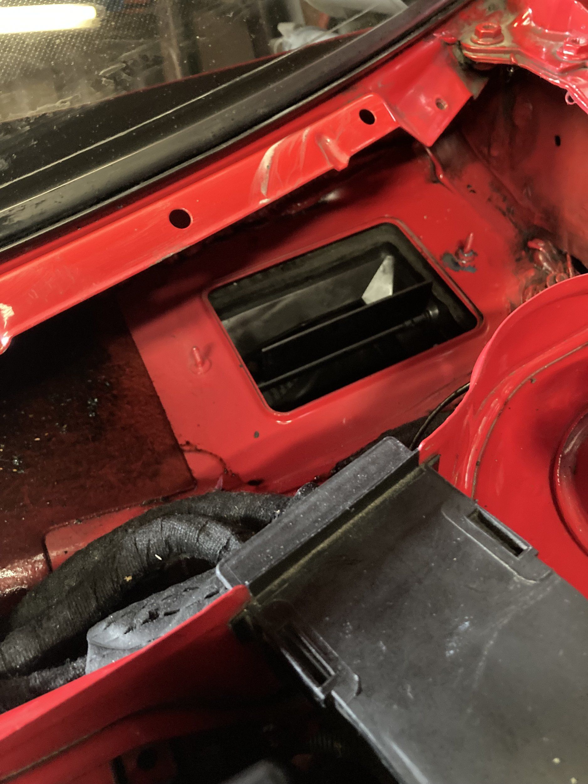

Welp, after todays weather unsurprisingly there's water making its way in. Somehow it's not through the door, it appears to be coming through the scuttle panel.... again
Ok I had this years back. It’s most likely the drain points either end of the scuttle area.
So where your pollen filter is. Beside this and further in. ( into the corner. )
All that fills with mulch from teees etc. there are drainage holes there too that drain to the arch. Get in there with coat hanger etc. get all **** out then pour boiling water in and drain holes will clear. I never had a problem after doing that. May have even done a thread on here years back.

Nooo, after all that trouble.
I sheeted down my Cupra a few weeks ago, but moisture is trapped in the car, so time again for dehumidifier packs.
UK weather is very challenging for these cars & their owners.😎
Is it the weather or the design of the cars?
I mean, there's only so many times I can be arsed to remove wiper arms, lift up worn out plastic, try to not break the next bit of plastic, skin knuckles trying to unplug the harness, see how many swear words can be said trying the get the wiper mech out of the way before topping up the butyl tape that clearly wasn't enough last time 😂😂😂😂
Refitting is the reverse
At least I don't have carpets to be a problem 😄😄😄

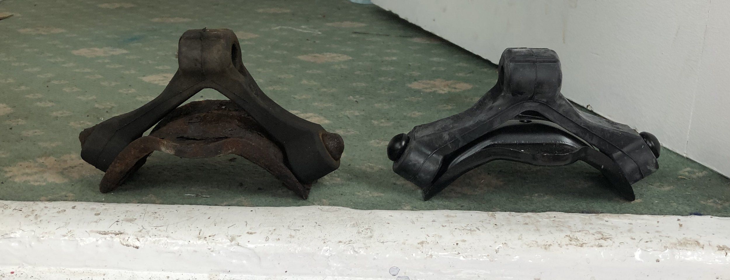

Exhaust is hanging low because the rubber on the hanger has stretched. Took me all morning to get the corroded farside bolt out, but did it in the end.
£14 for two replacements o_O

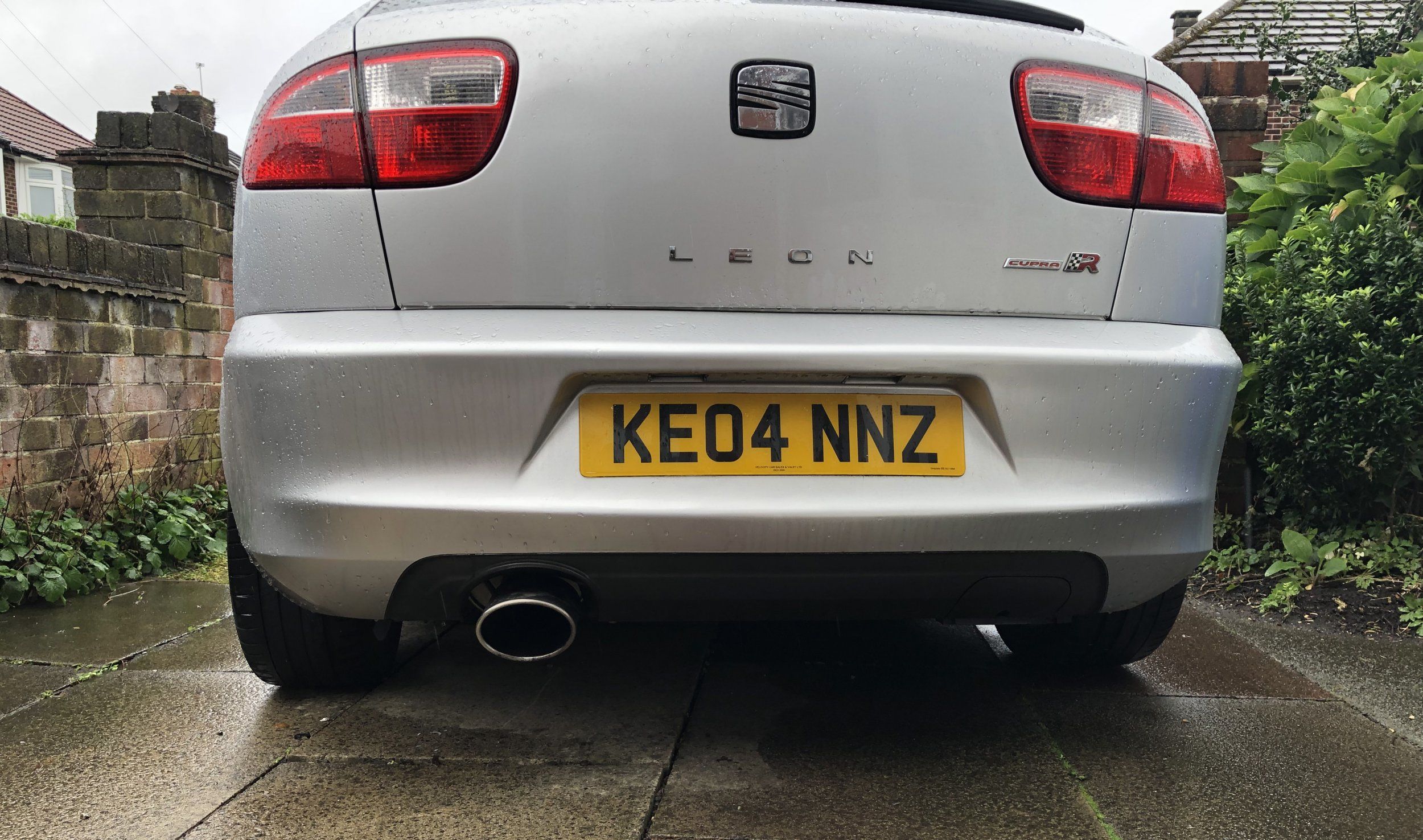

Replaced the exhaust hanger. Looks original and you can see how the rubber has stretched. Tip now sits a bit higher, although it's some sort of custom job so it'll never fit quite as well as a Milltek or a Cobra.
