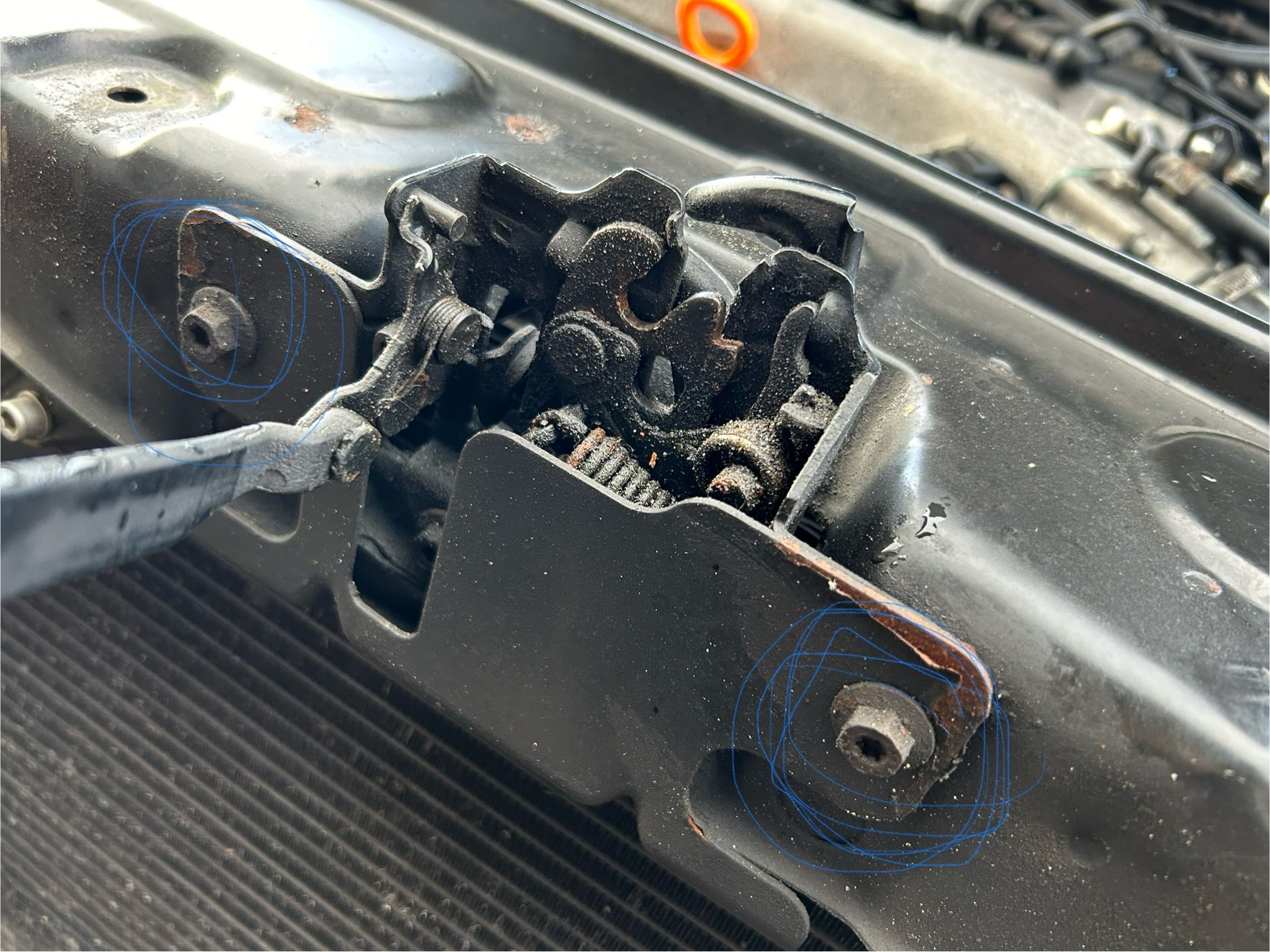

I think I've found what was causing the knocking sound. If it's not this, I'm going to bin this bloody car. Duct tape shouldn't come as standard, right?
A free afternoon gave me a great chance to strip the old door. Doing this makes me feel a lot more confident if I ever need to do anything to the rear doors. It's way less stressful when you don't have to put it back together again and it doesn't matter if you break anything..
Made sure to keep some spares.
Door is available, by the way. Lacquer is a little ropy but it's totally fine. Free bonnet too.
It's mostly straightforward - drilling out of the old regulator through the metal is a bit of a pig, but you just have to persevere.
Getting the peg into the glass once you have inserted it back into the window regulator - that is the impossible bit.
And how I ended up in a world of pain following YouTube "just put the peg into the glass beforehand and push it into the regulator" videos.
Best advice now is the remove the speaker (which is riveted in) and use the space to get your hand in.
I had to put a peg in a few years back when I discovered the garage I got to change the lock on the other side hadn't replaced it. Because the window wasn't in place, I arranged it all so that the regulator was in the down position, but the glass was free. Put the peg and dowel in place by reaching under the door skin, then pressed it together using plumber's grips, before pushing down on the top of the glass to clunk it into place.
I think when I closed the window, there was a massive bang when it seated itself properly. I believe I may have soiled myself when that happened.
Reactions: MoToJoJo
Dam sight easier reming the speaker before that I used long nose pliers but was a faff,
On the later VW you could unbolt the outer skin too get at the lock and window, great idea that and vw must of done that to make it easier for them on service

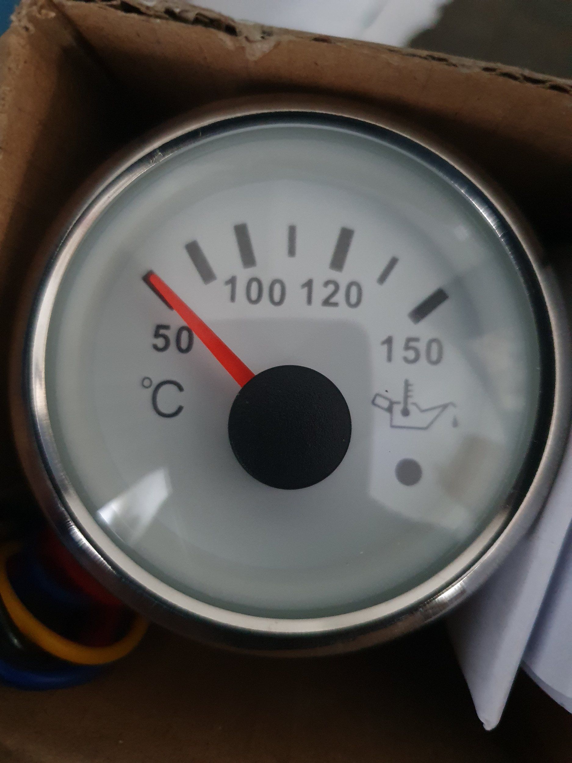

Going to install a oil temp sensor soon which matches perfectly with the topsport cluster, red backlights, white background, analog needle, simple oil temp icon :)

Yes, remove those bolts and plate. Then there's another single bolt holding the latch in place.
Withdraw the latch and you see where the cable hooks onto the latch lever so it can be detached.
You'll also need to unplug the latch from the slam panel loom.
Sent from my SM-S906B using Tapatalk
Thanks cable is released now!! 4 bolts and I should have the front end off!!
