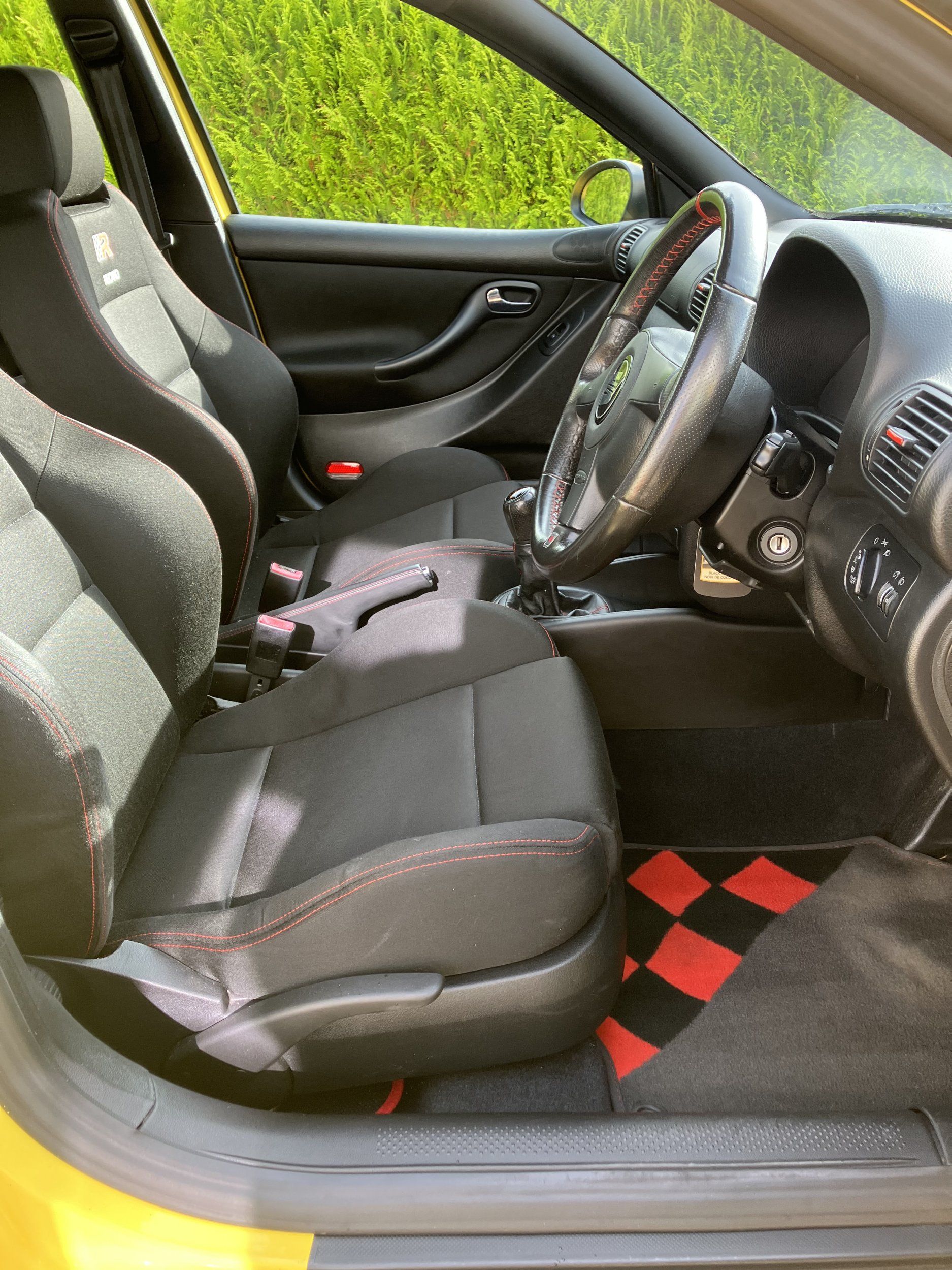

Gave it a wash, put it up for sale.
In my favourite colour too. Someone's gong to bite your arm off at that price.
Girlfriend wants me to get an A5 - and the diesel gives her enough car sickness as it is, so don't think I'd be able to get that by her.
If you've still got it this time next month...
