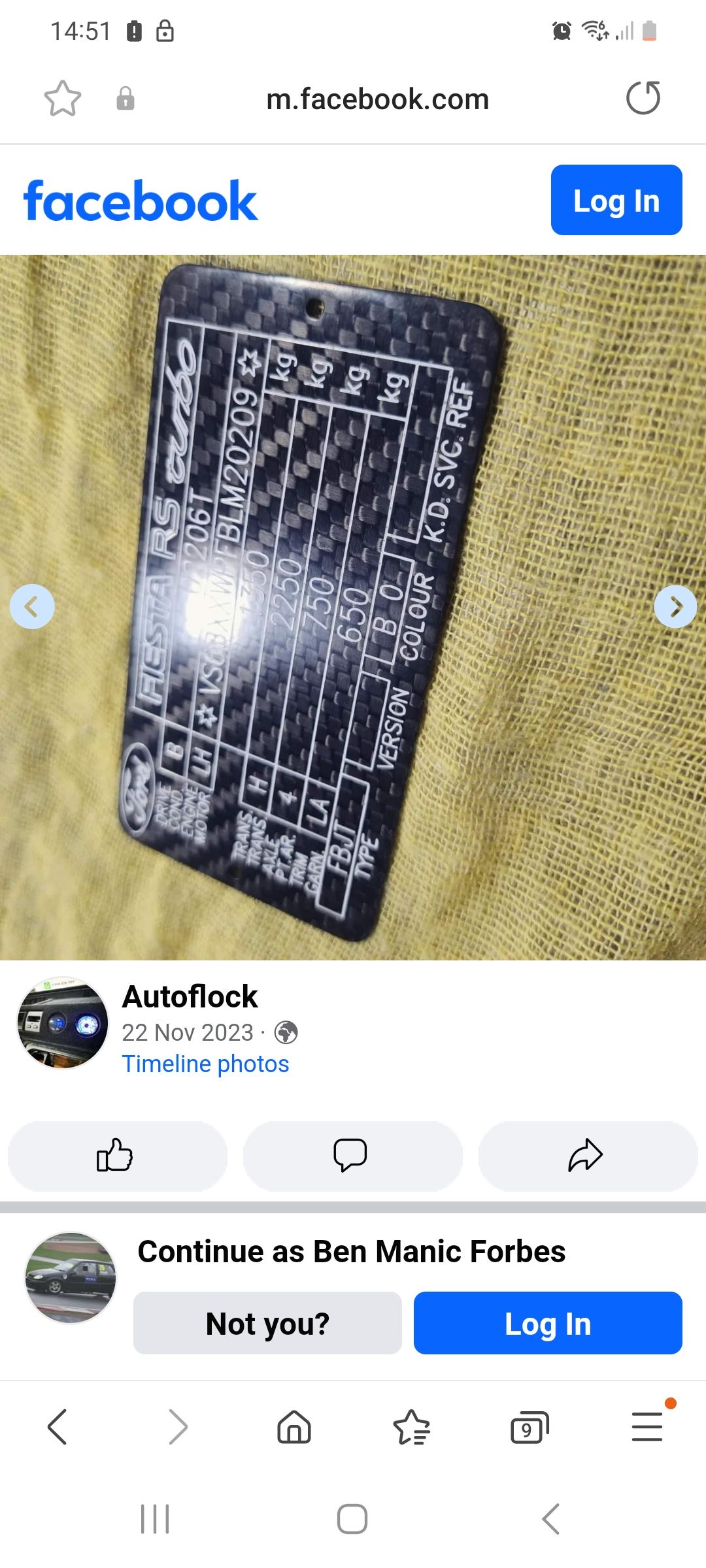

Found these on a site on Facebook. I think they look quite good. Was gonna get one made for leon when it's built.. what's people's thoughts
