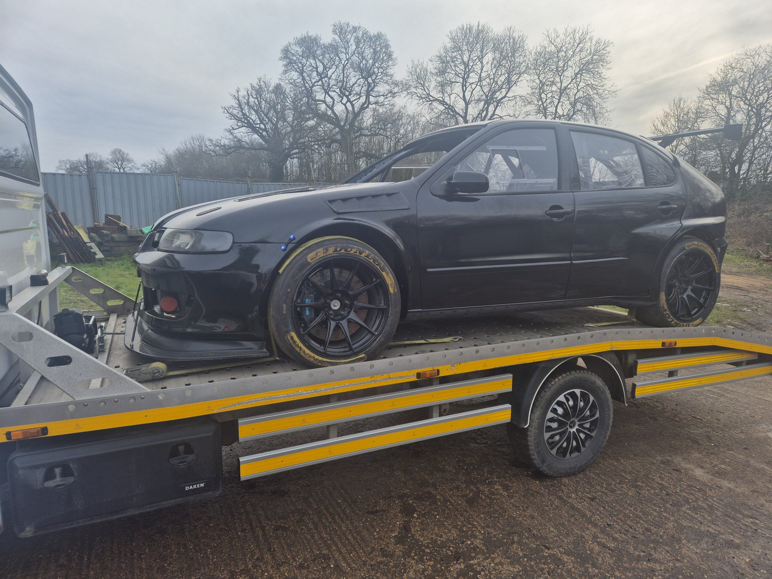

Evening all. Do many people here watch btcc... well in June at brands hatch there is supertouring power 3... basicly late 90 early 00s touring car meeting.
I have sent off an application to put the leon on display.
Fingers crossed they accept it. Just need to get my finger out and start putting bits back on it hahahh
