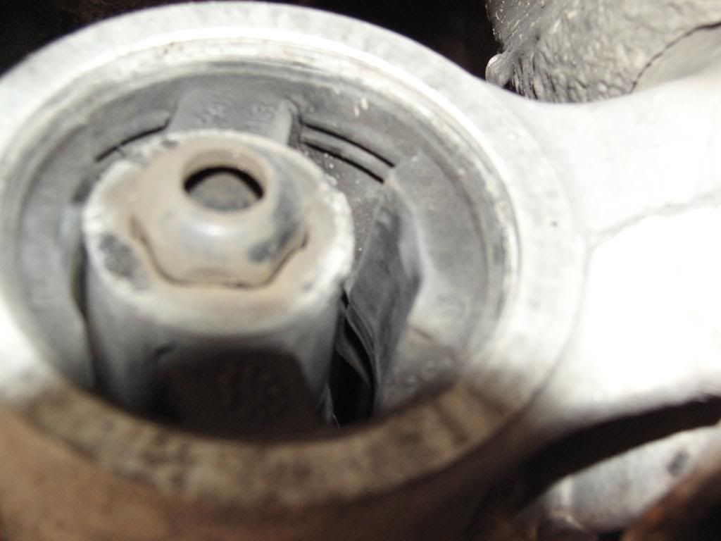

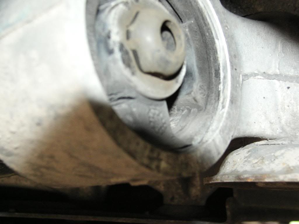

Cars up for it's MOT soon are these bushes supposed to be like this or are they knackered?
Yup they are showing signs of cracking - its only the two webs that are meant to be intact - the bits at the sides that have been rubbing are just meant for that purpose. Also yup only get Ibiza Cupra TCA rear bushes fitted - the p/n must start with 6LL if they try to sell you anything else say NO!! By the way, strange as it might seem, UK MOT will probably not get failed while they are in that condition - I'd think that they would need to be completely torn for you to get a failure on that item.
I know little to nothing about bushes, but would like to learn. Where is the cracking, I cant see any there? And are those the rear bushes?
Have a look at the last two pictures, the lower (rubber) web is showing signs of starting to crack or tear - maybe look up near the top (of the lower vertical web) of the second last picture and you will see a ragged dark line - also the same point on the last picture. Yes these are the famous TCA rear voided bushes (the voids are the holes or places where there is no rubber - just fresh air - the Ibiza Cupra bushes are solid so never get this problem)
Thanks for answering that's took a weight off my shoulders thought the two bits had separated.
