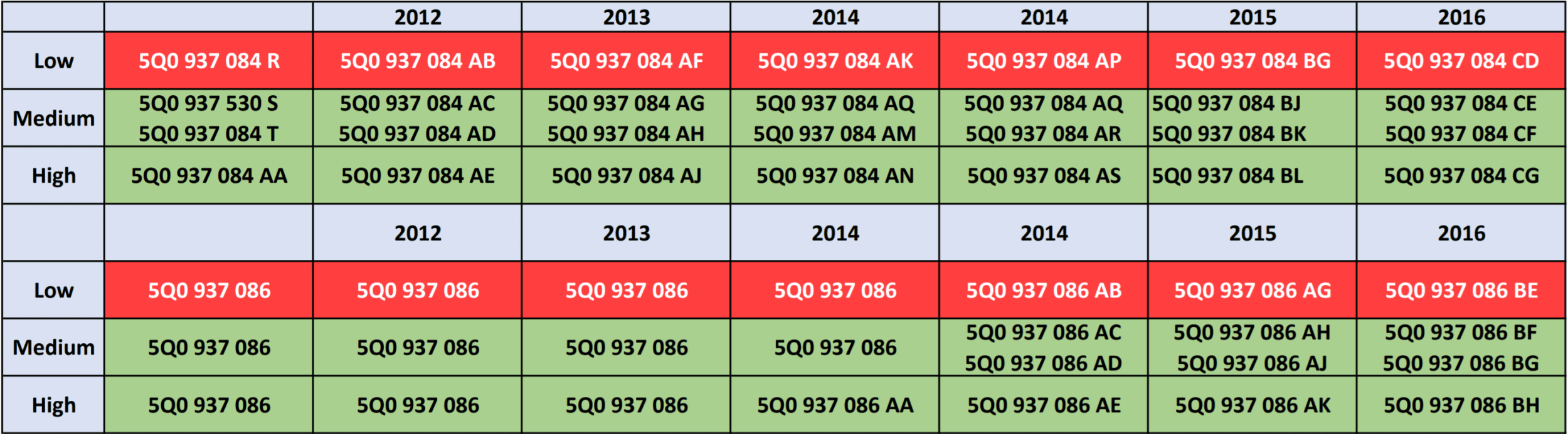

Before going any further into the guide, you need to check whether they can be fitted. This all depends on what type of BCM (Body Control Module) is fitted to your car.
The BCM can come in a 'Low, 'Medium' and 'High' format. Low modules do not support the feature. Medium's can support the feature (Some do and some don't), while High will certainly support it.
If your car is a face-lift model (2017 onwards) then you should already have a compatible module (High). If it is before this date, check the list of part numbers below to see if it is compatible. Note this is not a complete list of all part numbers available, and was complied elsewhere. I have formatted the original list into a clearer image:
The easiest way to check will be with a diagnostics interface (VCDS, Carista, OBE Eleven, etc). You can physically check the BCM for the part number if you wish, however it is tricky to get to so I advise the above method of doing so.
If you cannot check via the diagnostics interface or part number, you can physically check if the pins required are present on the BCM. Read the guide on the next page if you need to do this process as getting to the BCM is described there. You will need to locate pins 1,2 and 5 on the A connector socket, and pins 40, 43 and 56 on the C connector socket.

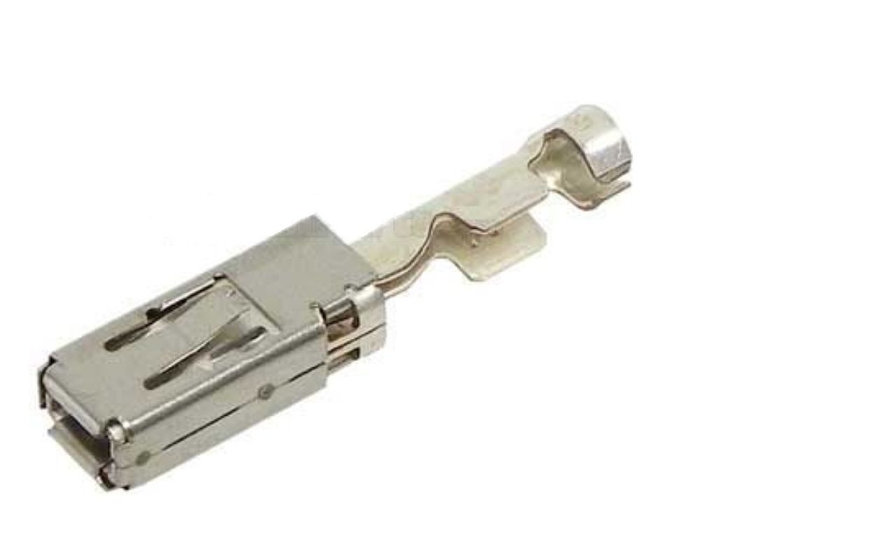

Pin terminals:
N907 647 01 x 3
A0135 545 76 26 x 2

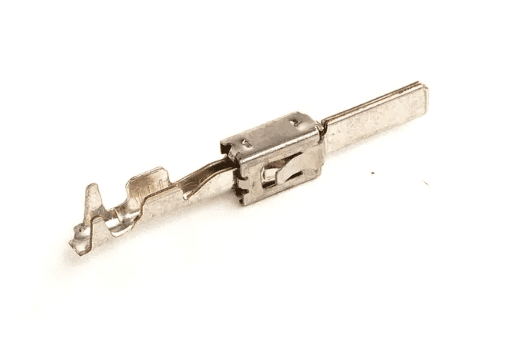

A013 545 76 26 OR MCP 2.8 x 2***
N103 360 05 x 4
N103 189 05 x 4

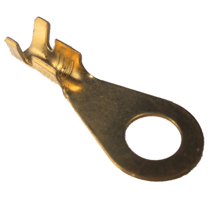

Ring Connector 6mm x 2

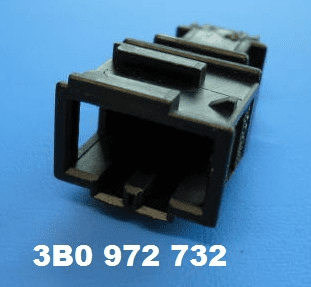

3B0 972 732 x 2

*** - This terminal can be substituted with a standard MCP 2.8 terminal if you struggle to find it, however it may require modification.

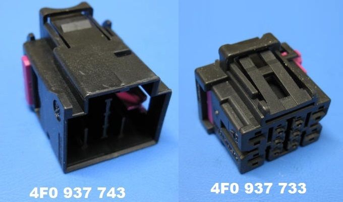

**** - These depend on how you do the retrofit. If you fit pads yourself, and do the wiring yourself you will need all of them. If you fit the pads yourself and use Kufatec wiring, you won't need any of these connectors. If you fit seats with pads already installed and do the wiring yourself, you will only need 4F0 937 743 x 2 and a 2 pin connector. If you fit seats with pads already installed and use Kufatec wiring, you won't need any of these connectors.
In regards to connector 4F0 937 743 and 4F0 937 733 you may struggle to find these connectors. If you are in the UK, TPS can supply these. Elsewhere, eBay only provided some from the USA and Aliexpress only provided some from Asia. You may have success with an official SEAT dealer in your country to source them.

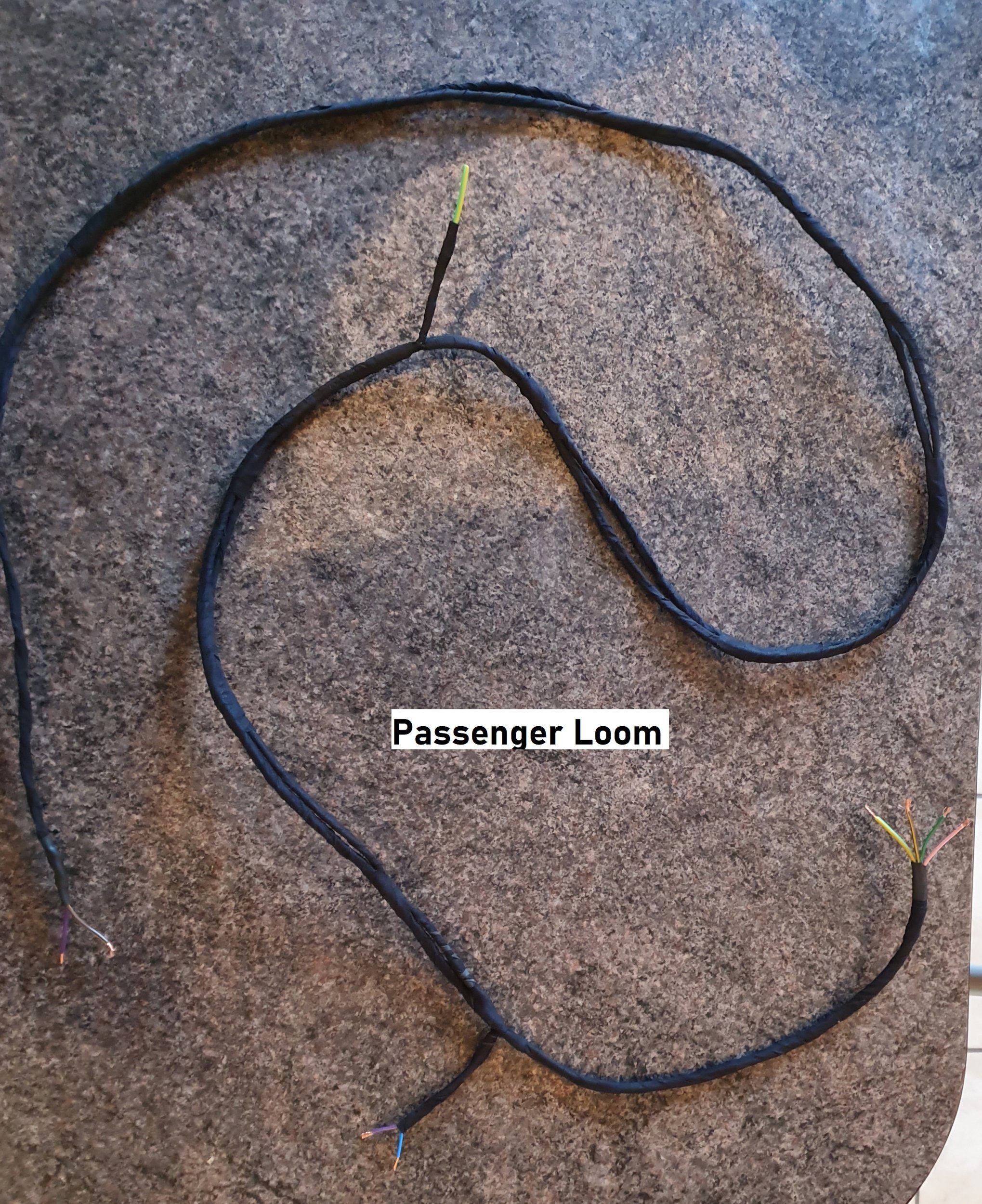

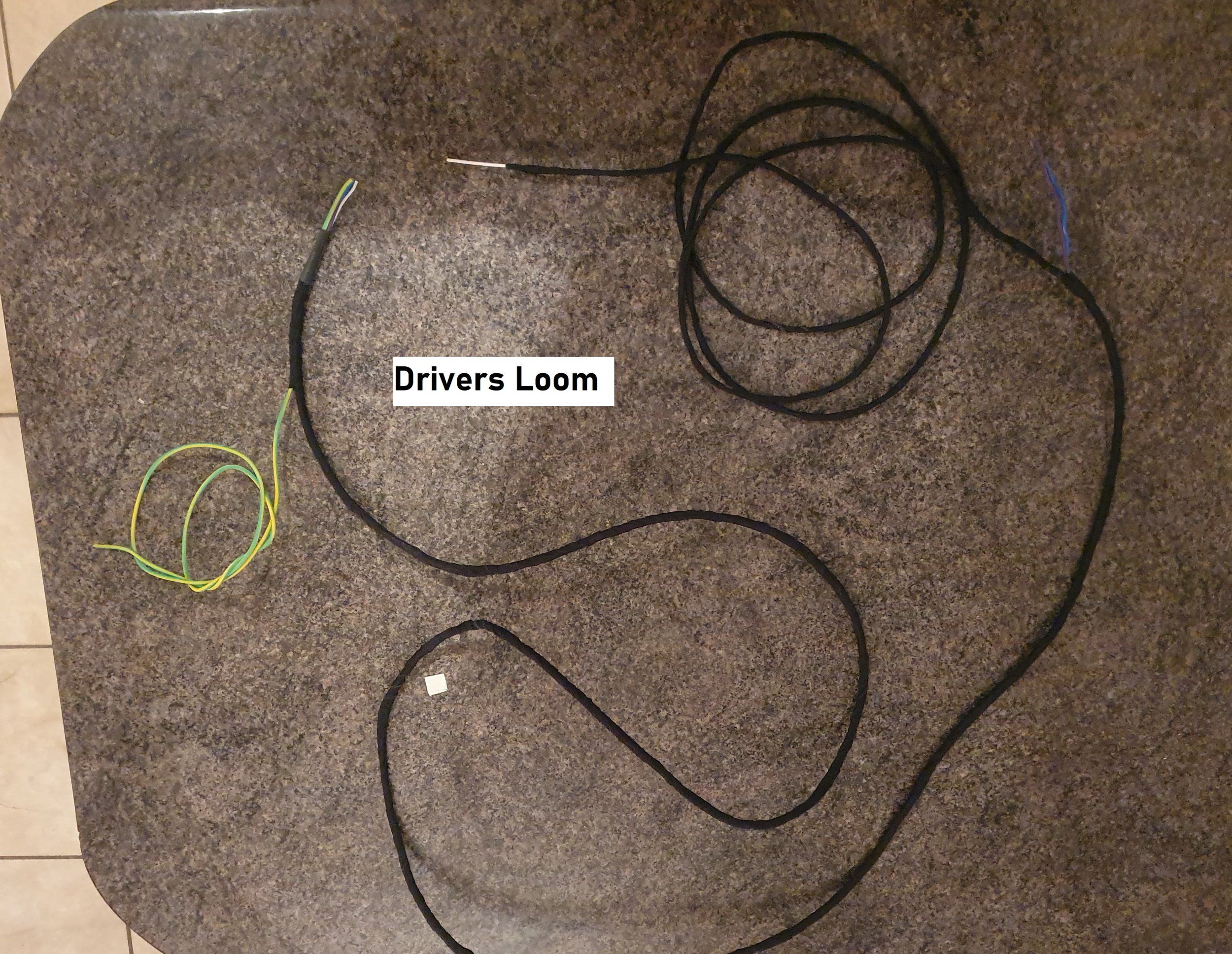

For the main BCM to seat looms, I split the drivers and passenger looms up to enable easier installation and fault finding if needed. Feel free to omit the 2 pin connector if you wish.
The diagram below is for creating a loom from the BCM to the seats. One end of the wires will be pinned with no connectors as it goes into the connectors on the BCM, the other end will be pinned and will use a connector (4F0 937 743) as noted in the diagram. I would advise not to insert the pins into the connector until the loom has been routed in the car, this makes it easier to route the loom under the floor insulation.
Diagram for RIGHTHAND DRIVE CARS
Diagram for LEFTHAND DRIVE CARS

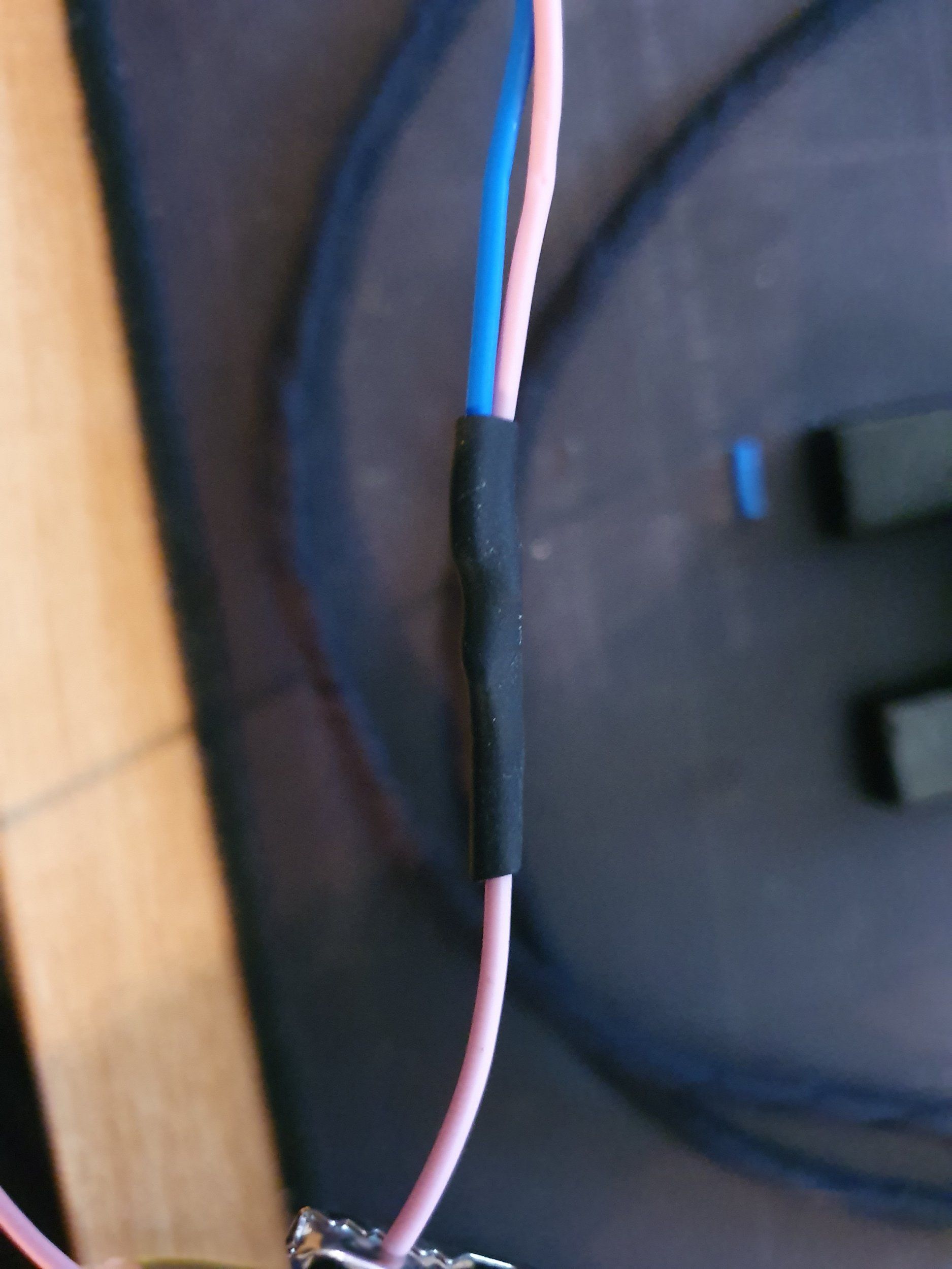

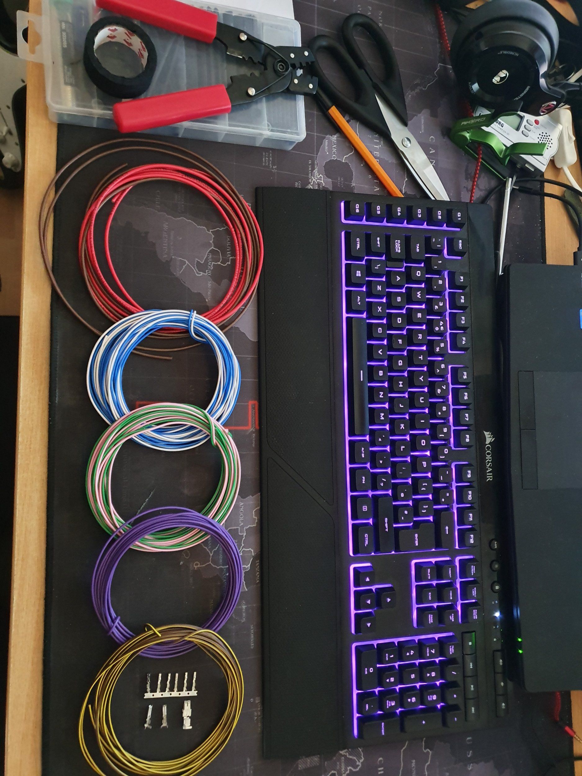

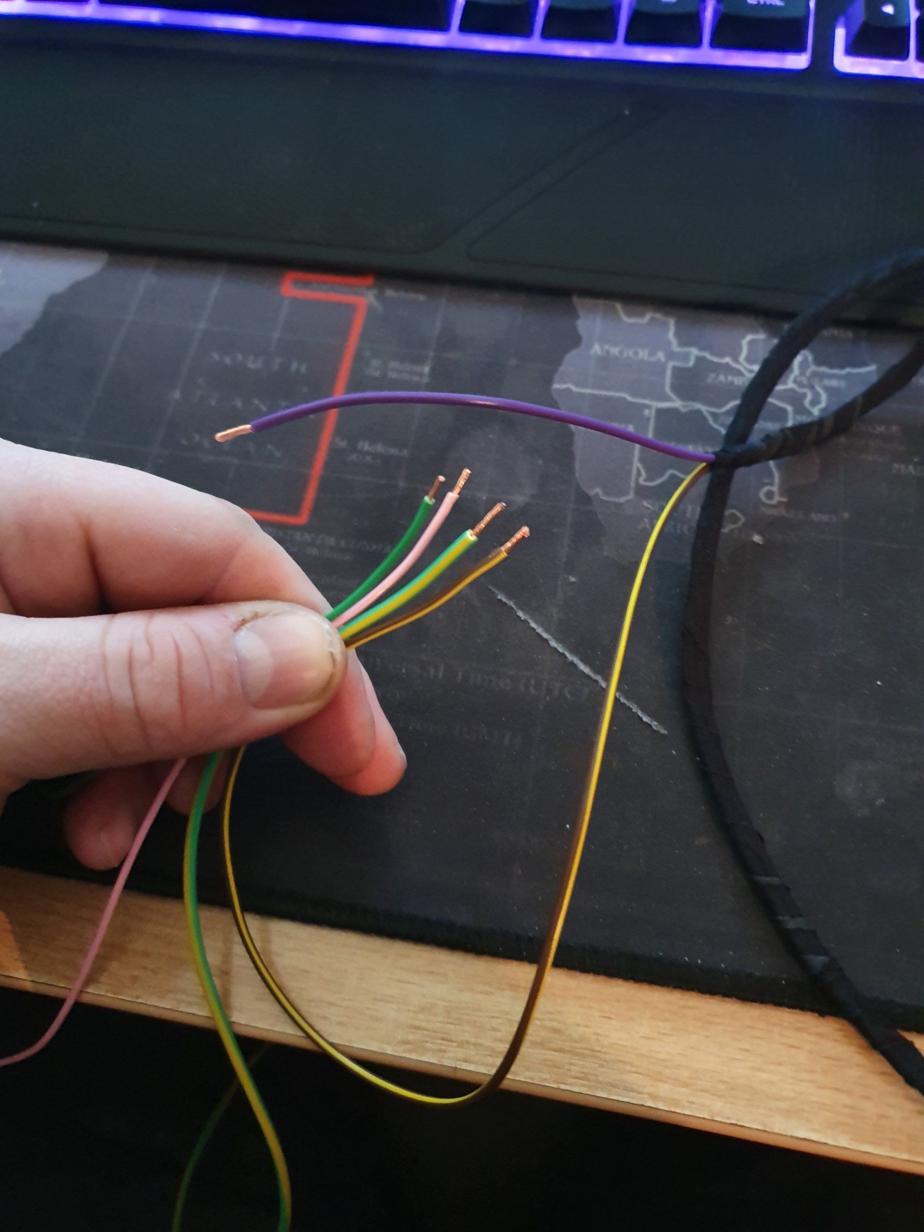

Here are pictures of my loom to help aid you in making your loom. I used masking tape and marked the pin number the cable was intended for on each cable to make installation easier, and to avoid wiring errors.

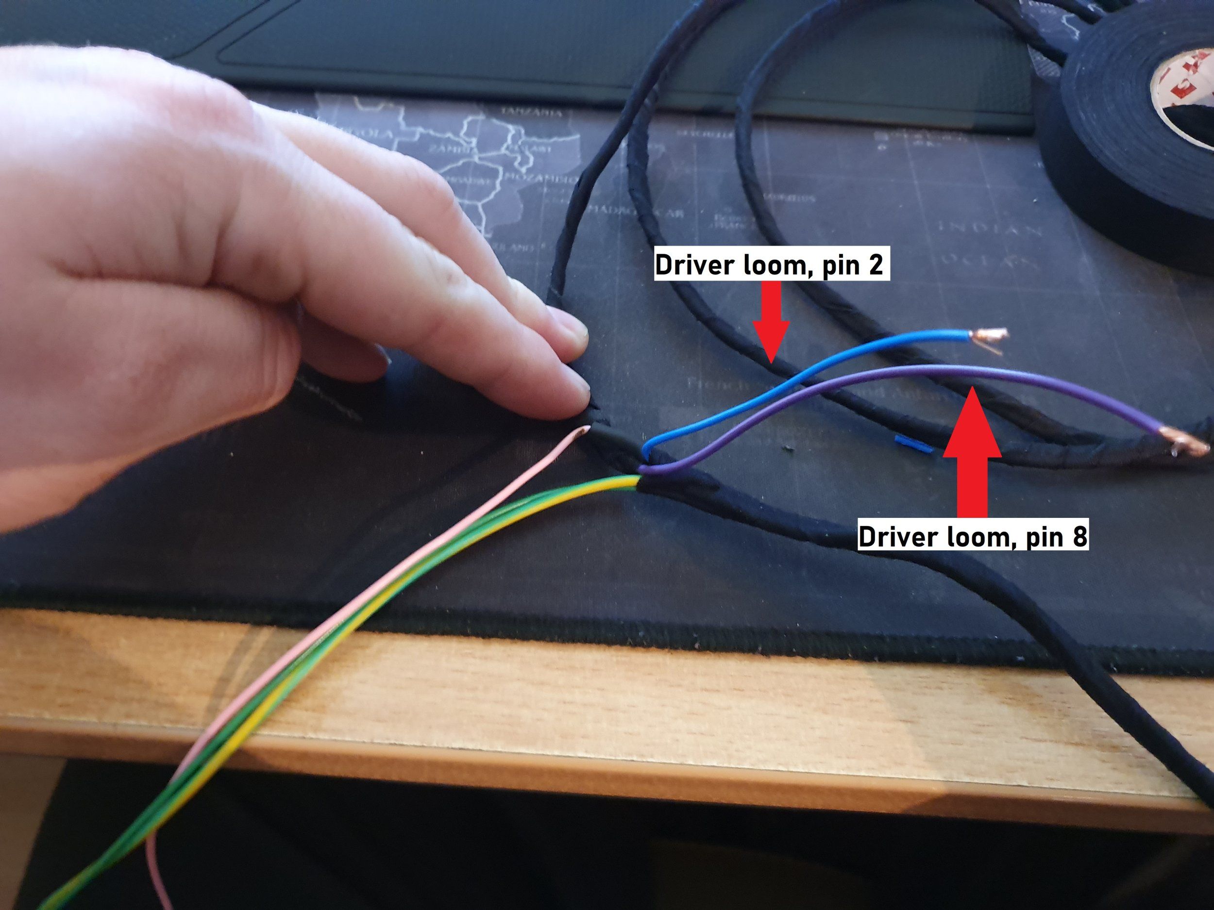

Four cables make up a seat end connection,two 1.0mm wires and two 0.5mm wires:
Pin 2 from both passenger and driver looms join:
Connection added for practical reasons, not required:
Completed passenger loom:
Completed driver loom
Once the loom is complete, you can install the terminal pins. On the both looms, the seat end need pin N103 360 05 on the wires that go to pin position 2 and 3. For pin position 8 and 1 use terminal N103 189 05.
At the BCM end, use terminal N907 647 01 for pin position 40, 43 and 56. For pin position 2 and 5 use A0135 545 76 26.

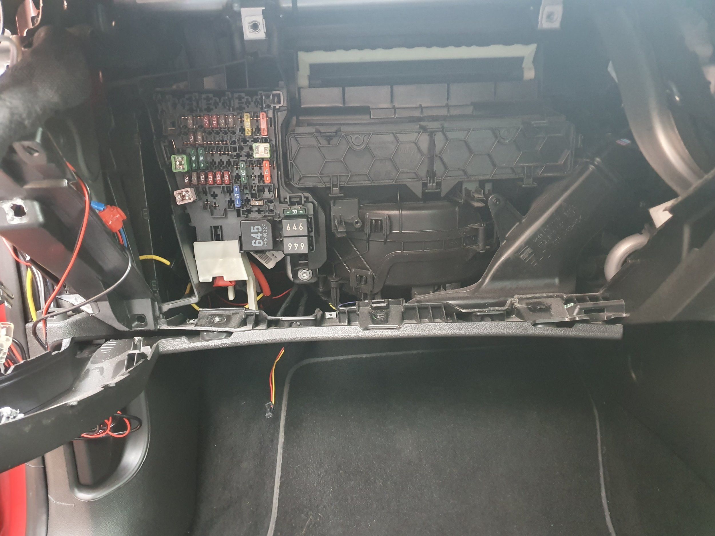

Firstly, remove the glovebox and footwell panel. If you need to know how, see the guide linked in the information page.

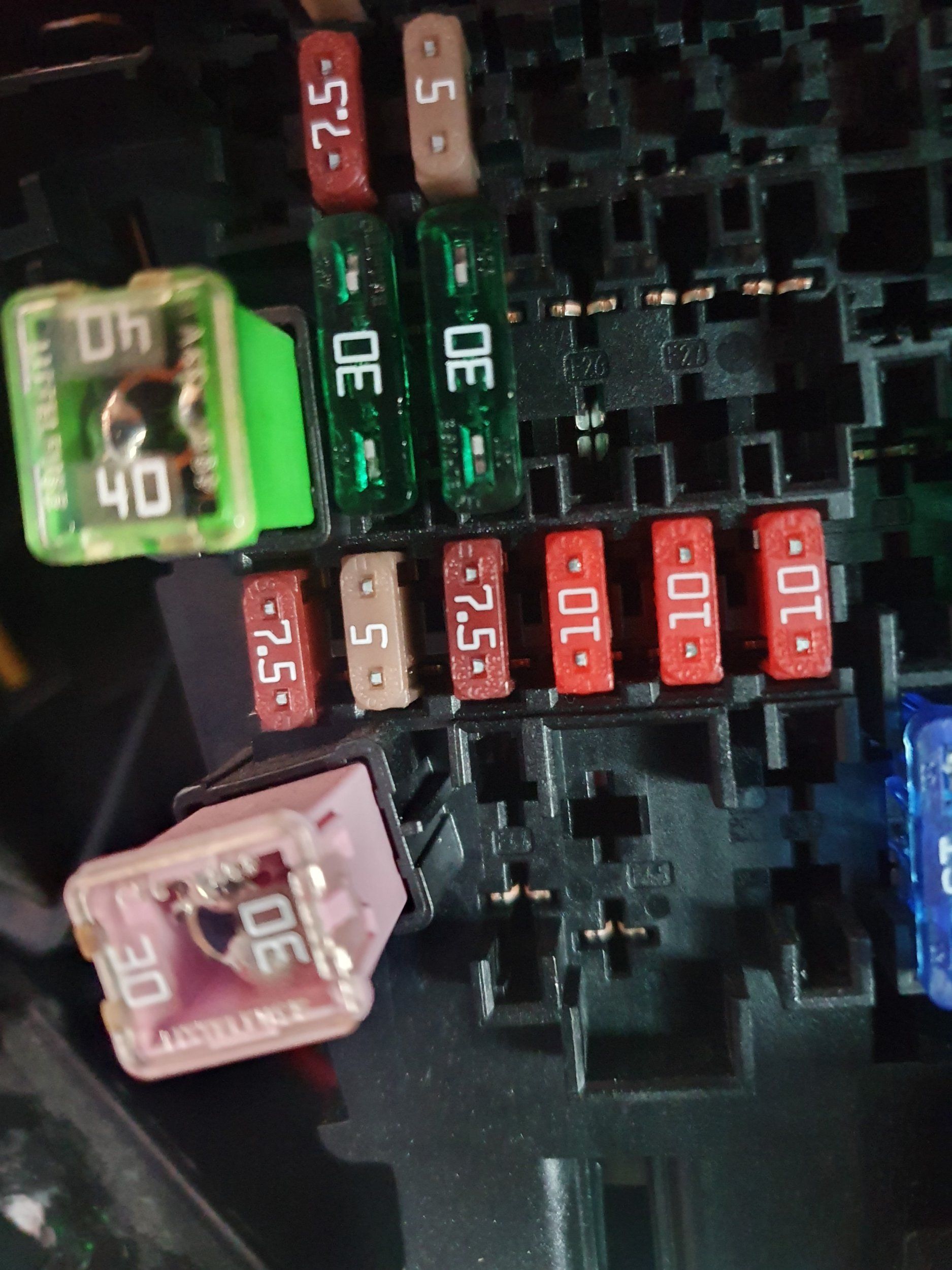

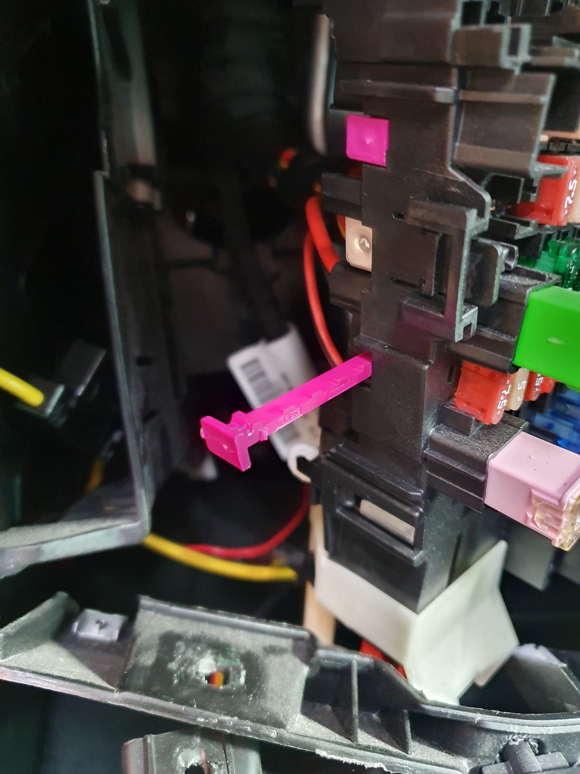

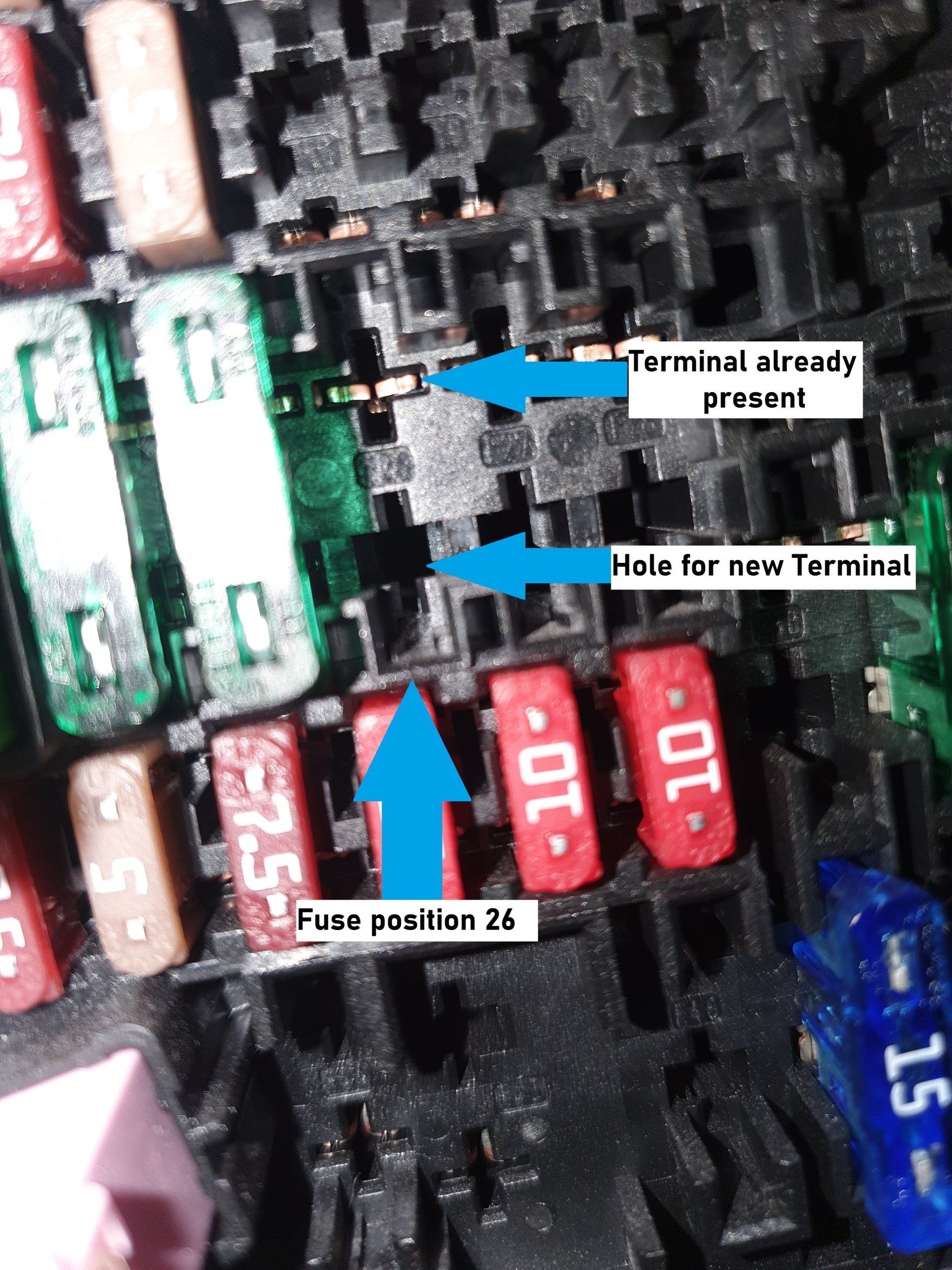

With the glovebox out of the way, the first task is to install a new circuit into the fusebox. This sounds complicated, but is simply a case of inserting a pin into the rear. You can also use a piggy back fuse holder/add-a-fuse socket if you wish instead of wiring a new terminal in, however it looks messy and isn't what I wanted to do for the retrofit. It does however avoid having to mess about with the fuse box. The choice is yours on this one.

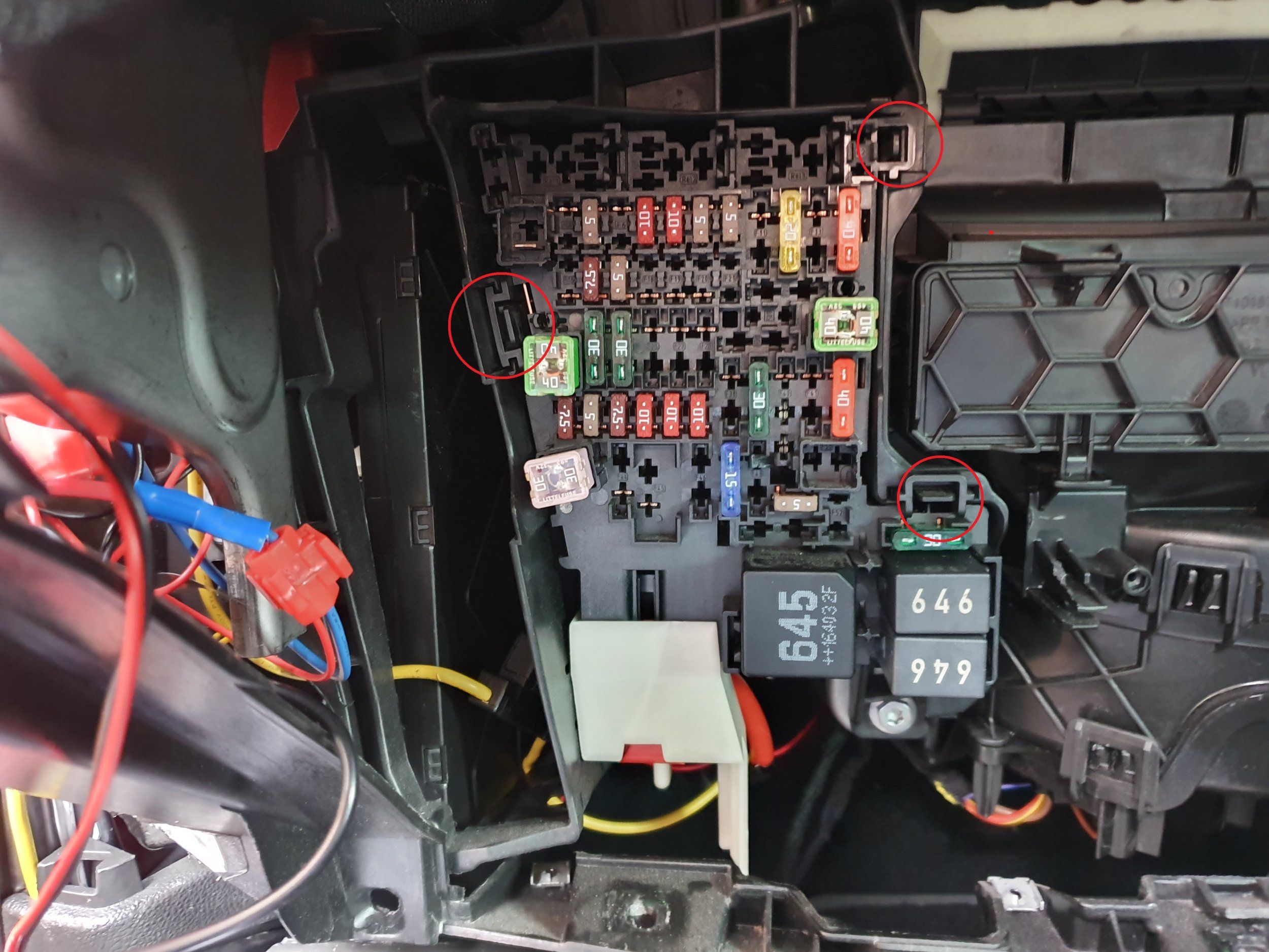

To begin with you need to release the fuse panel. It is secured with three toggles that have to be pushed to the side. Once all three are pushed aside, the fuse panel will pull towards you. It will only pull forwards so far.
Once it has moved out, locate the purple tabs on the side nearest the passenger door. You need to remove the second one down. It pulls out:

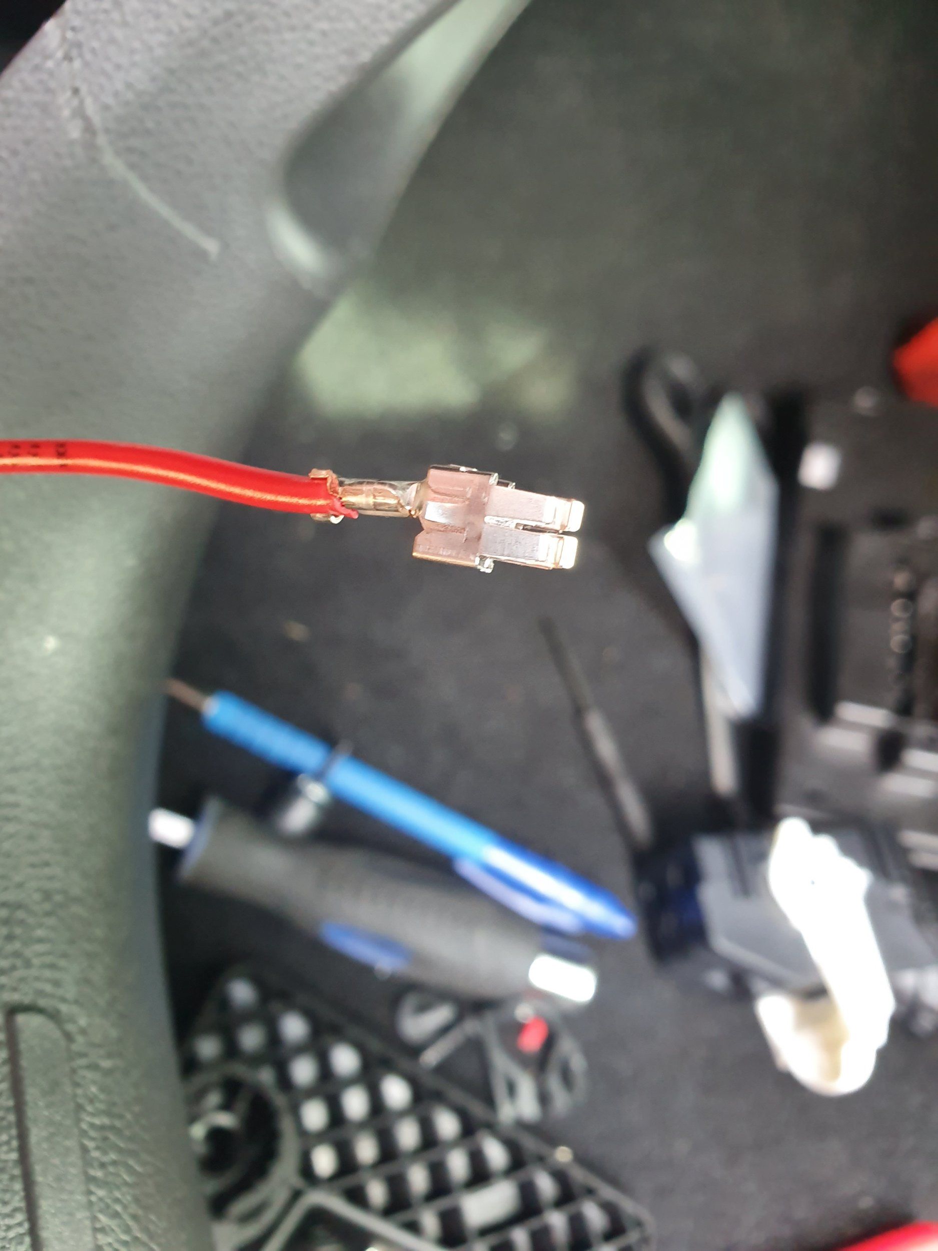

Now you can insert the cable into the rear of the panel. To do this, you need to locate where fuse 26 would be. Looking at the fuse panel, locate number 26. You can see the top hole already has a live copper connection present. You need to insert your connecting wire into the hole below. This is tricky to do and will require patience.
I took me around 10 minutes to finally get the terminal into position. I found it easiest to push a cable tie into the empty hole and out of the back of the panel, and then pull the fuse panel out as far as possible. With the area illuminated I managed to thread the cable in-between all the other wires to where the cable tie was sticking out (this is to locate where the hole is/where the terminal needs to go). I then pushed the terminal into the hole. It should click in and secure itself.
New terminal installed in previously empty hole:
With the new terminal inserted, move the fuse panel aside to make getting the BCM out easier. The BCM is located to the left of where the fuse panel fits. It needs to be pulled down and out to gain access. To do this you need to semi remove the passenger door sill trim. In the footwell to the left, you will find a T20 Torx screw that needs to be removed.

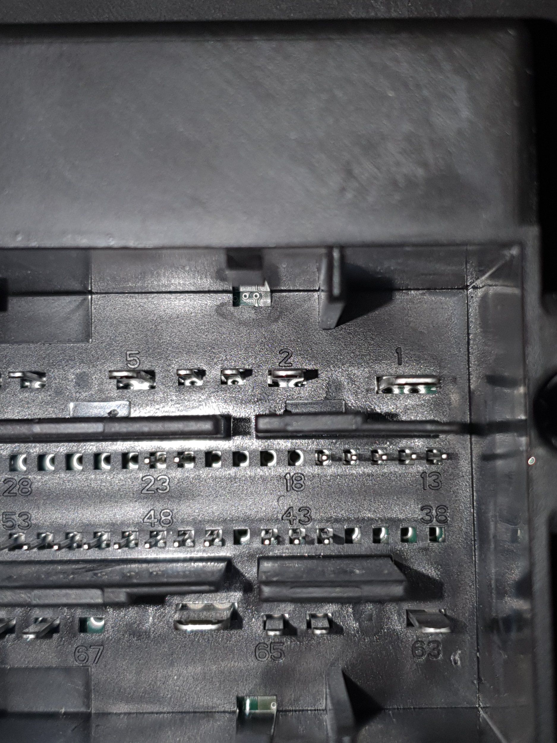

Once removed, disconnect the 3 connectors. You can now remove the BCM from the car should you wish to. Note the car will not function/remote lock while it is disconnected. With the BCM to hand, locate the pin numbers on locations for connector A and connector C to confirm they are infact there. If they are not present, you will not be able to do this retrofit.
Pin numbers on BCM

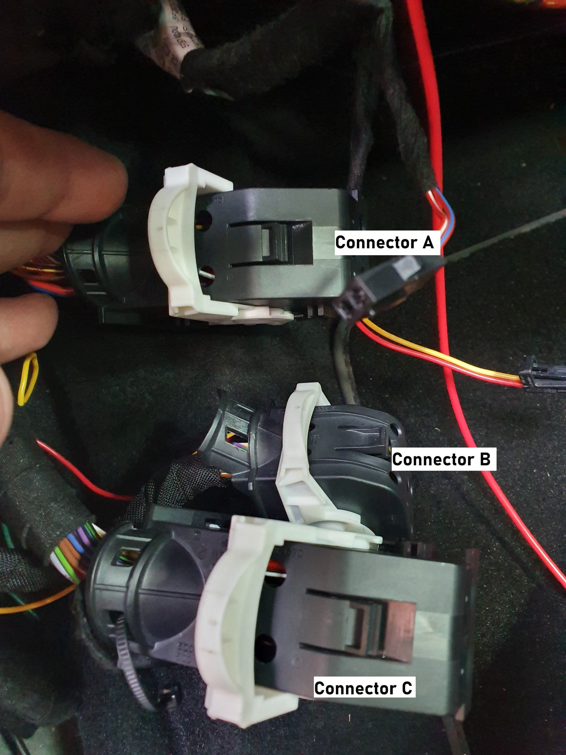

Now you need to identify connector A and C in the car. Connector B is smaller so can be easily identified. Connector A is closest to the front of the car and won't pull out much, while connector C is nearest the rear of the car and should pull out more easily.
Once identified, disassemble connector A as described in the fan jets washer guide. Locate pin 1 and install the other end of the connecting cable you just inserted into the fuse box while ensuring you route it as to not obstruct anything when replacing everything you have removed so far.
Pin 1 installed:
Next, take the loom for the seats and install the corresponding pins into position 2 (Passenger seat) and 5 (Drivers seat).
If you have a left-hand driver car, then position 2 is for the drivers seat & position 5 is for the passenger seat.
Once done, reassemble the connector and route the cables along the door sill for the time being, don't secure them yet.
Next, disassemble connector C and locate positions 40, 43 and 56. Install the relevant pins into the pin positions and re-assemble the connector.
If you have trouble inserting the pin terminals into the plastic connector, double check the terminal is correct for the pin it is going to attach to. If it will not insert, depending on where you got the terminal, it may need to be modified/replaced to fit the connector correctly.

Don't forget to install a fuse into the new fuse location if you haven't done so already. It takes a 20 amp yellow ATO blade fuse.

If you haven't done so, you can now re-install the BCM/fuse panel and rebuild everything you have taken apart.
