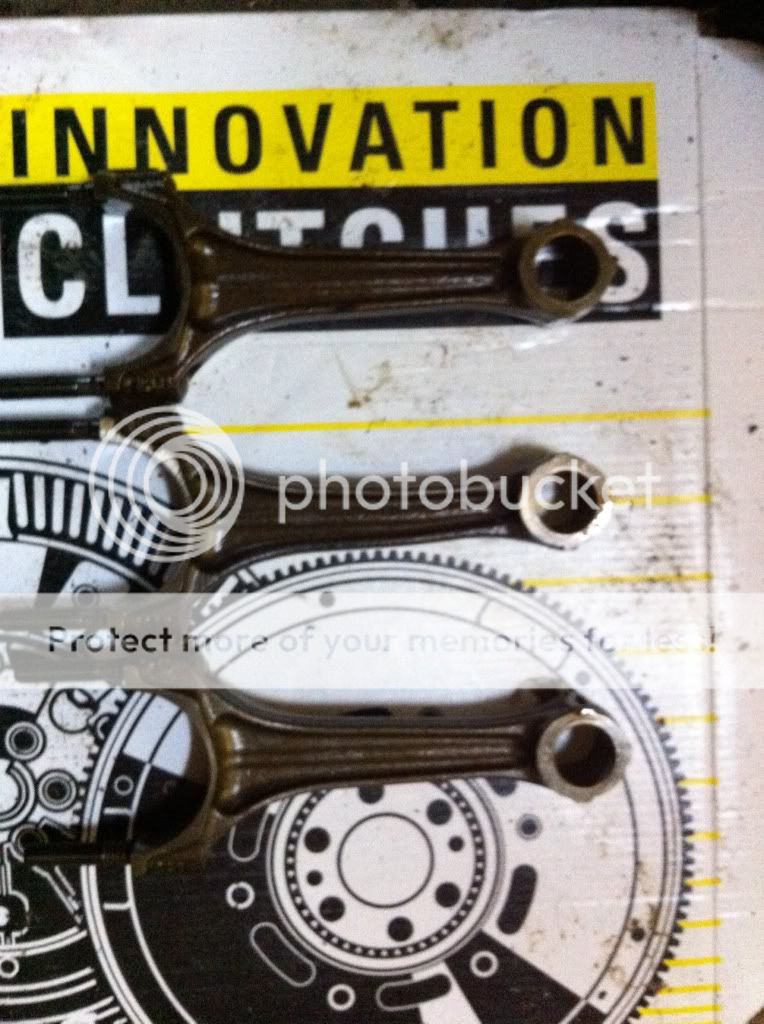

I posted this in my RR but thought I'd copy and paste it here as well.
Every time I convince my self to stop being a girl and get my car mapped I find photos like this!
These photos are from here http://www.********************/index.php?topic=252813.msg2318858#msg2318858
Apparently from a standard unmapped LCR. The owner took his car to a VAG sepcialist with a loud ticking from the car!
I know they're a lot of factors involved and most cars are fine but... Imagine if that had gone over taking a truck on the A15! Scary thought.
No he drove in like that!:scary:
I don't know why the link doesn't work it from the MKIV section of the Golf GTI forum if anyone's interested.
This is copied from the thread
[quote author=topher link=topic=252813.msg2318823#msg2318823 date=1366838504]
i'm told it isn't modified, i haven't tried reading the ecu to see if it's mapped and obviously can't put it on the dyno at the moment :grin:
there were no signs of detonation or debris on the piston crown, some bearing damage but the crank survived. the cylinder wall would go again since it knocked the oil spray jet clean off before it could interfere with the rings.. the problem with that is the thread didn't pull out of the spray jet, it pulled a big chunk of the inside of the block with it :laugh: the crank sensor pickup ring isn't looking too clever either thanks to the groove it shaved off the bottom of the piston skirt that you can see in the pictures
