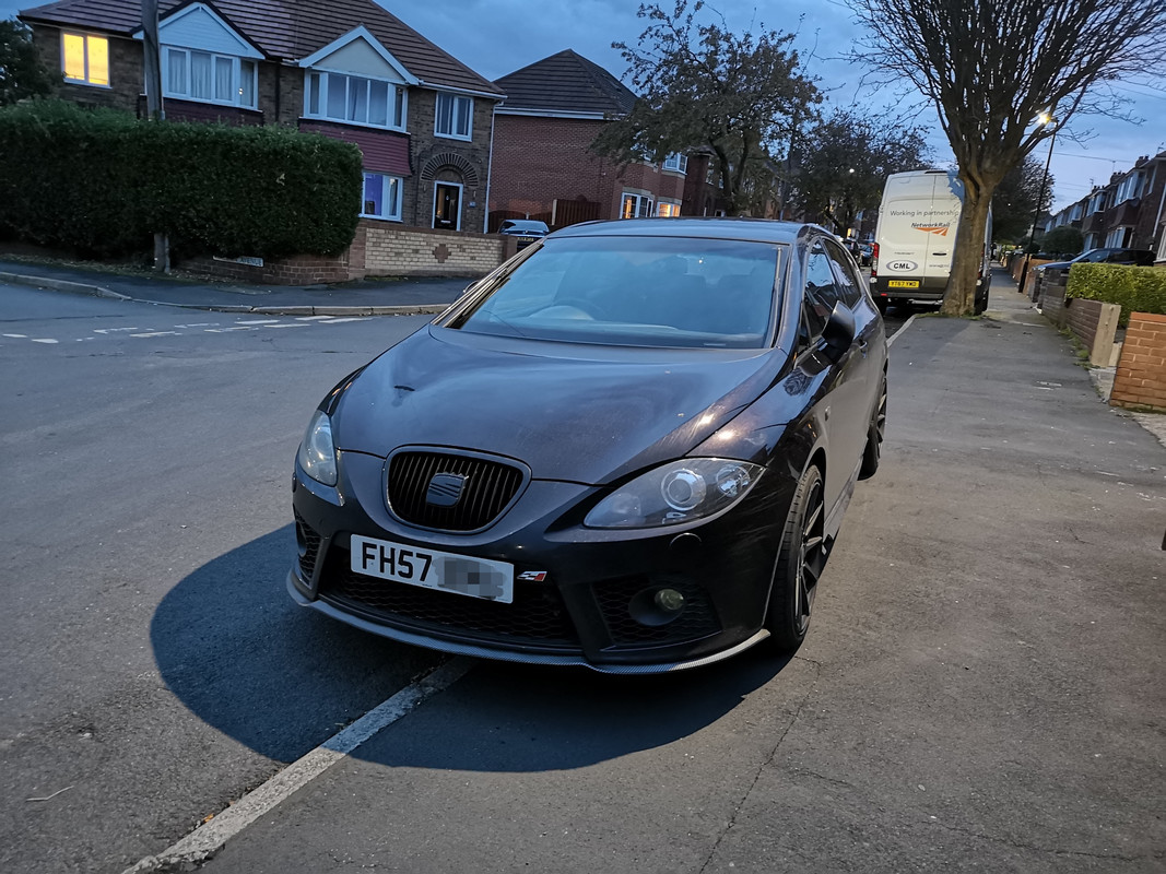

Enough of the little mods, finally a big (for me) mod! New wheels! thanks to @bigT's lcr for the smooth sale and absolutely loving the wheels, might even keep them Matt bronze as I'm debating having them refurbed gun metal grey.. anyway some better photos to come once the cars clean
Just needs lowering now ;)

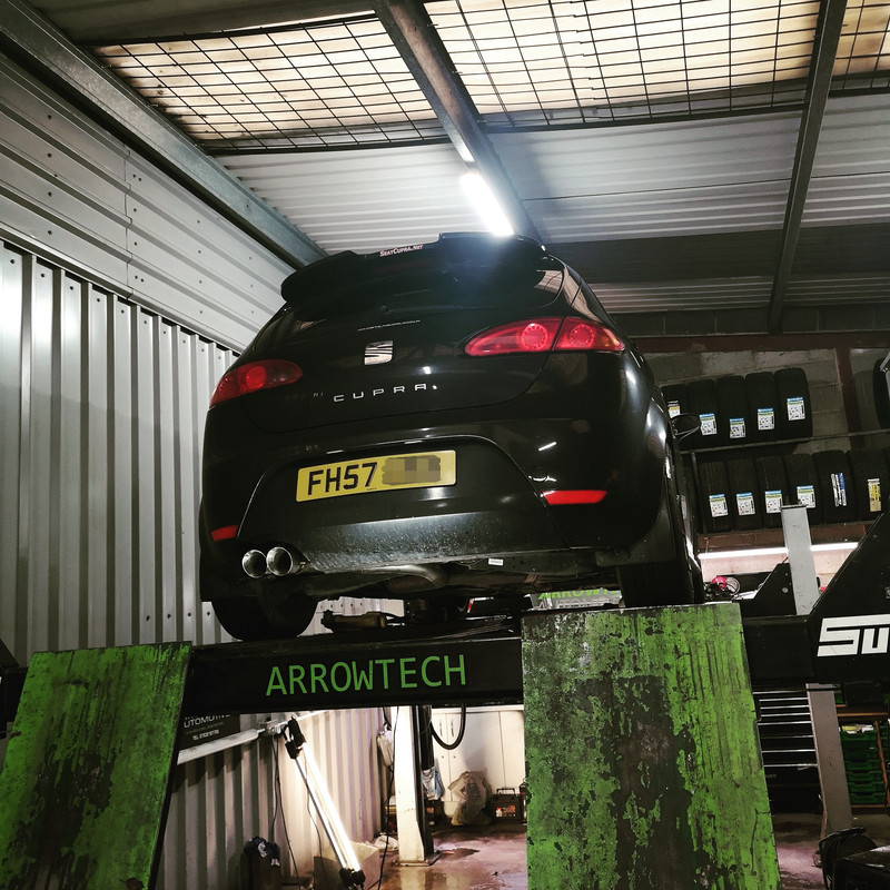

Interesting couple of weeks it has been lol, started off with having both cats out and a stage "1.5" map put on with added safe overrun. Sounds pretty good, alot more power than before and alot more torque too. Anyway clutch hates that and occasionally slips in 4th gear but higher up the revs so we capped the torque off a little bit but not really made much difference so that's still on my list of things to sort out. More recently the exhaust started to blow making it sound absolutely awful so of course went for a backbox delete and it was also blowing a little further up which we sorted too. Went in wanting a single tip but decided the double tip looked better.
Also had a missfire on cylinder 4, the coil was absolutely knackered, full of rust, spark plug chamber full of water and they just looked tired so I fitted a fresh set of R8 coils and whilst I was at it put some new bkr7eix plugs in too.
Car is... Loud :lol:
