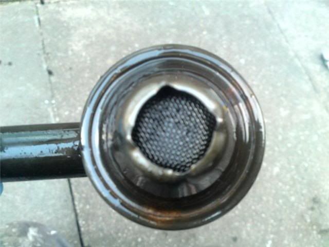

Righto Ive took the Sump off which was really straight forward Was easyer than the ibiza Sump Yet there the same...
Anyway I didnt notice much on the pick up as i was looking for too much tbh...So a quick phone call to john and the Mesh on the retained was clogged full of sludge And slim...Ive sent john a picture of it as i cant up load it on my computer as its being gay but you can soon see on the dark parts were i scrapped it back a little bit

TBH, ive seen far worse on customers cars. how was the oil? how old? what type? give that a blast through with brake cleaner and make sure its dry before you put it back.
