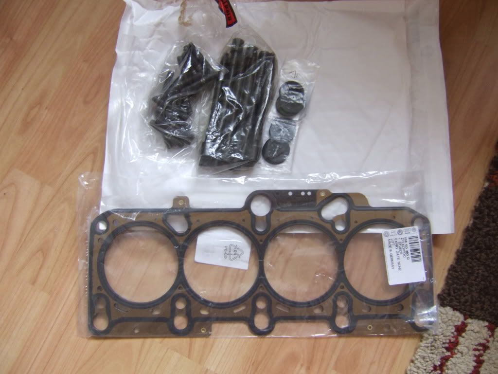

Received a few goodies in the post today.
Gasket and bolts ect. from sere

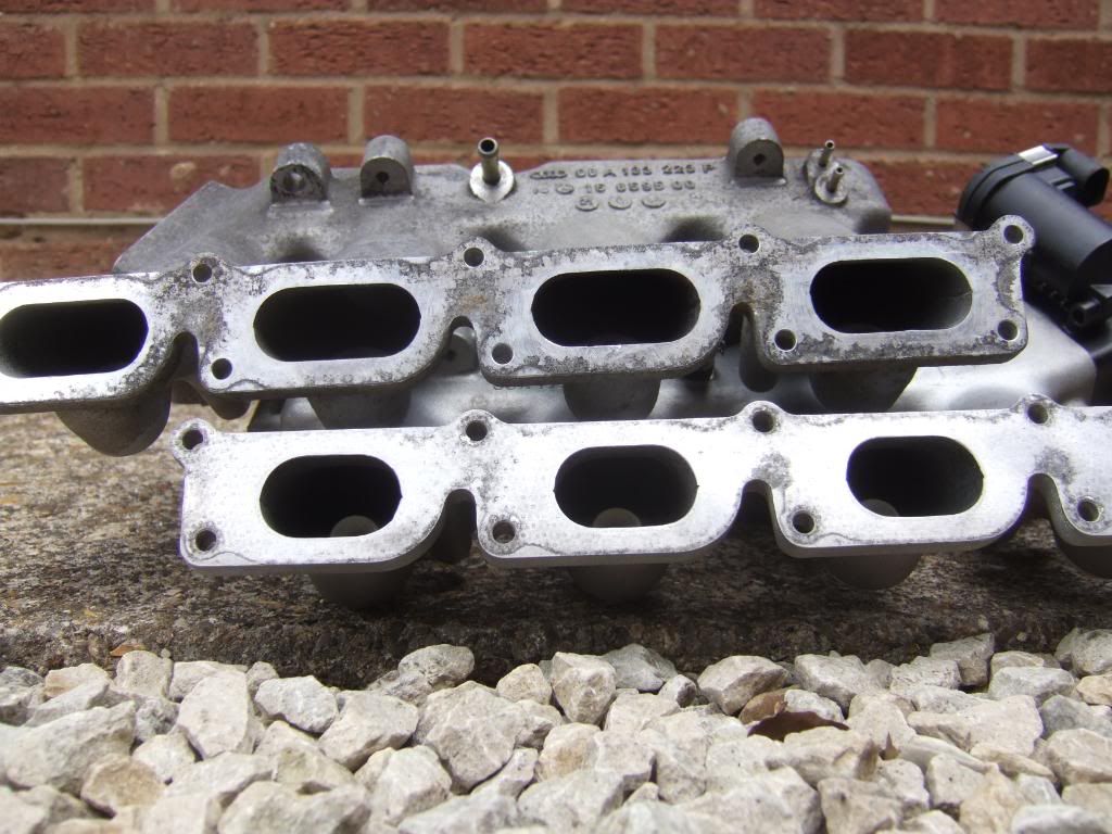

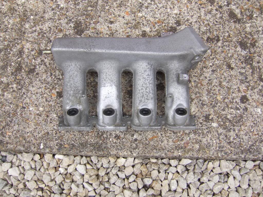

And my largeport inlet manifold
Comparison to my original..

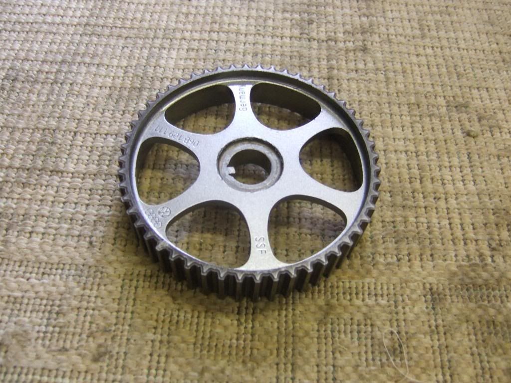

And I also gave my cam pulley a spray.

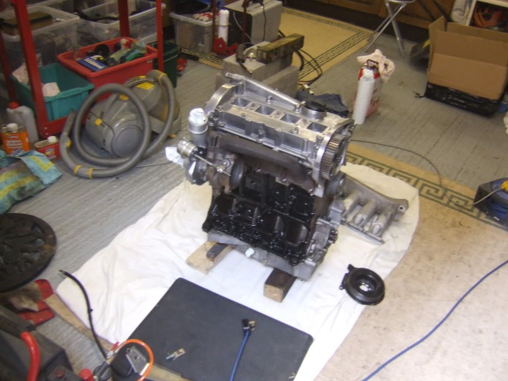

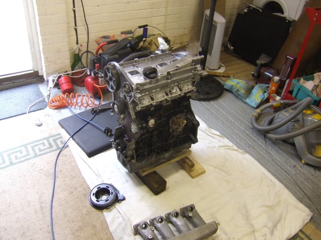

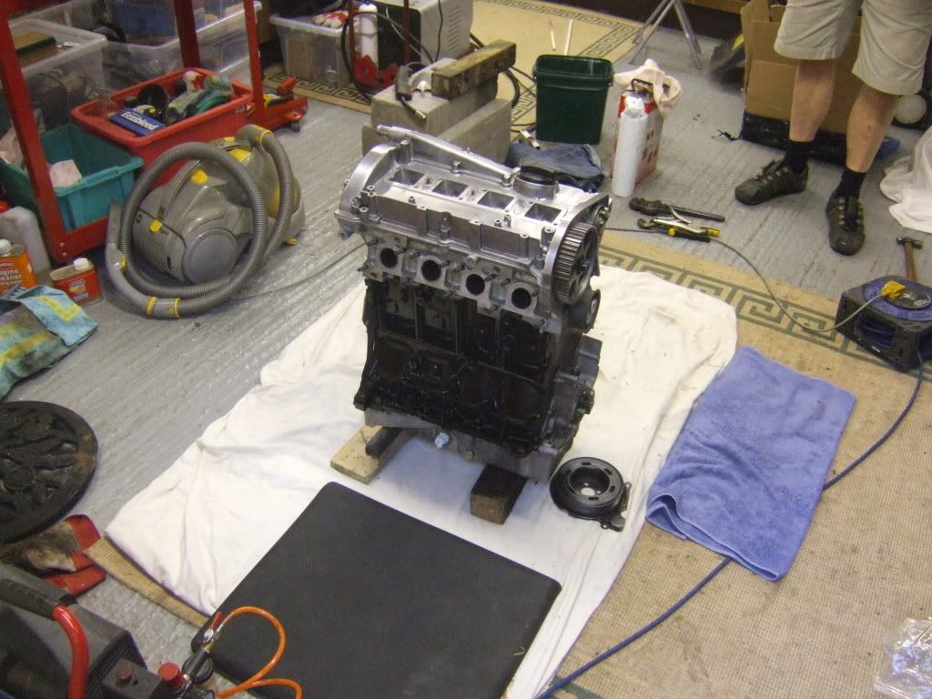

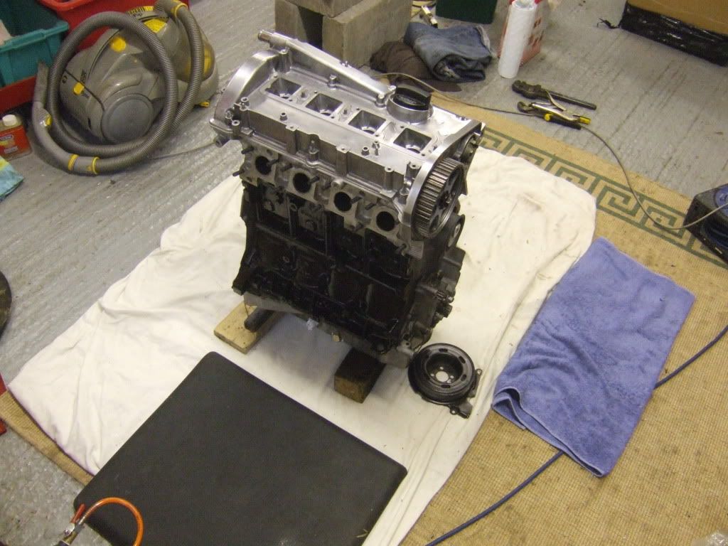

Blocks painted and heads on and torqued up starting to look like an engine again.
Had to get 2 snapped studs out the head which was a bit of a nightmare as one had snapped flush with the head.
Luckily after drilling it out heating up the head and using a stud extractor it came out quite easily :)
Decided to replace all the studs as I was sent a bag of about 20 lol.
