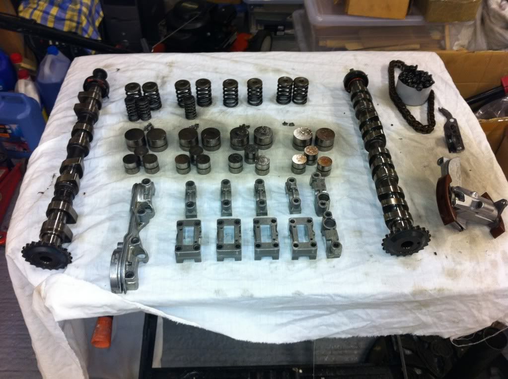

After measuring my ADR cams and realizing they were standard turbo cams I went on the hunt for some N/A AGN cams..
Turbo cams:
Inlet- 7,67mm lift,
Exhaust- BAM 9,3mm lift,
N/A AGN cams:
Inlet- 8,41mm lift,
Exhaust- 10,4mm lift,
No not yet all I have done is measured the lift to confirm they are correct. I have found this info on them though..

I thought I would remove one of the followers to check the valves & springs ect to find out they were bog standard! I have an invoice for "fully built head with large race valves" I then delved deeper by removing the head to realize that is had been internally painted on all surfaces!!

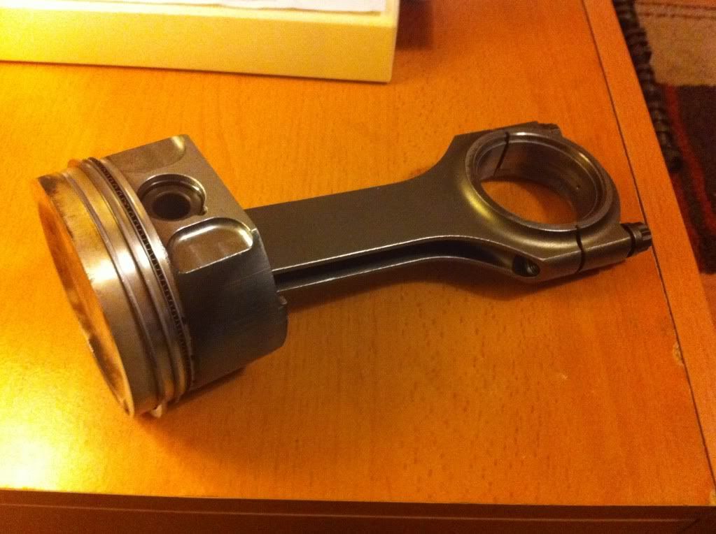

After seeing this I started to doubt the rest of this so called invoice I was given and proceeded to strip the bottom end to expecting to see JE pistons and rods.. what did I find?
Wossner pistons and TSR rods which cost half the price of their JE counterparts. (atleast they were the correct size & comp 82.5mm 8.5CR)

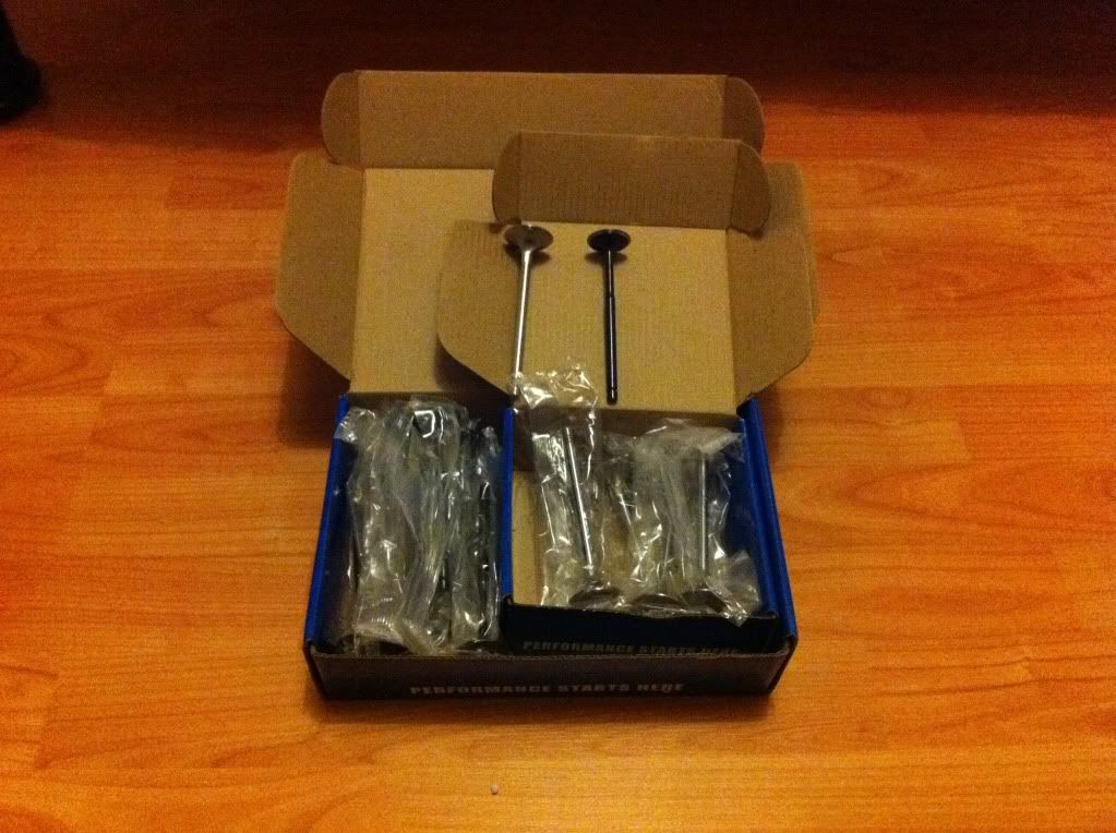

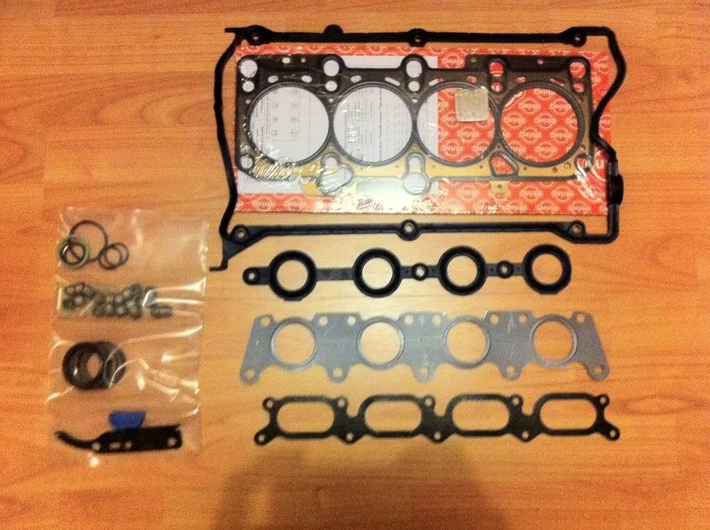

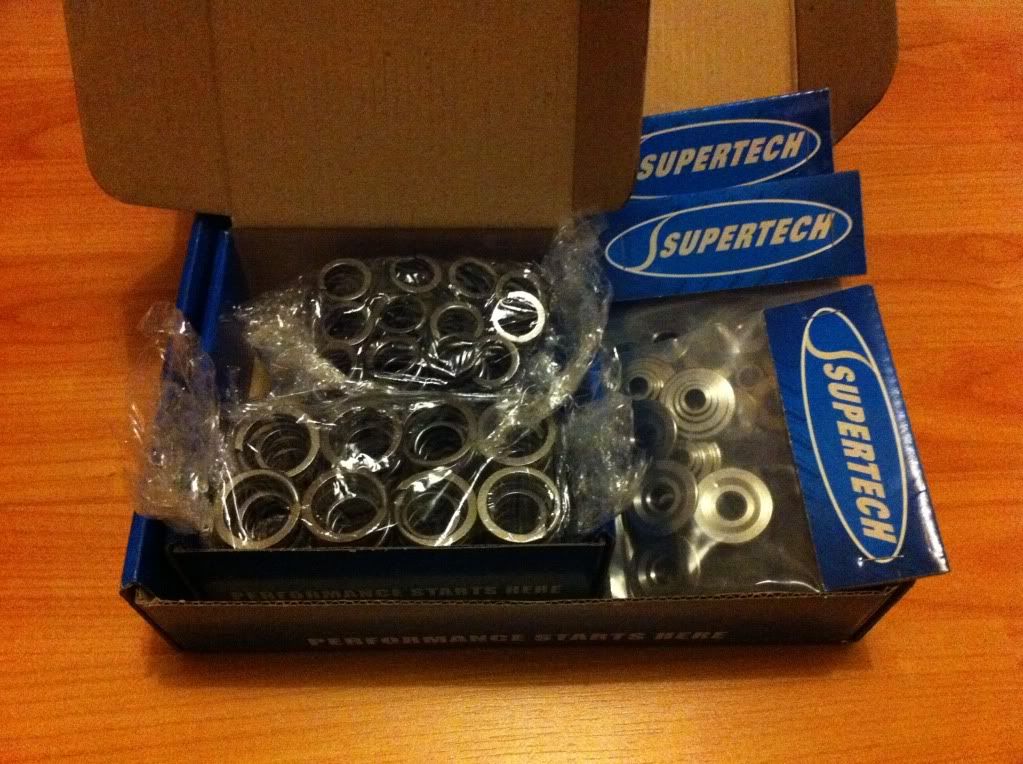

First off some lovely supertech valves springs & titanium retainer aswell as a full head rebuild kit courtecy of Sammy@ INA :D

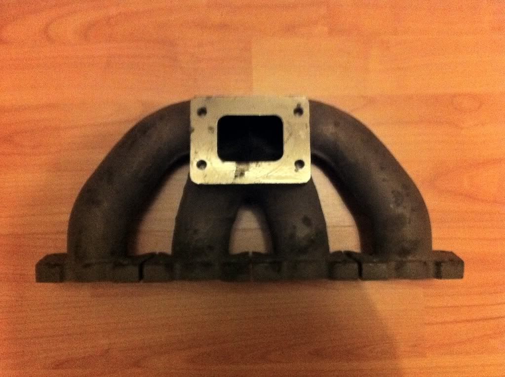

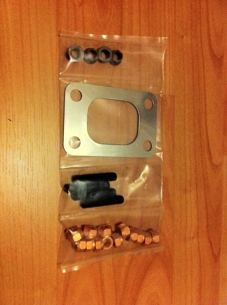

Full turbo to head kit:
INA T25 topmount manifold:

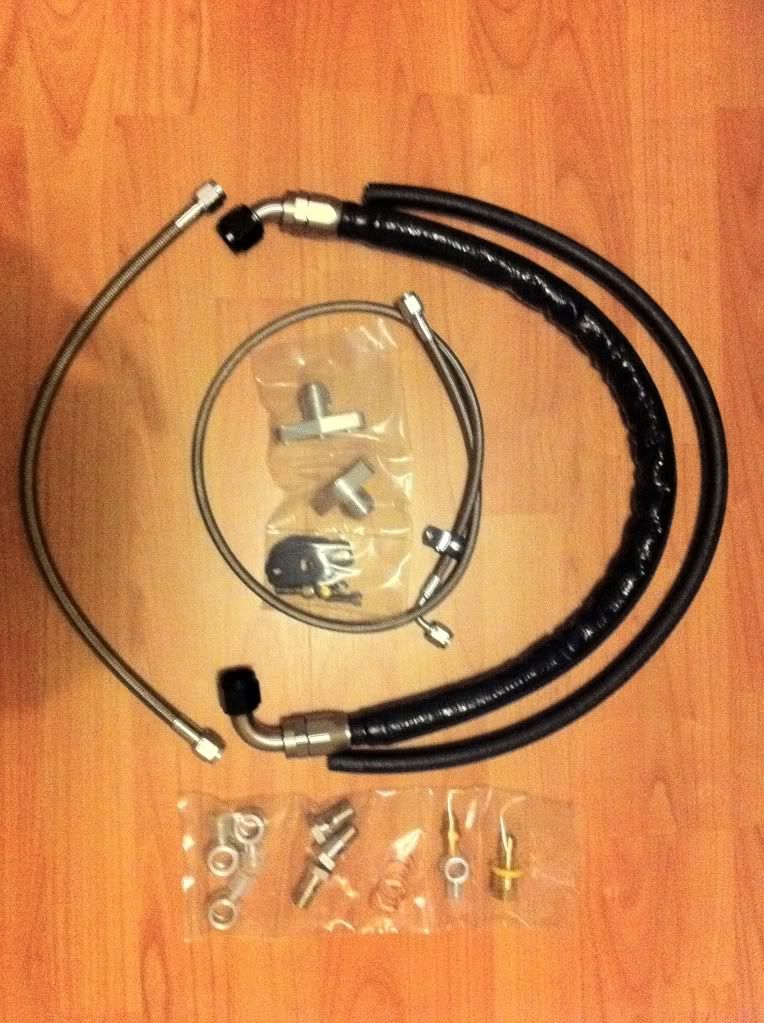

All the oil & coolant lines needed:

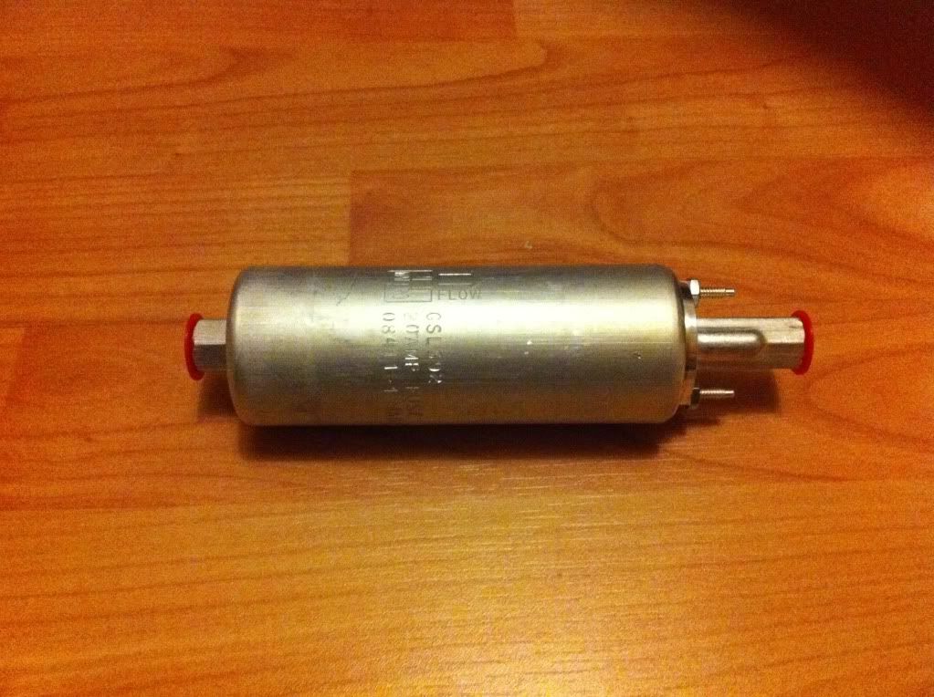

Walbro in-line pump:

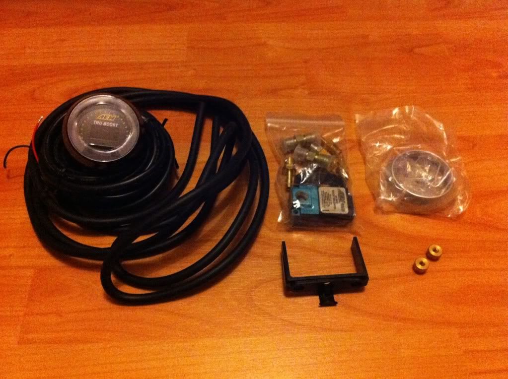

AEM TruBoost EBC:
Eveything looks beautiful and I must praise the service I received from INA! Cheers Sammy :D
