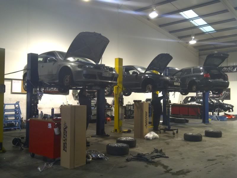

Was a very long day due to some complications with other cars but everyone got done in the end.
Here are mine and Tom's cars on the ramps getting virtually identical work done

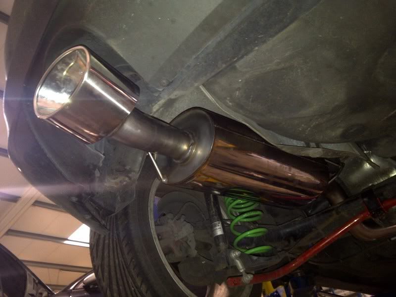

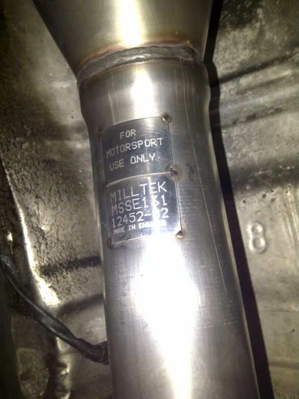

And a few pictures of the Milltek fitted:
Sits perfectly in the bumper

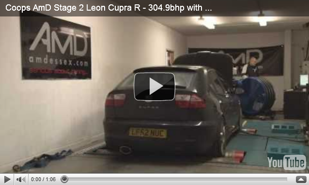

So next they applied the Stage Two AmD map and ran it on the rollers again.
Everyone was shocked at the result.... 304.9bhp & 310.8ft/lb !!!!
Awesome result for a standard K04, the car took the map really well! I think the de-baffeled charge pipe and especially the Badger5 3" TIP made the difference.

Lots of videos of the RR runs to come once I've edited them up
