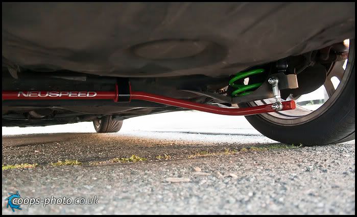

So Tuesday was the big day, a lot of money was spent upgrading the LCR's whole suspension setup! Here is a full list of what was fitted:
  • From 23mm MK4 Golf R32 Anti Roll Bar
  • Rear 25mm Neuspeed Anti Roll Bar
  • Weitec Ultra GT 40mm / 40mm Springs & Dampers Suspension Kit
  • Full Powerflex Poly Bush Kit
  • New suspension top mounts
  • Full geometry and alignment setup

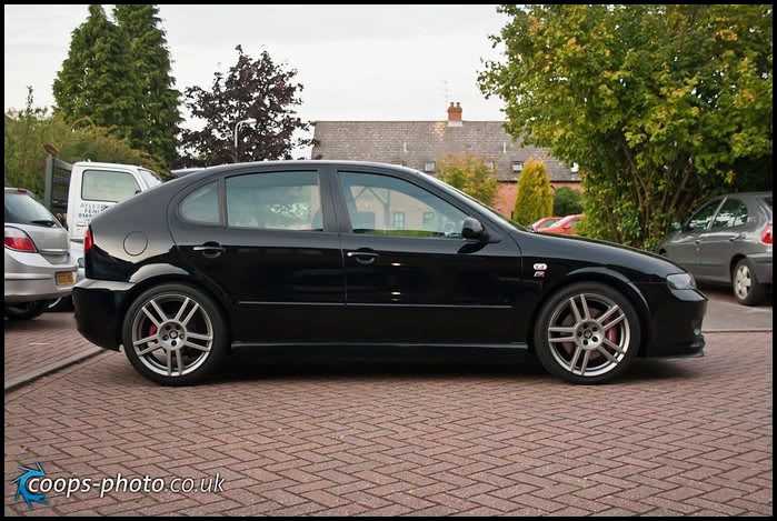

This is a before photo of how it was sitting. (Looks slightly lower at the back as it had the suspension kit and roll bar in there)
And this is after, slightly lower and a better stance. Still needs to settle a bit more too. Will get a better side on pic once it has.
Rear ARB and springs / dampers fitted, looking sexy :lol: (except for the missing cover, new one on order from David @ Sere Motors)

As I said it still needs to settle a little bit more for me to be totally happy with it.
The car has been transformed though! Body roll is virtually non-existant now, it sticks to corners like glue, feels so stable and just so capable at anything I throw at it! The brand new tyres help too :)

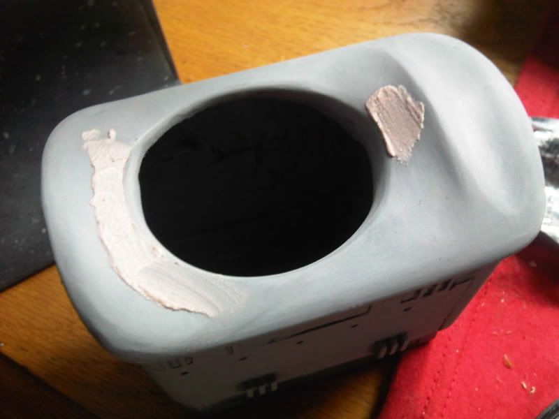

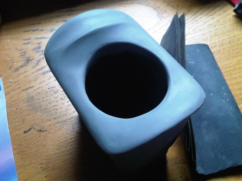

Decided to do a bit more work on the pod today.
Few more coats of primer then **** loads of sanding!
There were still a few bit marks so it was time to get the filler out again and fill those holes. This resulted in yet more sanding!
Got fed up of sanding and decided to give it a few thick coats of Halfords Satin Black Paint. It tooked pretty glossy to me at the stage I left it, hopefully it will dry more 'satin' like.

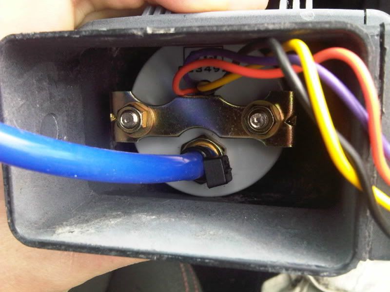

Got totally bored of the sanding so decided it was time to fit the damm thing! Its not perfect but will do for now until I decide what I'm going to wrap it in.
An old (non-smelly :lol: ) sock blocks the vent nicely
Gauge was secured at the back with the bracket provided. Boost hose secured tightly with a cable tie.
