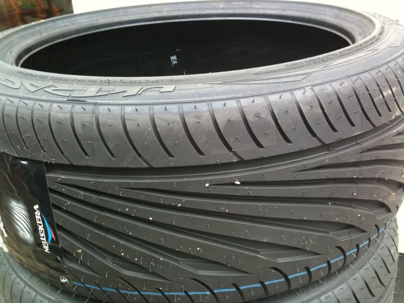

I ordered 4x VREDESTEIN ULTRAC SESSANTA - 225/40R18 tyres from Camskill for an excellent price. Fantastic service from the boys @ Camskill, super quick delivery too. Had them fitted by a local garage who lost two valve caps and didn't pump all the tyres up properly, all around 20psi. Wont be using them again!

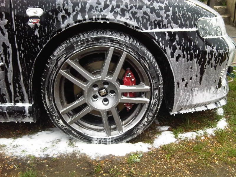

Mmmmmmm brand new rubber.....

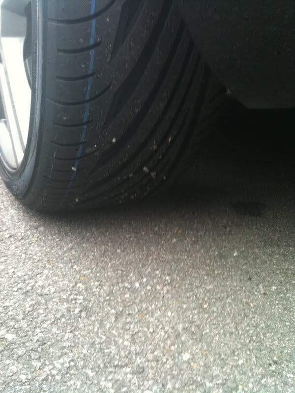

And fitted....
Only thing that bugs me is the tread pattern is reversed on the other side, so the V's go down instead of up. I asked the guys there if this was right and they showed me on the tyres it says "inside edge" on one side so thats the only way they can go
. Any one else with Vred's notice this?

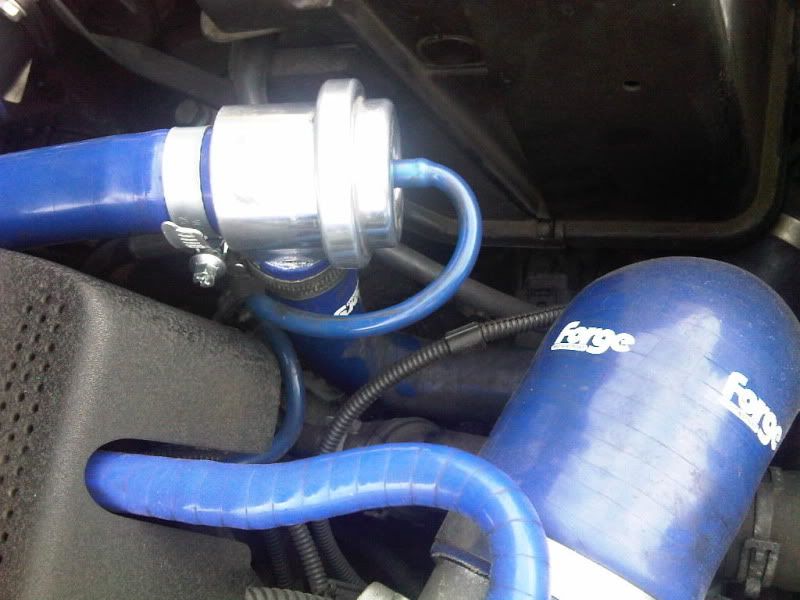

It made just a shade under 250bhp and 254 lb/ft torque. AMD boys said the 007p is on the wrong way and closed air filter is rubbish, coupled with a very hot day resulted in the low results. Pretty disappointing really.
