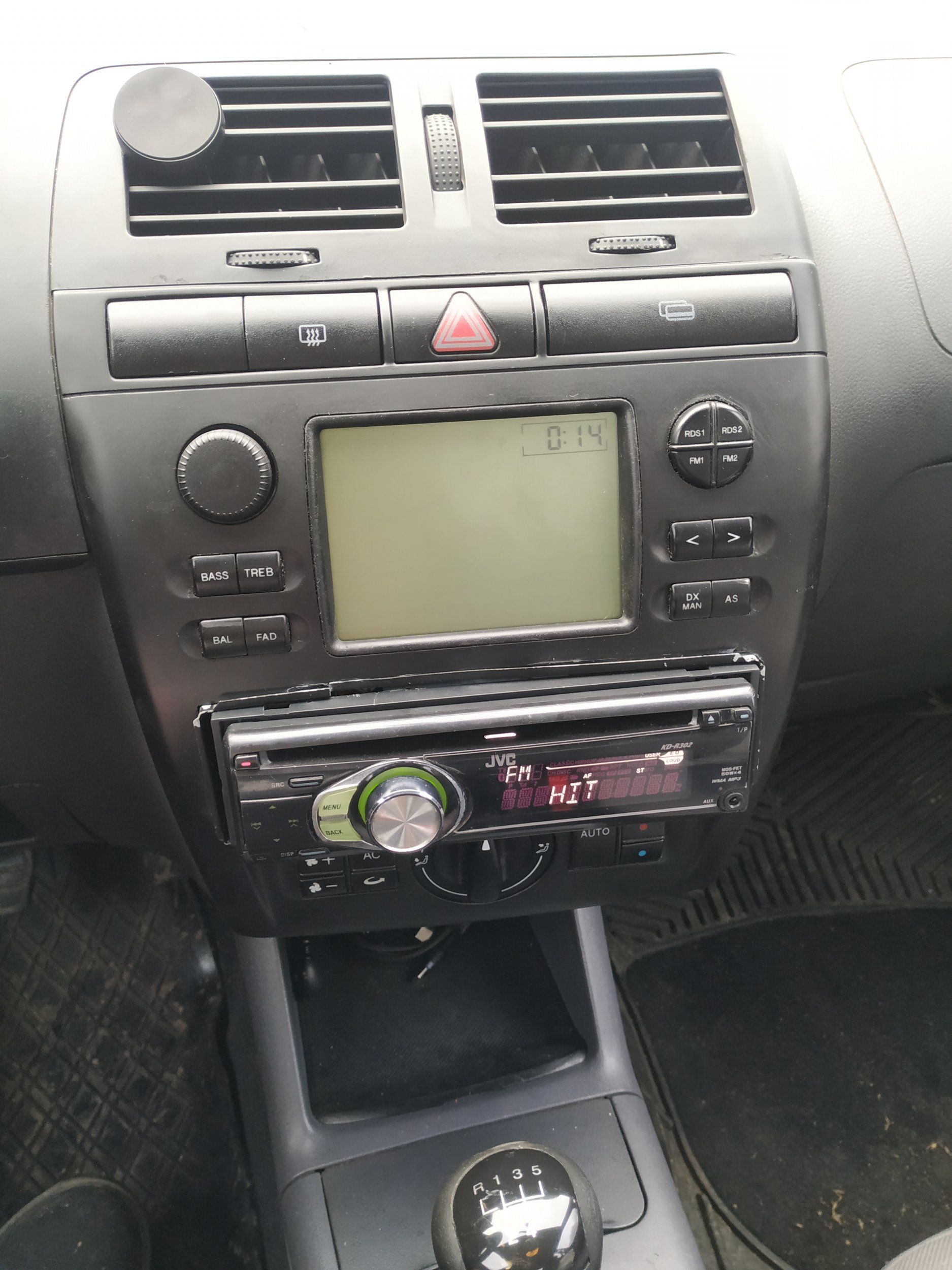

I was wondering if anyone can help me about modifying my Cordoba 6k2 stereo like the guy in photo? I was searching everywhere, i dont know if its an easy job or no but i reaaaaly need help:crash:
Maybe some wiring diagrams, literally any help would be appreciated.

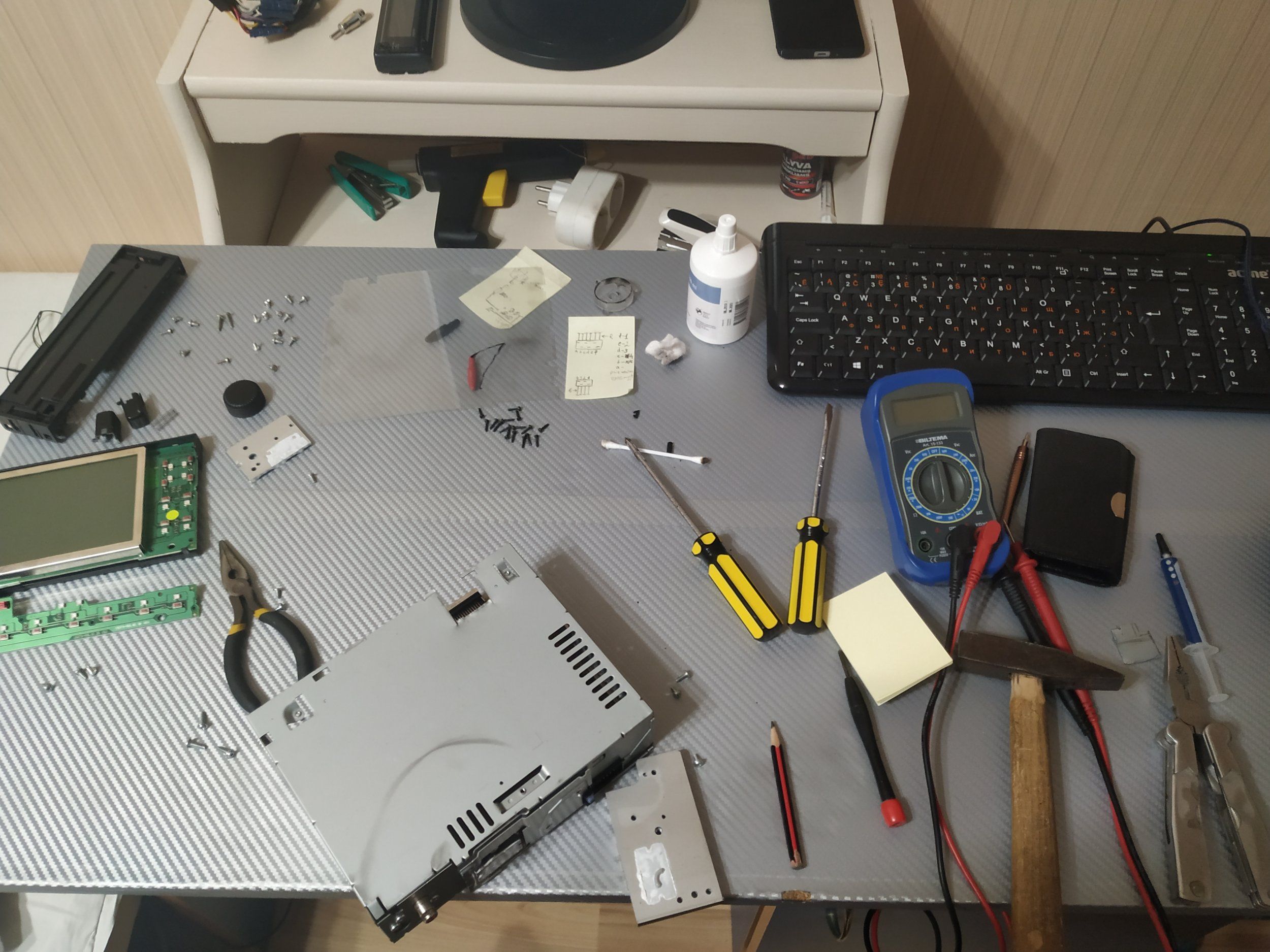

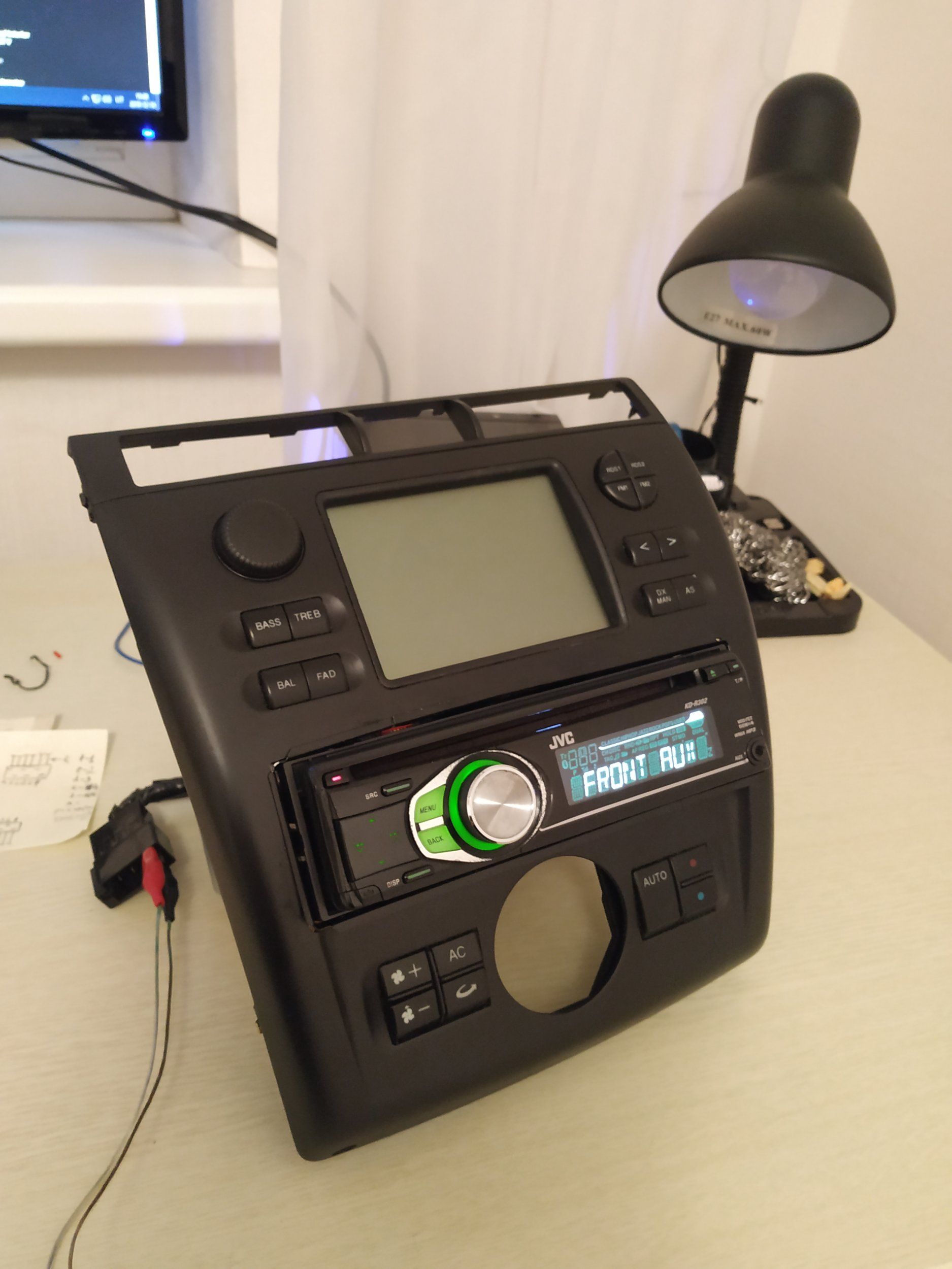

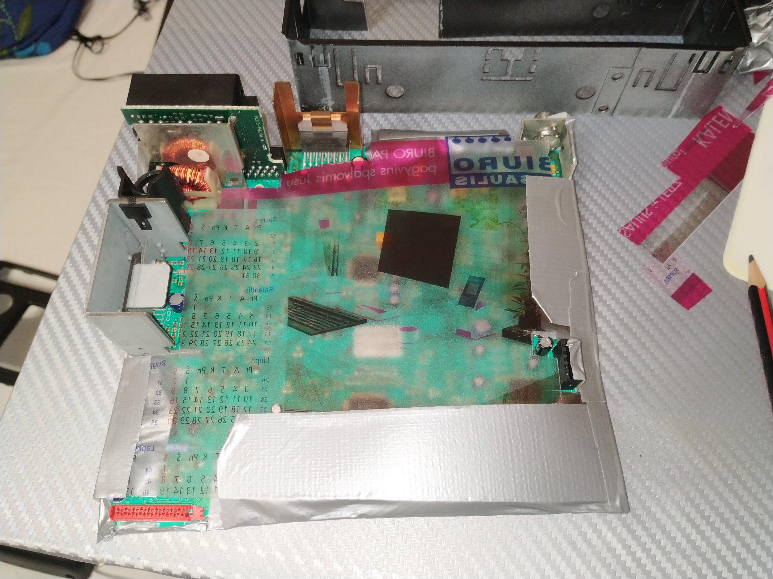

It is really quite complicated. Mainly because it is very tight fit. Also you have to modify new radio (cut hole in top). If you still want to do it, I would suggest some players without CD player, because they are shorter and will fit better. If it has CD player, it will have to be removed. For me, at first attempt AC bottom buttons wasn't working, because ribbon wire was pinched on side. Eventhough I am electronics engineering student, this was quite tough as I didn't have any information on how it should be done. This is the video that I followed:
