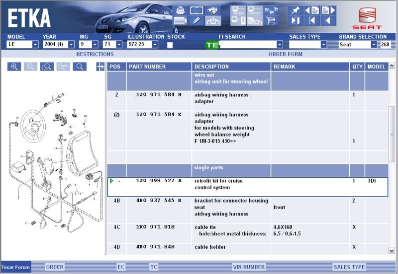

1J0 998 527 A £48.40+vat no stock
what else would I need
Mines a TDI
A wiring loom
ETKA lists 1J0 998 527 A as a kit
