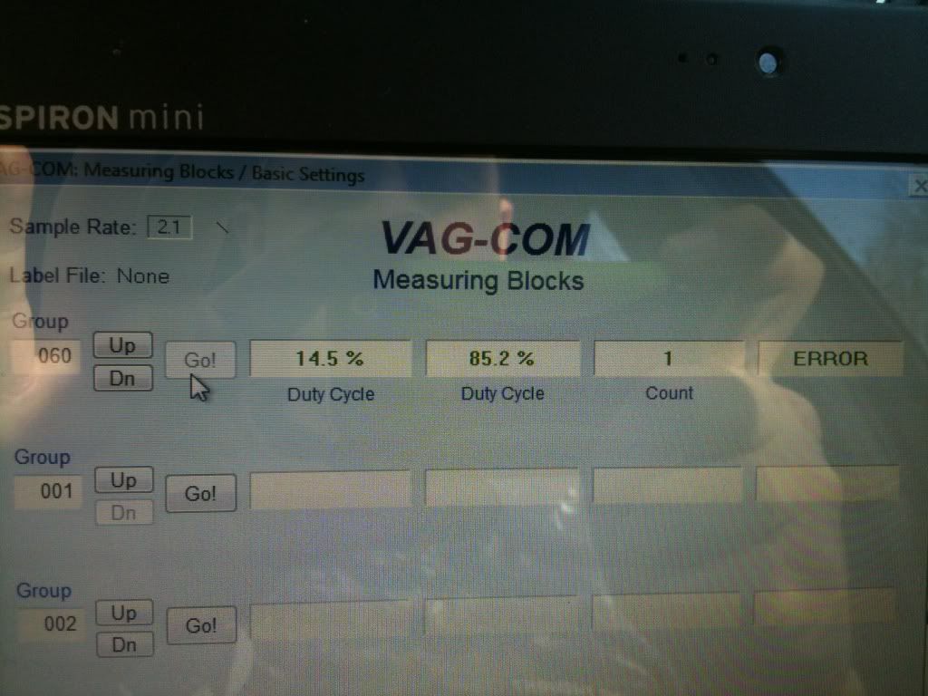

Im doing a TBA now with that guide but its sayin error in the top right box with these codes
VAG-COM Version: Release 311.2-N
Control Module Part Number: 1ML 906 032 A
Component and/or Version: 1.8l R4/5VT 0001
Software Coding: 10510
Work Shop Code: WSC 77875
Additional Info: VSSZZZ1MZ3R056288 SEZ7Z0B1737303
5 Faults Found:
17987 - Throttle Actuator (J338): Adaptation Not Started
P1579 - 35-00 - -
17695 - Boost Pressure Control Valve (N249): Open Circuit
P1287 - 35-00 - -
17748 - Camshaft Position Sensor (G40) / Engine Speed Sensor (G28): Incor. Correlation
P1340 - 35-00 - -
17951 - Angle Sensor 1 for Throttle Actuator (G187): Signal too Small
P1543 - 35-00 - -
17580 - Angle Sensor 2 for Throttle Actuator (G188) Signal too Low
P1172 - 35-00 - -
Had a awesome Day today Managed to sort all the Hosing and vac piping out,Renew all my Clamps and clips And re done my exhaust and it no long has a slight Hiss coming from it :D Result...
Also big thanks to chris whitworth for todays antics:D Was a massive help he got my TB all Done TBA and it idles a real Treat :D....slight cough 3-4 secs after starting it then its fine...
Just These 2 codes to sort now and its all done..
P1287 - 35-00 - -
P1340 - 35-00 - -
